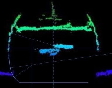

Great to hear you maybe found some additional data, all is welcome. I do have one sonar scan image that was posted online and on which I based my center frame reconstruction, it is also posted in my blog. It seems to be at the main cargo hatch as you see a reflection of the tweendeck and also of the main mast.
The book is a good tip and I ordered it directly.
