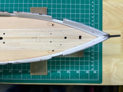

Post 42 - Hit the Decks, Part I
I made up my test swatches of 1/16" and 5/64" planking strips, and decided that the 1/16" strips, although the correct scale, looked too skinny and would be a nightmare to work with. I am using extremely thin (0.02" - that's 1/50") strips so I don't throw off the geometry of the guns in the gun ports. I bought them from Northeastern Scale Lumber. My initial thought was to plank the two halves of the deck off the model, but in making the swatches I realized how much the PVA glue caused the thin wood to bend. I decided it was better to have the deck (now my sub-deck) glued to the hull. I used Elmer's Glue to do this instead of Titebond, so I'd have time to make adjustments and get the two halves centered.
As they dried I made up some more test swatches to test colors. I had used a wash of Deco Arts 'Fawn' on my Lobster Smack model, so I tried that at two strengths, along with a trial of amber scellac
My idea is to present the Harriet Lane as she was when launched, a sort of Platonic Ideal of Harriet Laneness, so no deck weathering. I'm not sure any of them are right, but I think the Fawn wash in the appropriate dilution might be the answer. The shellac is too yellow.
I should mention that this is my first attempt at planking a deck. I used Toni Levine's monograph as a guide. I first made a tracing of the deck and the outlines of the various holes and deck furniture on tracing paper so I'd know where to cut as well as glue things after I planked the deck.
I then outlined the deck pieces on paper and drew in the king planks (I have 1/8 strips for that) and the other planking rows. I superimposed the deck structures on this.
In retrospect, this probably wasn't necessary - the 1:96 scale is so small it got very confusing drawing in the butt lines. It did show me I needed 22 rows of planks on each side of the king plank, however.
As I overthought this, I kept thinking about how to know where to start the 2-4-1-3 butt shift pattern - do I do it randomly, or is there a preferred starting point? I hit upon the idea of superimposing a grid of the butt shift pattern on the decks. I used different colored inks for the different lines.
I shifted it back and forth until I found a spot that gave me the least amount of very short planks between deck structures. That meant starting with the end of a full length plank at the tip of the bow. Based on that, I knew where the butt shifts happened, so I didn't need a complete template. I marked the deck with lines every three inches as a guide, and marked the start of the 2-4-1-3 butt-shift pattern midships.
I made a simple jig to cut 3" lengths of the wood strips, using a chisel blade for the cut.
I cut 104 of them today, in about 1 hour. The hardest part was darkening the sides. They are so thin that they are very flexible. I figured out that doing 8 at a time (what I get from a 24" wood strip) worked the best. After stacking 8 pieces I held them with a clamp on one end and my fingers on the other while I used a pencil to darken the sides.
I then glued on the king plank. I did this as two large runs, separated at the cut out for the funnel.
IMG_6458.jpegAfter that I added the next two rows of planks on either side and cleaned out the openings.
My memory of build logs on the old MSW is that the skylights and companionways are not as big as the outlines on the deck. I will plank over the outlines, but marked the center of each structure as a guide for when I attach them.
As you can see, there is one butt just aft of the deck house (which will be covered by the stairs) and there is another between the fore mast and the deck house. I will need one more row on each side to cover the companionways and skylight, , and then I will add the wider binding planks. These will be the start of the real butt-shift pattern.
The model calls for a 1/32" x 1/32" strip to be glued at the angle of the deck and spirketting to represent the waterway. I therefore not plank a waterway, and threrefore not try to nib the ends of the planks.
I used PVA glue, as that gave me more time to situate planks. I calculated I will need around 650, so I will be chopping, blackening and gluing for a while.
Overall I'm very pleased and excited by how the deck is turning out. Toni Levine's "How to Plank Your Ship's Deck" was a great help, although the scale and my skills are not large enough to do her method justice.

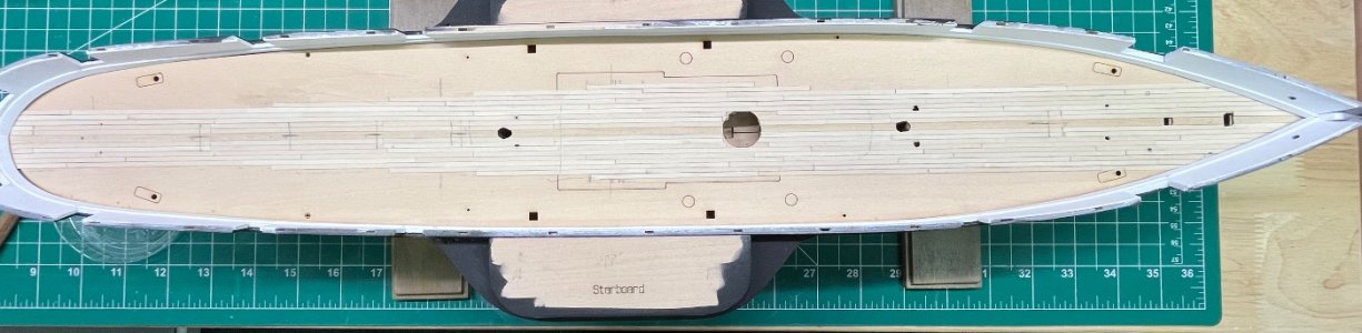

Post 43 - Hit the Decks, Part II
Reposting this as it somehow got embeddedd in the prior post.
Over the past two days I glued a total of 104 planks. I finished the middle of the hull where most of the holes and structures are, and started to move sideways and forward. I only roughly cut the holes as I don't know how big the pieces that fit there will be.
I made up another 120 planks yesterday. I may need that many again to finish. After a short break today to have my appendix outRedface I hope to be back at it tomorrow.
