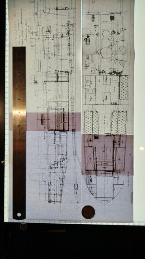

So everything is copied and these are fitting in scale to 1/48 and to each other. I didn't got a scale gauge with the frames so I looked on top of the light tablet for the spacing of the water lines.
For better detailing I enlarged one set of drawings of sideview/WLplan by 150% up to 1/32 - I ever become as made as to build her in this amazing scale:
Tbc
Сестрорецк [Sestroretsk] from 1894 has been upscaled to 1/32
to redraw the old plan from ink on linen fabric in a propper way. Let's start finding the details.
The other copies in 1/48 are ready for glueing on cardboard (trying spray glue for a dry contact) and cutting out:
So building will start in 1/48 this evening...

Irritation -
the lines drawings were SEVEN MILLIMETERS shorter than the other drawings in the very same scale.
So I decided to cut the plan into two parts at the less to beavel part surrounding the engine room.
So this problem ist"fixed"

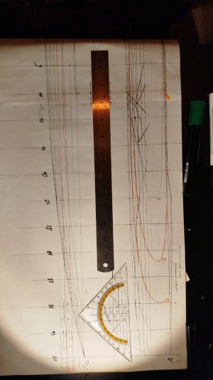

Today there were good and unnice results with the water lines drawings:
...and the result was terrorising because the hole CL wasn't straight at all :eek:
...so I decided to redraw the lines drawings and prepared all needed materials for tomorrow - and put alongsite the CL.
Good results were made at the CL onto two sheets of DIN A3 papers - there it all fits in (but not in the copyshop due to the framing around).
All the formers are cut out - and so I can add all the waterlines in the WLdrawing. So tomorrow I have to Work with my big taylor's rulerset.
Today the waterline drawing have to be
"repaired" here my way to deal with this huge Problem:
I.
Due to get a correct result I have started to put the bulkheads cutouts onto the yesterday drawn centerline (CL)
and punched thought the copied bulkhead's line with a fine cutter's tip - so getting a precise point to run the waterline onto - hopefully...
II.
So to avoid any sinister inconsistancies I only
set the portsided dots and so I have an easier time.
III.
When all the portside dots are placed than I will take a pair of compasses to mirrow them ontop towards the starboard side.
