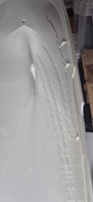

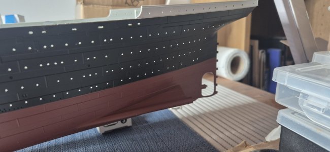

This is a very labour intensive job. I am presently cutting and “dry fitting” clear acrylic rod into all the portholes.
Once fitted they all need to be recessed into the hull to correct depth and glued.
I hope I am still sane when completed.20251023_223054.jpg20251023_223146.jpg

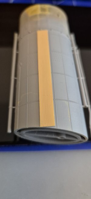

I recently came across Naples Yellow acrylic paint, which is made by Winsor & Newton and you can airbrush it.
So far it’s the closest colour I have found for the funnels on the 1/200 trumpeter Titanic.

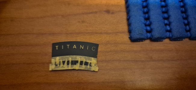

I have painted the name on the MiniBrass stern plate.
The masking is the time consuming part of the job, but quite pleased with how the name came out, I still have to do the name plates that go on the bow.
