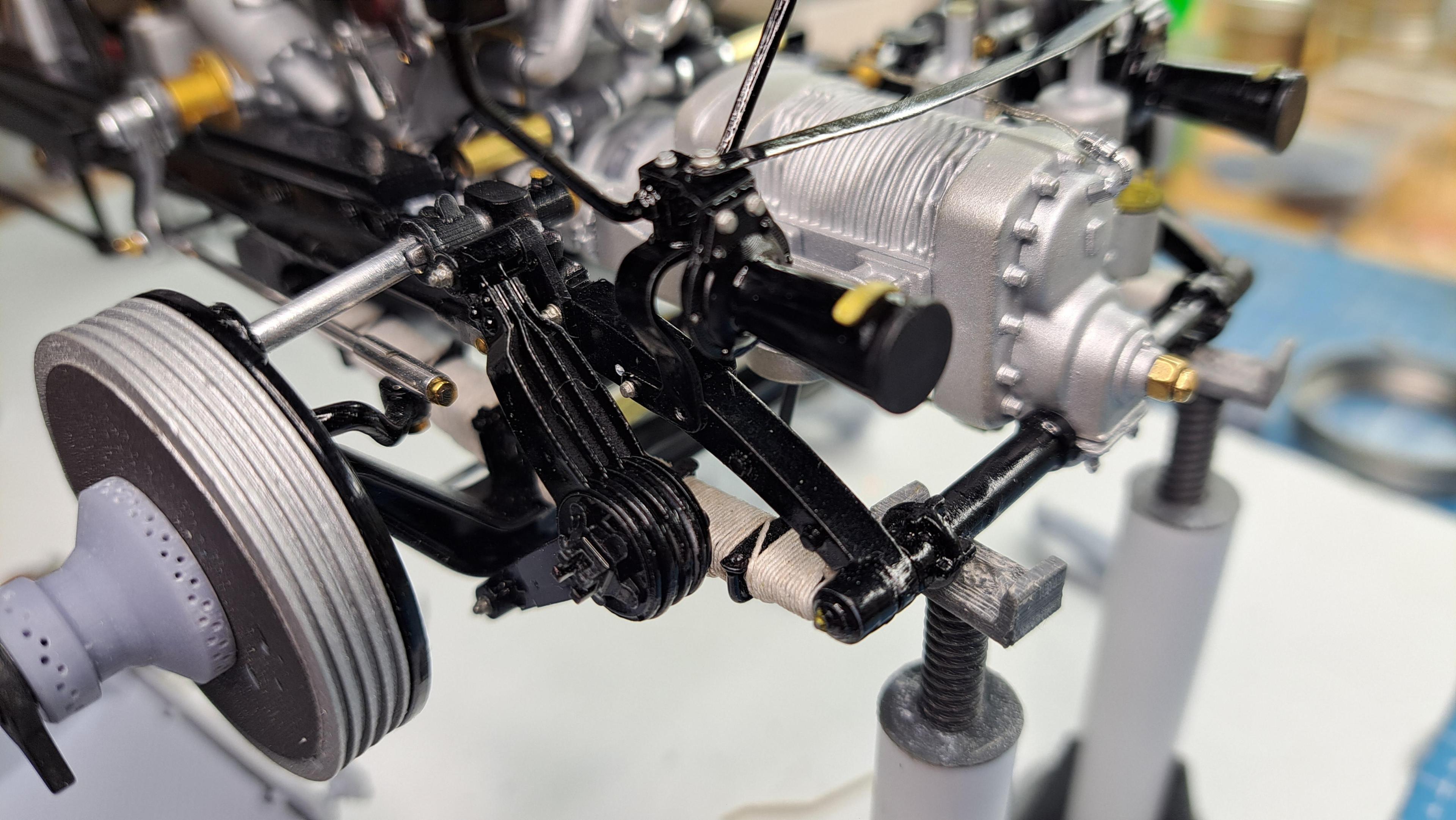

I also assembled the carburators (all 3d printed on my new resin printer) and installed them on the blower which is now connected to the engine. I just need to make the 2 brass fuel lines that go from the carbs to the fuel hoses and to add a oil feed line to the front of the blower and it will be complete. Next on the list will be to model and print proper looking lever shocks.
Here are some pictures of the carbs and blower.

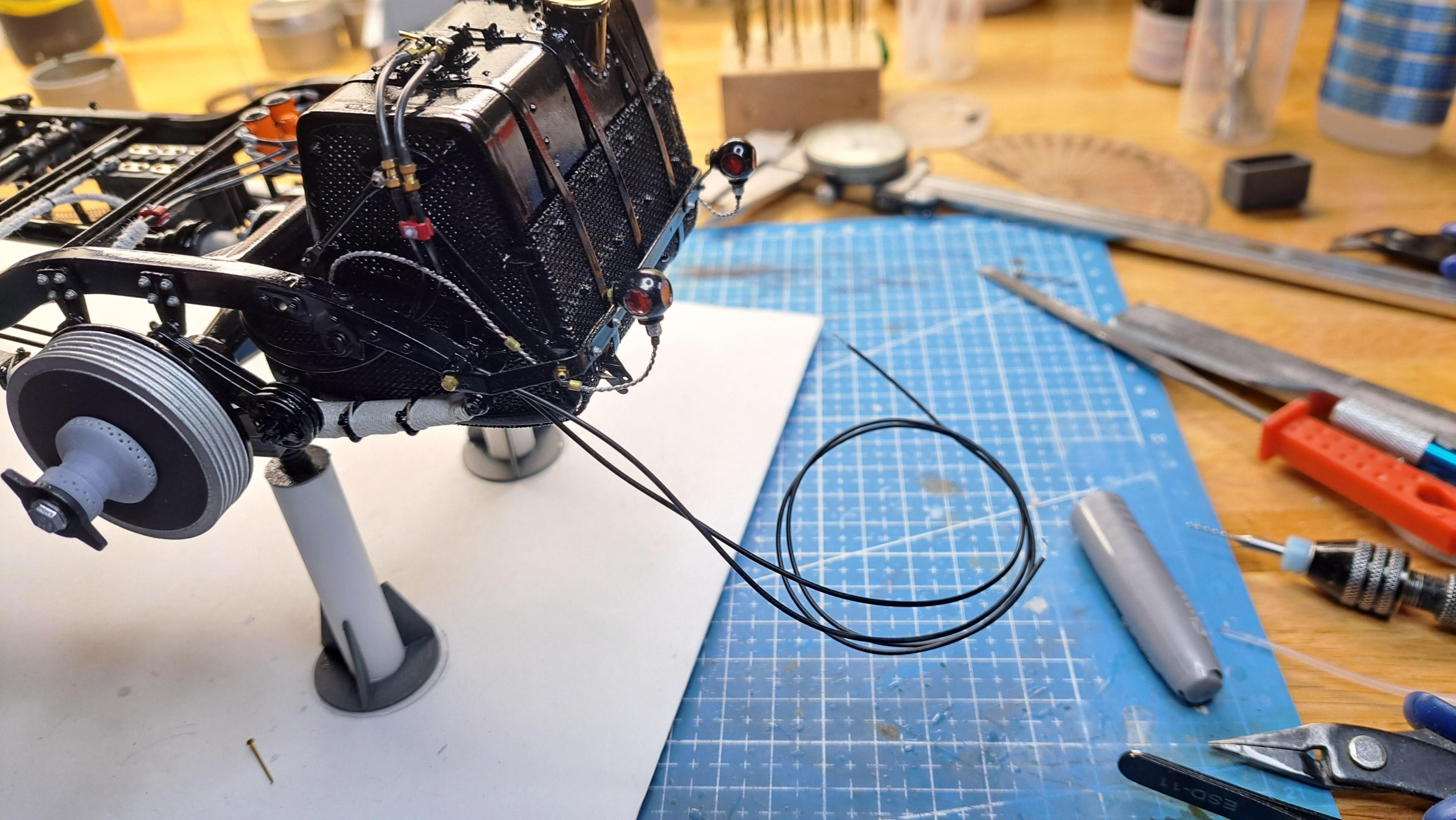

The shock absorber being done, my next task will be to run some micro gage wires from the head lights and gearmotor/starter all the way to the back of the car and eventually out of the still to be determined showcase and into a, also to be determined, electrical cabinet where there will be batteries and switchs to activate the head lights and the engine.

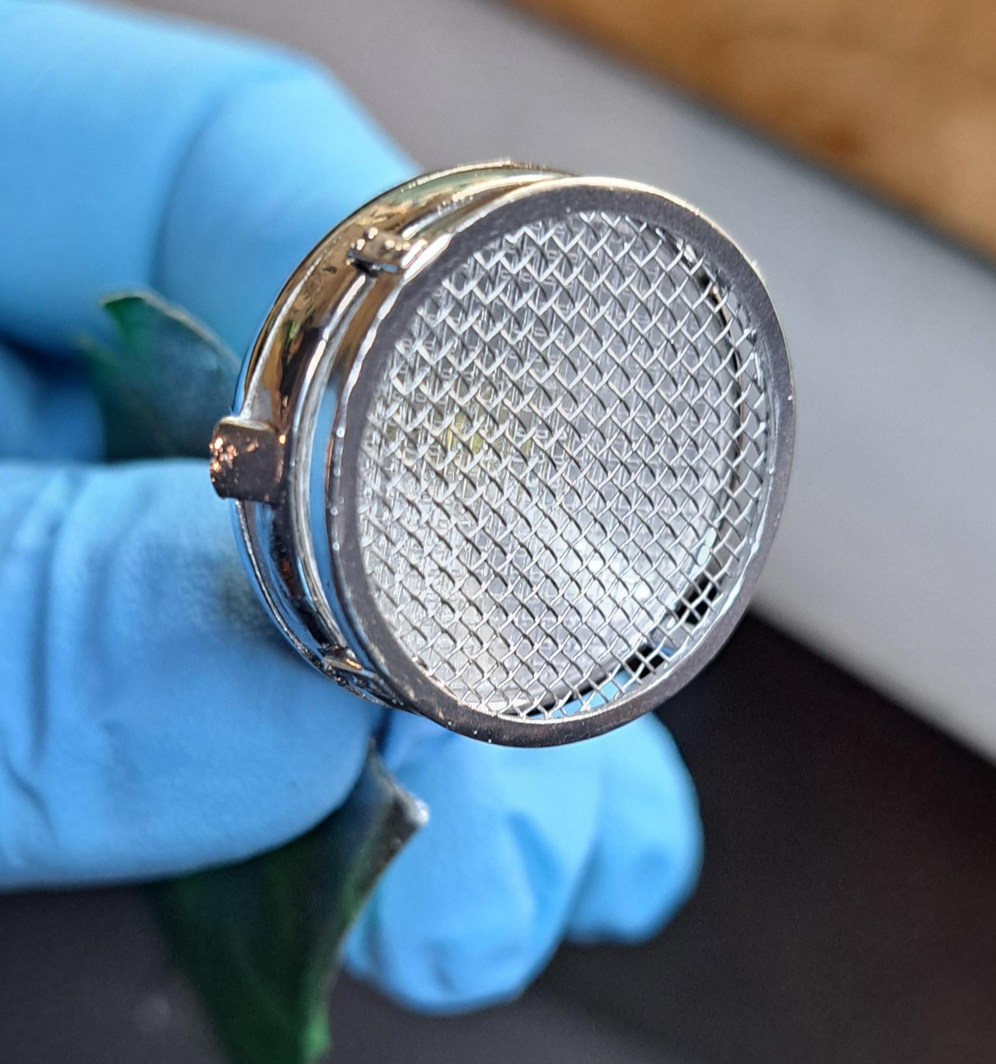

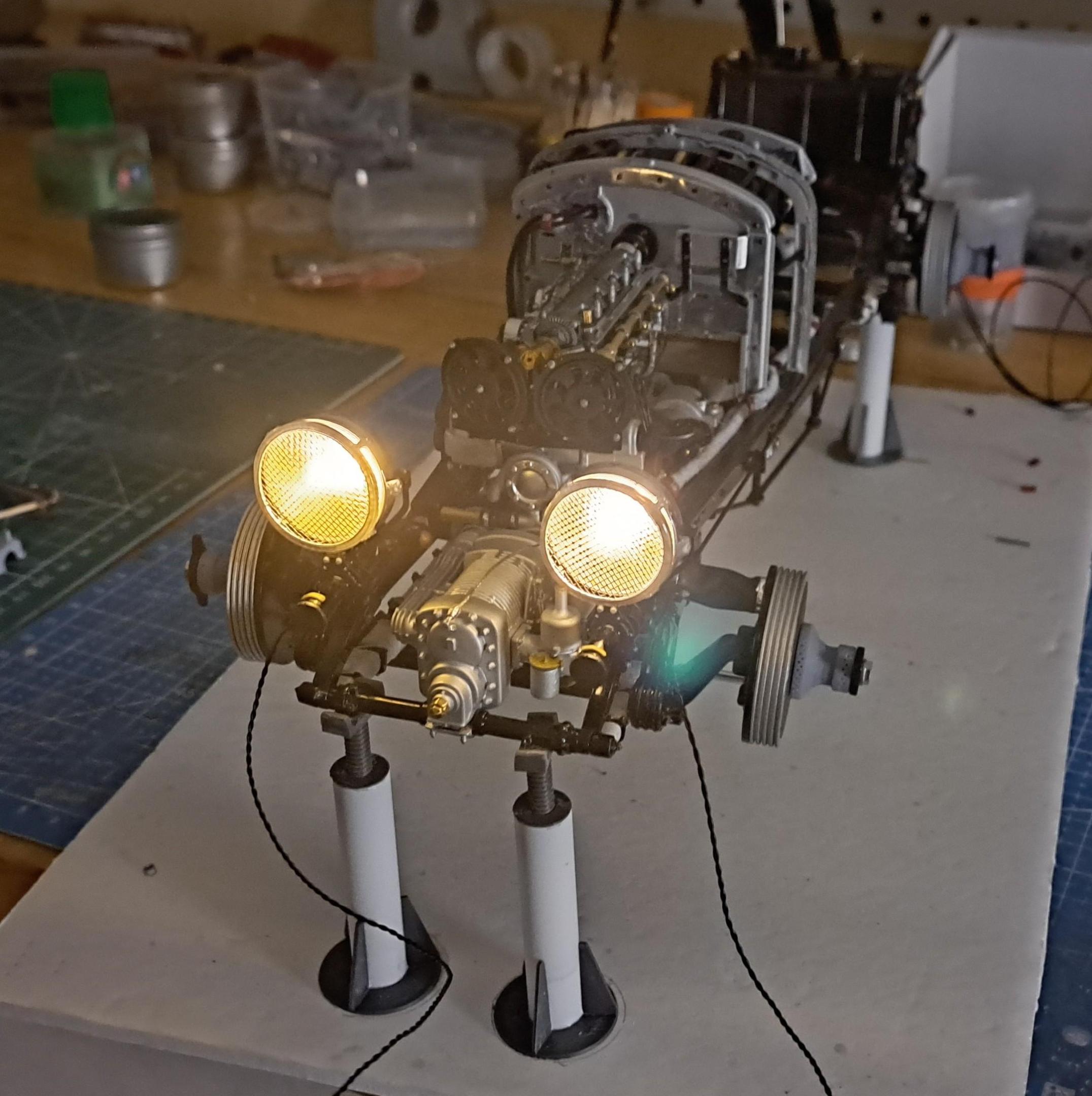

I wired the head lights today and they work. Just need to chrome them up. I also 3d modeled the grill rim as the one furnished in the kit is not really nice. I know that many modelers will cut away the center portion of the grill and add a real mesh. And I might end up doing just that but I'll try printing some more accurate rims first.
I have a proper size wire mesh that has a .04" aperture that gives me about 20 squares which is about right and a .005" wire that scaled up is 1/16", also correct.
Wired head lights
Test fitted on car
Lights on

For those of you who are unfamiliar with the 3d resin printing process like I was, I thought it could be interesting to show the different steps requiered to print a part .
1- decide what to print. In this exemple, I wanted to improve the head light protection grill from this
To this
2- 3d model the part
3- load the model in a slicer application. A slicer will literally slice the part in a multitude of layers. The number of layers depent on 2 things, the height of each layer, in this case it's 50 microns (.05mm) and the total height of the print. The taller the print, the more layers will be requiered and the longer the print will take. That's what fun with this process, the printing time is not dictated by the surface area being printed so a single small part of say 3mm height and 10mm square area will take as much time as 'X' of the same part as long as they fit on the printing plate. Now, this is where the game is won or lost. You have to give the proper orientation to the part so as to not have too much surface area being printed on each layer while taking care of the esthetics. You want to avoid supporting the part on visible surfaces because the anchor point will show a bit (or alot depending on their size and number). In this case, I wasn't able to avoid this but fixed the problem later on. Once oriented, you then add supports. The idea is to support the part at strategic point as it's being printed, avoiding overhangs.
View attachment 20231229_071358.mp4
4- load in printer and print
5- wash part in washing station. I use a water wash resin so cleaning is done with water. Most resin will requier cleaning with alcool
6- remove part from support structure by diping in boulingrin water for 2 to 3 seconds. This is not always necessary but will make separation alot easier.
Before boiling
After 2 sec dip
7- Cure in curing station. Most small parts will cure in 2 minutes. The longest I cured à part was 5 minutes. (The washing and curing uses the same machine, at least mine does)
After curing ( notice the bumpy top surface)
8- part finishing. Here you have to remove any anchor points that will be visible with either a blade, snippers or sand paper. I this case, not being able to support the part on a non visible surface ( I tried 5 different orientations but only one worked, I'm sure that someone with more experience could have achieved this), I printed a sanding tool since this part is very fragile.
Sanding tool
And after sanding
All that is left to do is to install the wire mesh
and chrome.
So that's it, hope you enjoyed this!!

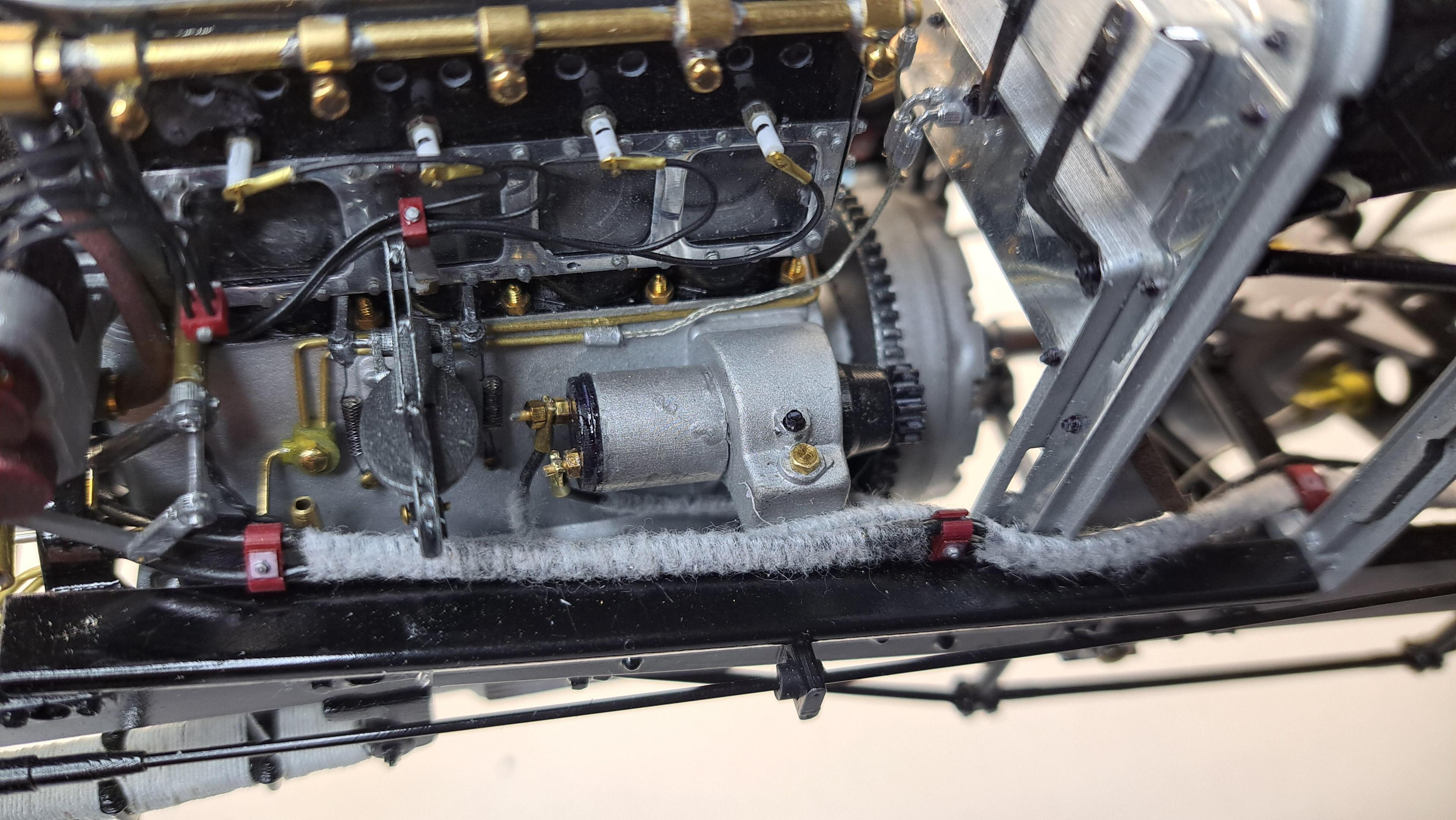

I had a moderate set back with the gearmotor that is supposed to run the drive train. While connecting the wires to the motor, the leads broke from the motor, too close to the end plate to be repaireble.
Fortunately, when I ordered the gearmotor, I ordered 2. One high ratio ( the one that broke) and one slightly lower ratio. So I very carefully removed the rear housing covering the back end of the motor and the spur gear and was then able to remove the broken gearmotor. I then redid the terminals in a more sturdy way on the new motor.
I had to reprint a new rear housing and spur gear and after a few hours of coaxing, was able to refit the new motor and complet the wiring.

I then set out to assemble and dry fit the newly chromed head lights. Very very happy with the result !!
