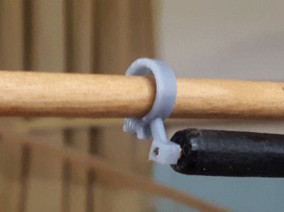

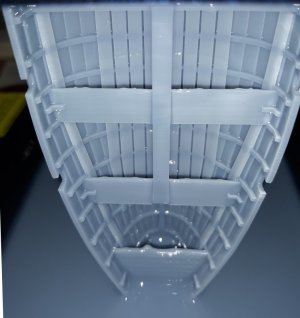

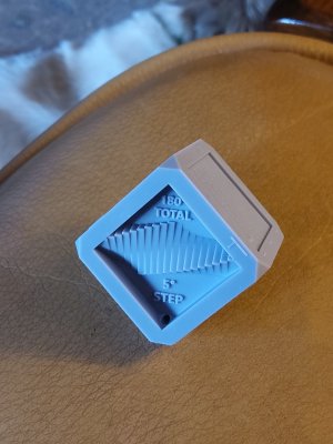

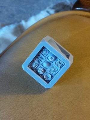

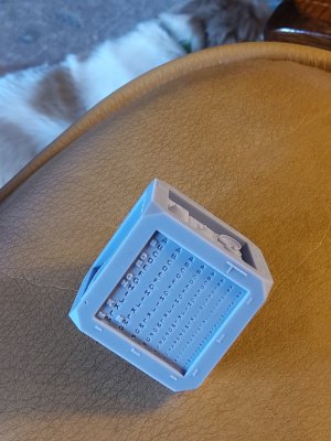

Resolution is something to consider....20240812_082412.jpg20240812_082447.jpg20240812_082425.jpg20240812_082419.jpg

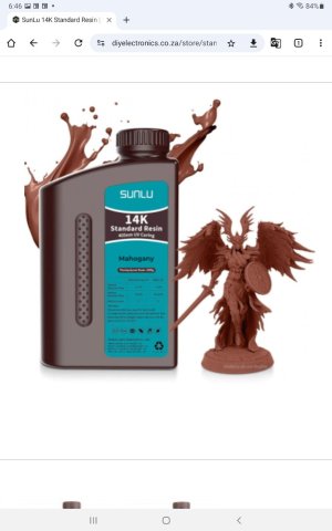

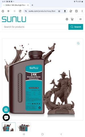

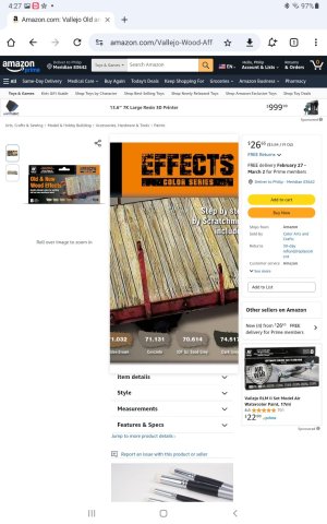

Have a look at red clay versions. Painting will still have to be done. Screenshot_20250218-162420_Chrome.jpgScreenshot_20250218-162731_Chrome.jpg
Unless the requirement is for clear resin, color is irrelevant, since the resin parts still have to be primed, then painted.

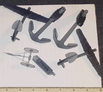

I use Siraya Tech Build resin because on RC models I need stronger parts. Cannon barrels I printed with the Elegoo Standard resin warped and cracked like drying mud after a few months just sitting on a bookshelf while the ones I bought before I had the printer were, and are fine.
My models are radio-controlled and will be outside, so the parts have to be primed, painted, and coated to protect from UV as much as possible, the resin's color is meaningless.
I've tried other resins such as ABS-like, all were too weak to even just sit without beginning to droop and crack over time.

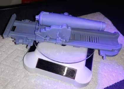

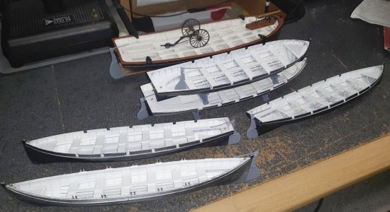

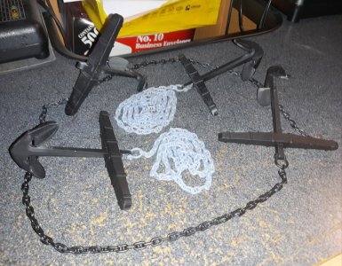

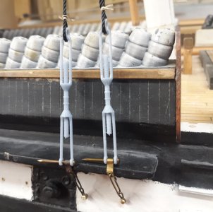

The anchors and boat-howitzer are printed in Siraya Tech Build Smokey Black which is somewhat transparent. The studded anchor chain was printed-in-place with Siraya Tech Build Sonic Gray
The pivot-gun was print in one piece, though I no longer do that with my guns anymore

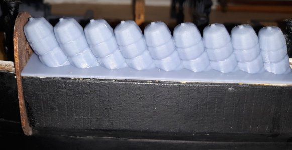

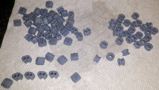

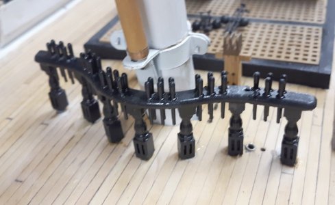

They aren't works of art by any measure, but the hammocks are hollowed and the trays are open to save resin. They've been epoxied to the tops of the hammock-rails/bulkheads for a couple of years now in my shop with no heat or A/C with no signs of cracking, coming loose, or deforming.

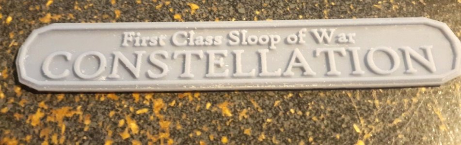

My intention when I got into 3D printing was making non-structural parts such as guns, crew figures, figure-heads, decorations, capstans, gratings, etc; but I found this resin to be strong enough for working parts like; bullseye, blocks, stuns'l irons, pin-rails, even turnbuckles.
It's not indestructible, it is basically plastic, after-all, but it's given my models details I can't manage with old, fat fingers.
con20220528b.jpg con20220620e.jpg con20240102b.jpg con20240117c.jpg con20241214.jpg con20231018c.jpg con20220325a.jpg con20220524d.jpg
(Everything was printed on Elegoo Mars, and Mars 3 printers)
