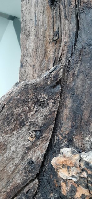

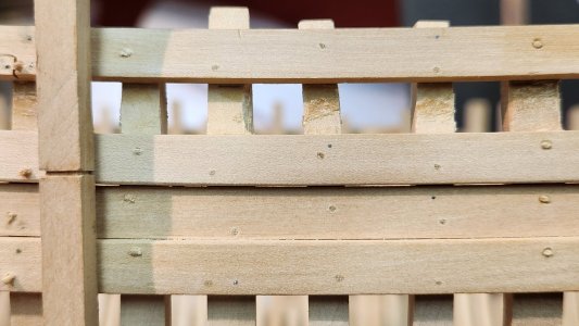

In the mean time on the ship I am investigating the use of nails and treenails to attach the planks, this to create a correct fitting of the planks.
To give you an idea of a common plank on the Samuel.

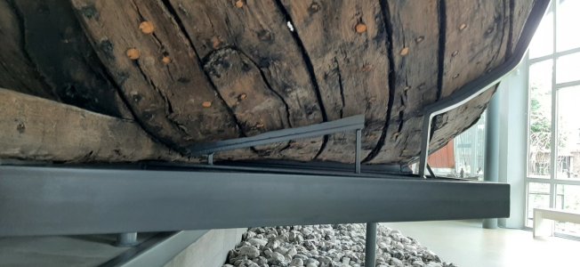

On the Husum wreck of a dutch coaster you see also nails at the plank joint ends.
All along the the stem keel and stern the planks were nailed.
I have the idea that planks were nailed in place just to fit them. After fitting they were finally fitted with treenails.
In the Samuel planking you see scattered nails at the planks and a rather neat pattern of treenails with two or three treenails per frame timber.
Treenails were fitted for the outer planking of the floor and later addtionally for the ceiling planking. For the sides "huiddigt" I am stil looking into this planking order of first fitting the ceiling or the huiddigt planks between the bilge and lower wale.

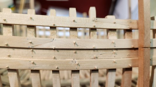

To give you an idea how it looks on the model.

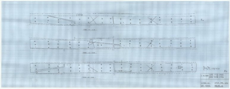

View attachment 517519View attachment 517520View attachment 517521
View attachment 517522View attachment 517523
More on that later.
Nice treenailing, Maarten.

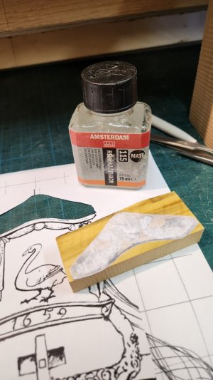

While treenailing progresses,
And also investigating the order of planking which is influencing the treenail patterns I have prepared a new carving to take on my summer holiday traveling workshop.

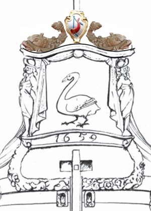

The carving I will start is the tafferel or in Dutch "het doorluchtig hakkebord"
This tafferel carving is not documented by the rov during the several dives at the wreck. Niklas Ericsson had drawn some type of acantus leaves on his artist impression of the ship.
I prefer an often seen layout of Dolphins and for my ship with the emblem of the city of Hoorn.
The dolphins are 17th century barok statues and it will look something like this.
Via the print lacquer transfer methode I am transfering it to a piece of boxwood and when the lacquer is dry I can rub of the paper backing to release the print on the boxwood.
That is for next time.

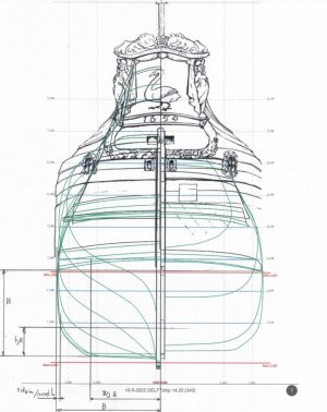

The stern top wale on the PS is removed. I have printed the sternview of my Delftship model and fitted inside to give you an idea of the approximate shape.
The sanding starts, beautiful weather so working in the garden. The PS side is roughly shaped.
On to the SB side, removing the stern top wale and the scheerstrook.
You can now clearly see the difference between the PS and SB side.
To determine the shape I decided to place some of the top timbers.
Again my delftship drawing came in helpfull.
The outward and inward radius of the stern top timber is the same as the radius of the center frame bilge. If I compare it to my centre frame template.

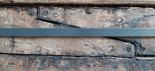

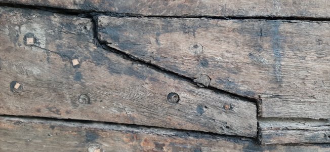

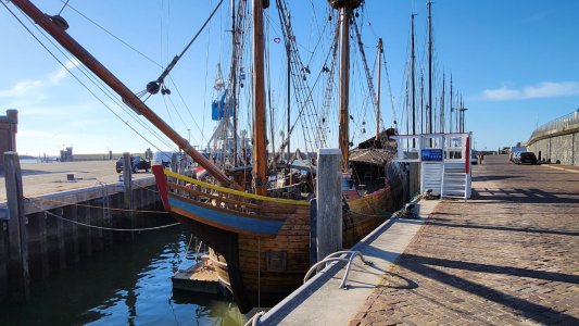

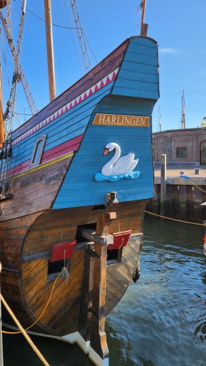

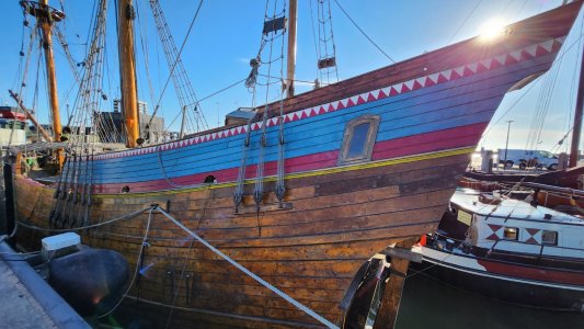

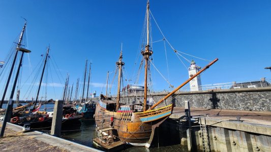

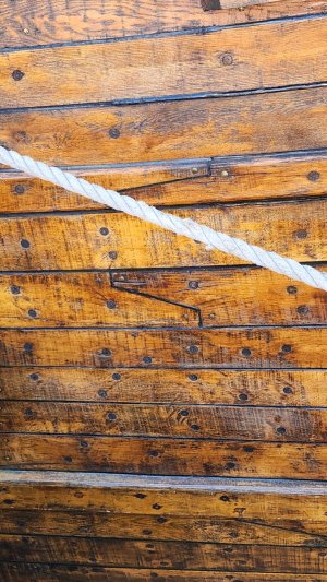

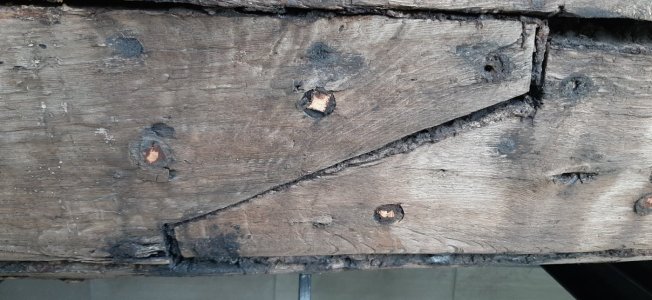

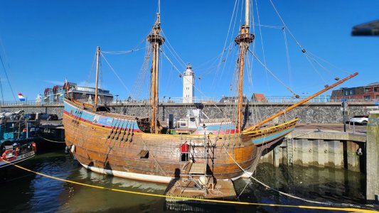

Today I was briefly in Harlingen and had a look at the "witte swaen". Made some detailed pictures of the planking and noticed they came to the same conclusion, similar nail tree nail combination.
See below some other pictures of her.
20250518_190142.jpg[/QUOTE]
So far, so good; the current evidence seems to converge to the usage of these nails as common practice.
It also makes sense; in order to retain some edge distance, one needs to use smaller diameter pins, the much larger treenails simply don't fit in these tight spots.
