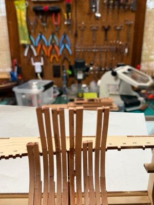

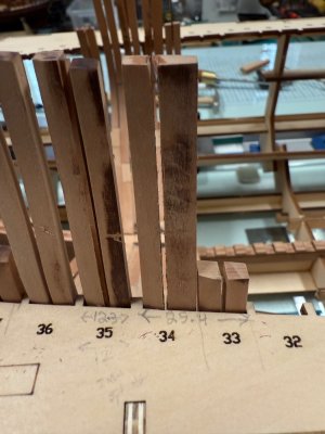

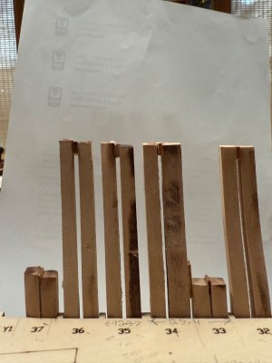

Just dry-fitted frame # 33 on to the keel. It is a gunport frame. The spacing between its upper futtocks is 1 mm, and it fits the jig spacing just right.
FYI:
Full frame jig spacing is 12.4 mm
Gunport jig spacing is 25.3 mm
Gunport side to side opening is 14.1 mm
Room and space is 27.75 mm
Starting frame 32 later this evening. Looks like I can finish one frame/day and start the next. Unfortunately, I won't be able to keep up that pace due to other stuff I have to do.
Thanks
Alex R

View attachment 515164View attachment 515165
FYI:
Thanks
Alex R

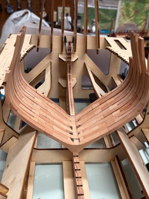

Finished frame # 32. Fitting well. I placed (lightly glued with a glue stick) 1mm and 2mm spacers at the ends of the top-timbers (and between upper futtocks in some frames) to keep the timbers aligned and spaced to dimension. So far, the frames fit right against the jig's slots without having to use a rubber band system to pull them laterally. May need to do so later.
Port (L) and Starboard (R) frames with 1 and 2 mm spacers.
On to frames 31 and 30 today.
Alex R
FYI:
Thanks
Alex R
