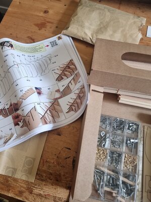

Стройка началась. Не самый сложный этап, но важный. Первое впечатление от набора. Отлично проработана фото инструкция, все пока хорошо стыкуется.

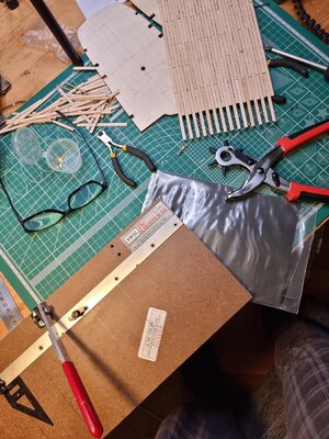

Но облагораживание иллюминаторов (их под 100 шт. с внутренним диаметром 2 мм) стеклянными вставками созрело, ищу шарики.

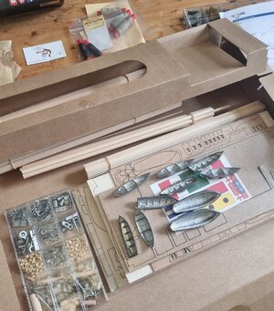

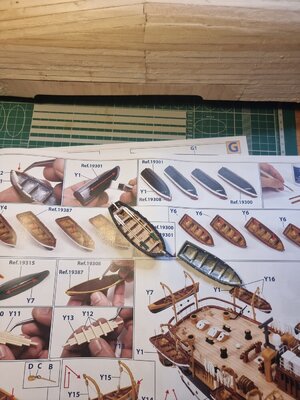

Удивило удивили металлические шлюпка, заказал для начала замену из дерева. Думаю удастся их приспособить для этой модели. Получу заказ покажу.
Construction has begun. Not the most difficult stage, but an important one. The first impression of the set. The photo instruction is perfectly worked out, everything fits together well so far.

But the improvement of portholes (they are under 100 pcs. with an inner diameter of 2 mm) glass inserts are ripe, I'm looking for balls.
I was surprised by the metal boat, I ordered a replacement made of wood to begin with. I think it will be possible to adapt them for this model. I'll get the order and show it.

I think that kit could be further improved by upgrading the chunky cast metal ships boats and other fittings with better aftermarket ones.
I completely agree with you. The decision on the boats has already been made by me, so far I have ordered five pieces - wooden ones.
I'm solving the issue of glazing portholes, I'll tell you about it when I get it.

I will follow your log with big interest - I agree with Brian about the white metal parts - I do not like them in principle and also special not here in this kit
Where did you find wooden boats in a similar scale of the Amerigo model kit?
I don't like metal parts in this set either. I found it on this Russian site, I attach the link, I will finalize them
The difference of 10 millimeters I think is not significant for boats carried overboard

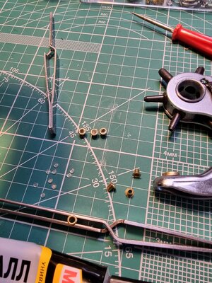

He developed the glazing of the portholes, the photo shows (in the center) a device and 4 ready-made portholes.

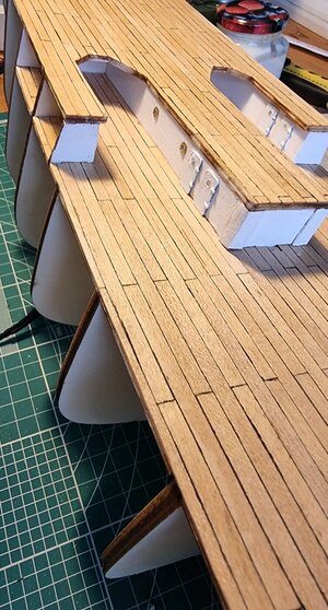

Routine work deck decoration is also visible
Разработал остекление иллюминаторов, на фото видно ( в центре) приспособление и 4 готовых иллюминатора.

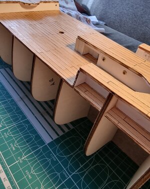

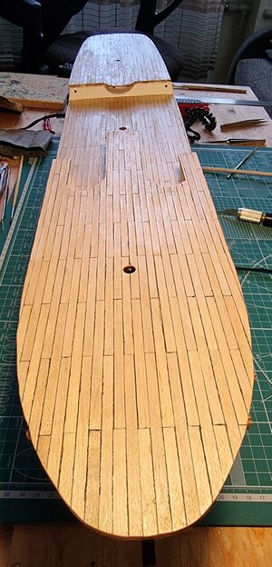

Неожиданно для меня, удалось сделать основные палубы. Почти все хорошо встало, только под грузом пришлось все подержать.
Unexpectedly for me, I managed to make the main decks. Almost everything got up well, but I had to hold everything under the load.

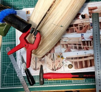

I finished the first layer of cladding, I haven't processed it yet.
Refused to mount the rails, as recommended by the manufacturer with nails. He says it is necessary to treat the surface until the "hat" from the carnation is worn off.
Excellent wood, the slats are processed well, but they are very brittle. Soaked in hot water for 15 minutes, this allowed bending and shaping.
Instead of nails, I use pins (and grandma's thimble, see the photo), buttons are also convenient, as in the photo.

Отличное дерево,хорошо рейки обрабатываются, но они очень ломкие. Вымачивал в горячей воде минут 15, это позволяло гнуть и придавать форму.
Вместо гвоздей использую булавки ( и бабушкин наперсток смотрите на фото) , также удобны кнопки, как на фото.

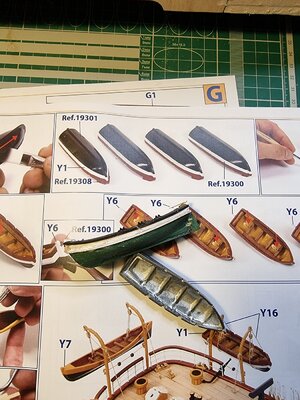

Couldn't resist. Postponed the cleaning of the primary skin of the model, almost finished.
Here is one of the boats made of wood- pear, you can compare what is offered. She's a little potbellied. I painted a little differently than recommended, but it's not scary there are 4 of them there. Do you think it's worth replacing?
Не смог удержаться. Отложил зачистку первичной обшивки модели, почти закончил.
Вот одна из шлюпок из дерева- груша, можно сравнить то что предлагается . Она немного пузатей. Покрасил немного не так как рекомендуется, но это не страшно их там таких 4 штуки. Как считаете стоит заменять?
P.S. I treated the surface and repainted the boat. It has become much better.

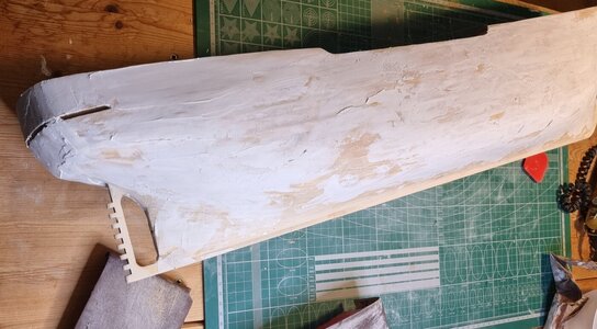

That's how the board turned out. It needs to be finalized. The glass pleases me, I will replace some.
It took a lot of time to finalize the case and draw lines. The process continues
