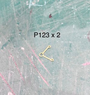

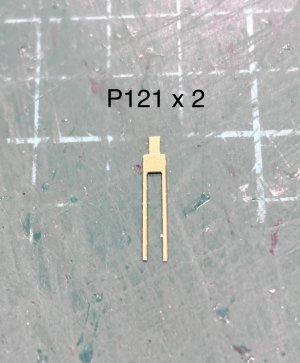

Really beautifully done, and yes, of course there were larger buckets and tubs. Some were made of wood, known as wash tubs, which were used to wash large quantities of vegetables or even meat... or even wash troughs, which people used to bathe in. As always, you've breathed new life into the building. By the way, I was able to reorder part P70 and AL has confirmed that the part has been sent to me. :D Thumbsup
Video #29 Update

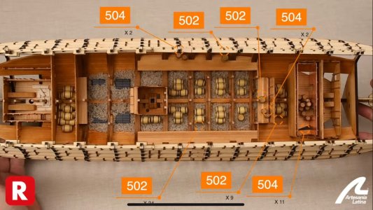

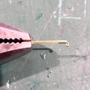

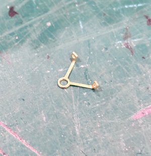

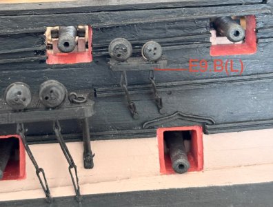

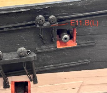

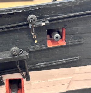

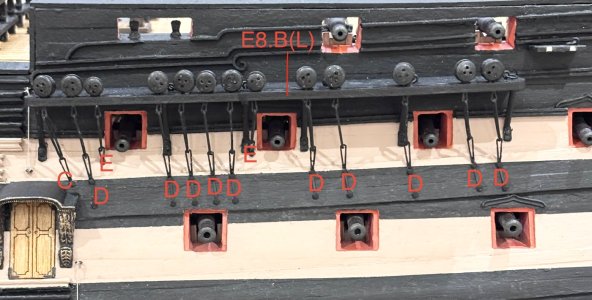

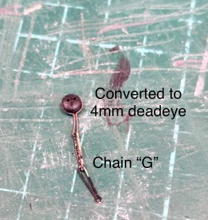

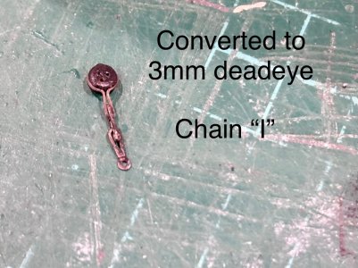

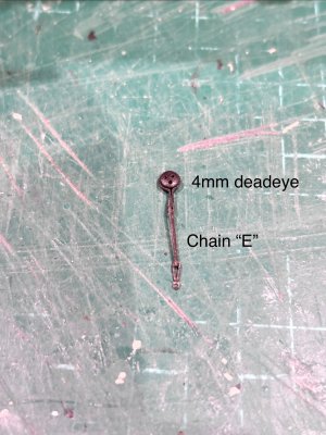

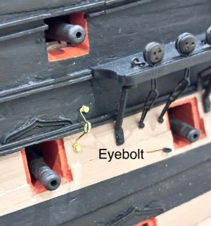

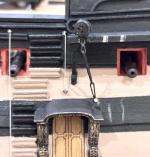

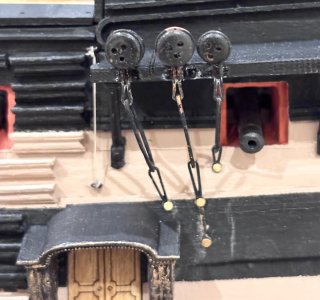

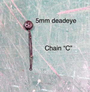

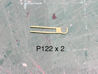

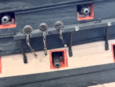

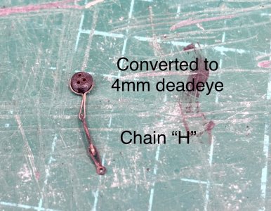

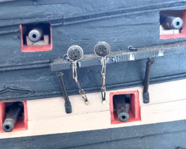

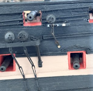

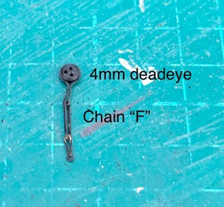

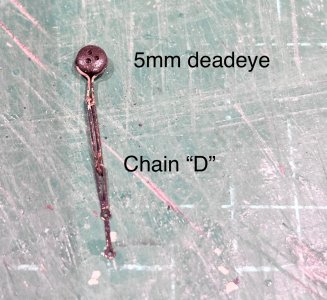

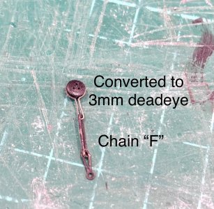

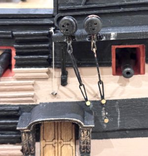

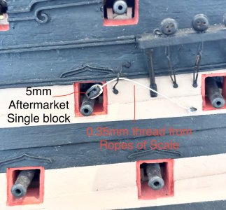

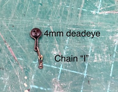

Part P70 arrived today so I fitted it as best I could. It has to be bent into an offset shape to go through the chain. None of this was shown in the video, just the part in position
I had to paint the lower part before fitting as it passed behind a brass ring which would not be there if fitted at the correct time. I have included a couple of stills from the video to help others with the positioning

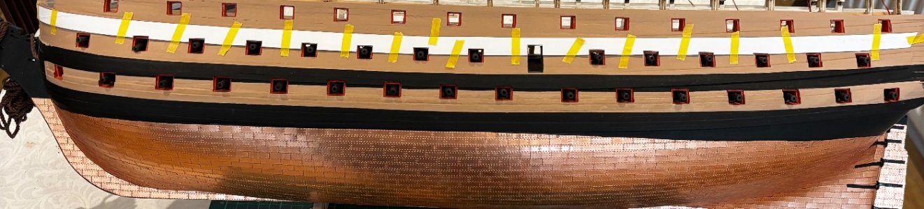

One Year On
It’s been one year today that I started this build.(27/11/24) I haven’t kept a note of how many hours I’ve spent to date, I think that would drive me mad thinking about how many hours of the 3000 or so they say to build it are left
I don’t work on her every day and there are the holidays and days out in between, so I just plod along at my own pace. I thought at the start that this would be a 4 or 5 year project for me.
Let’s see where we are this time next year

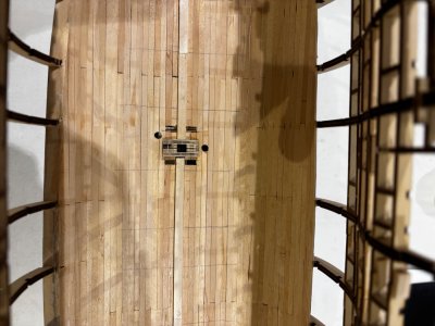

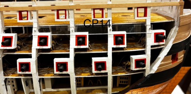

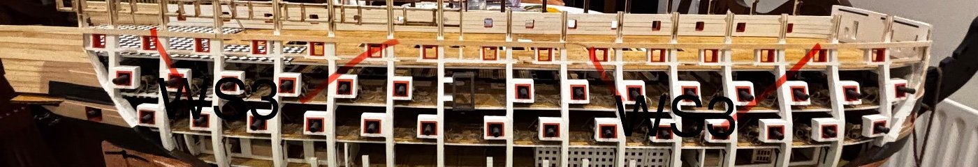

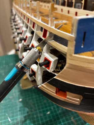

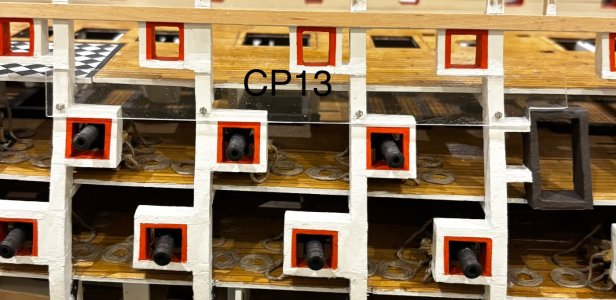

In the first part it’s back to making guns for the middle deck, 28 x 24lb on this deck. I won’t go into too much detail as it’s been covered before ( video #23) so will just show some progress pics
A couple of things I did differently this time. Firstly I glued the wheels to the axles, they don’t need to turn and last time I found it difficult to keep the glue at the bottom of the wheels when moving the guns into position on the deck. I think I mentioned last time that I didn’t like the look of the silver wire holding the wheels in place, so I looked at some photos of Victory’s actual guns and saw they were secured by what looks like a metal rod (possibly wood originally). So I bought some 3mm brass rod, cut it into short lengths and blackened it. I then drilled out the existing holes in the axles and glued the rods in place. I only have half of the guns actually in position on the deck at this point, but wanted to make the post today so I could wish you all a merry Christmas
Instructions video #30 part 2

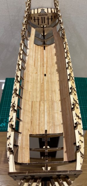

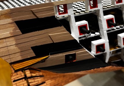

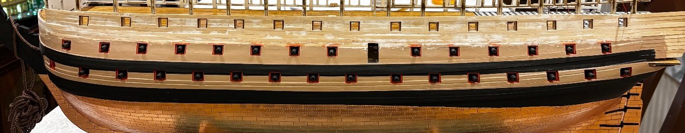

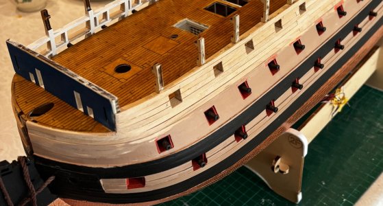

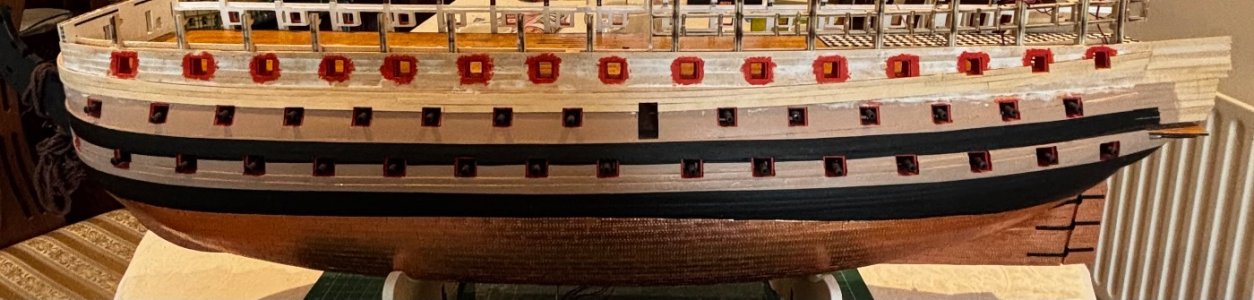

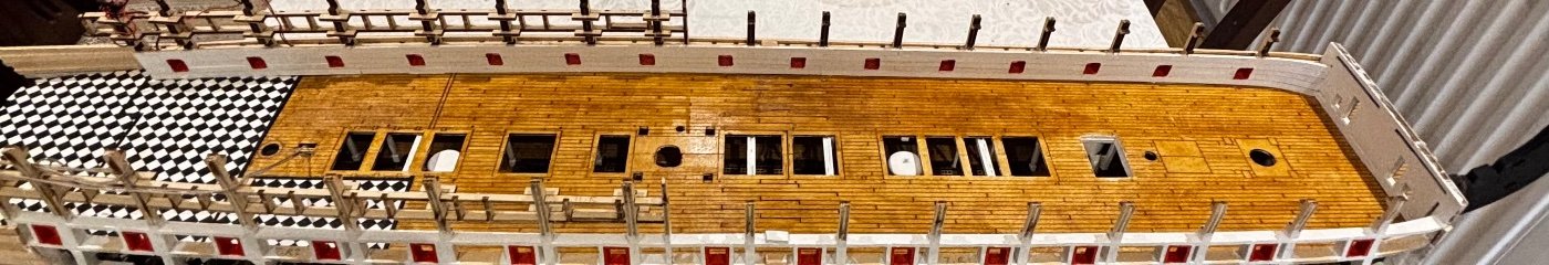

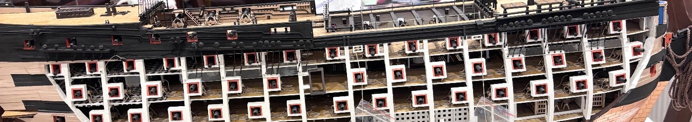

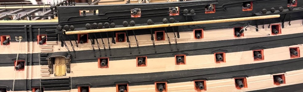

I dragged my heels a bit over the festive period but finally got all the guns mounted on the middle gun deck.
Before I start on the pillars and beams I thought I’d just post this short one.

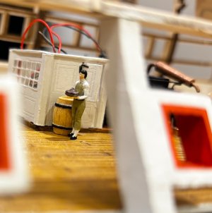

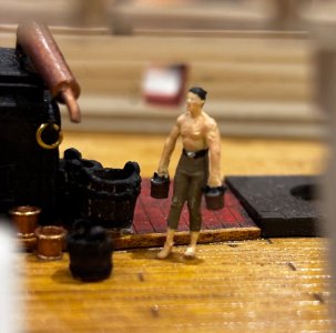

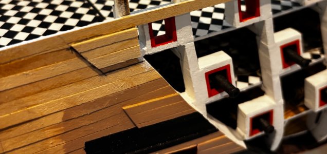

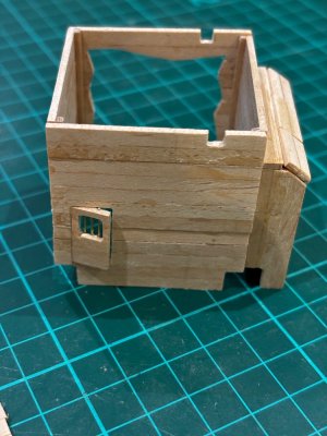

I made the furniture for the wardroom and painted up a few figures so I could create a little diorama in that area

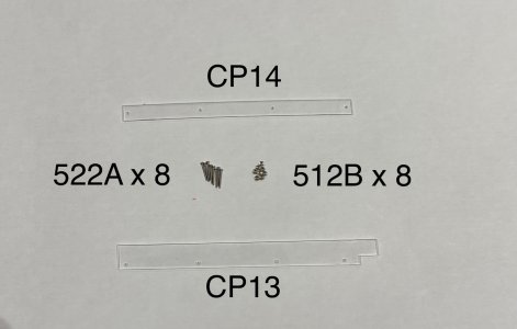

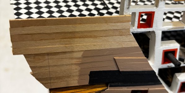

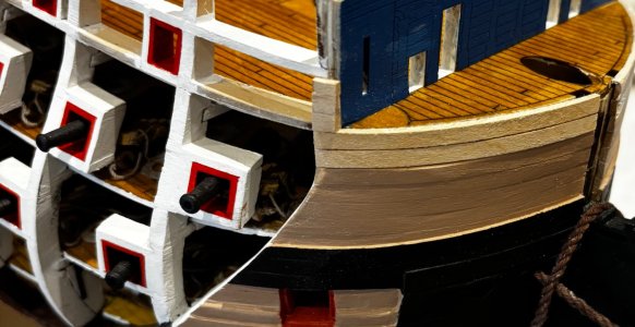

Finally, although this is not done until the end of video #30, I decided to do the printed walls at the stern sides.
