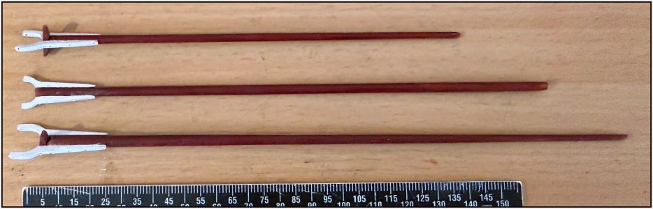

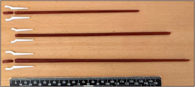

The boom and gaffs sawn to length and turned on the lathe to size:
Take the gaff for the mainsail with you at the same time. The 6 claw parts sawn out and given their first coat of white paint. Also the 2 clappers that go between the claws at the inner end of both gaffs.
Glued to the respective ends.
The shafts inserted through the clappers as well as the reinforcing pins in the jaws.

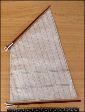

Because all parts need to be aligned, I also started on the gaff sail.
Both in its first years and now, the Balder has light sails. A sort of off-white.
Last month I spoke extensively with Ab Hoving @Ab Hoving about making sails in scale. Also about his experience working with the thin canvas: 'Havarra Fine Lawn'.
On the Bluenose, I made a few sails from 1 layer of tissue and a few from Japanese paper.
For the Bluenose in 1:72 scale, I had used the thin 11-gram Kashmir. That was very fragile to work with.
For the Balder, I am now making the gaff sail from the 18-gram Tengujo as a first test.
I have drawn the stitching and secured the folded leach with diluted glue. This sail has 2 reefing panels.
The next steps involve applying:
-'doubled' corner reinforcements;
-the bolt rope along the edge;
-eyelets at the corners as well as reinforcements and reefing eyelets at the end of the reefing panels;
-an eyelet at the top in every seam for the fitting seizing with which the sail is attached to the gaff;
-10 hoop lines on the luff;
-at the intersections of all the seams of the panels and both reef panels, all reef lines are secured with a small knot on both sides.
As it stands now, I am also going to make a 2nd test sail from the Navarra fabric. Presumably all seams have been drawn in as well, on Ab's advice. But possibly also an attempt to make them using my Admiral's sewing machine.
For now, plenty of work left.

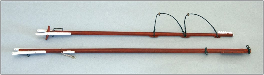

The gaff and boom for the mizzen sail are ready:
I will explain all the parts later when attaching the sail and the corresponding blocks and lines.
