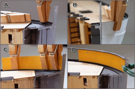

Before I could start putting the bulwark plates, I had to make some '3rd-8th hands'. I have to glue the plates to a strip of +/- 2 mm on the inside of the 5th row of plates. Which thus just protrudes above the outer profile of the waterway.
A: from a set of clothespins one leg shortened and I can put it on the edge;
B: the long leg supports further down on the outside and takes the angle of the plating.
C: the pegs fit neatly over the plate and the short port clamps on the narrow edge;
D: once the glue adheres immediately check the alignment with the hand rail. I had shown the double curvature of the plate earlier.

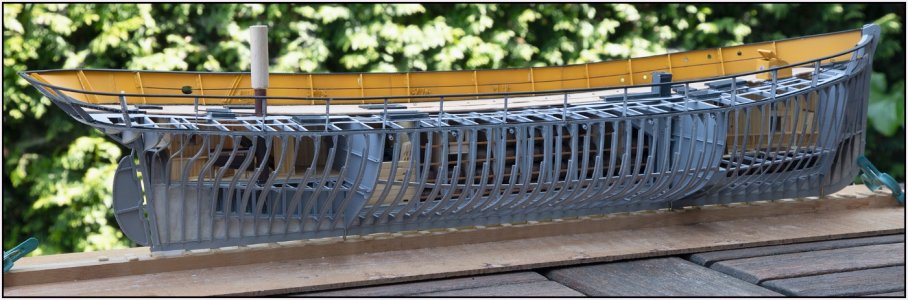

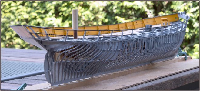

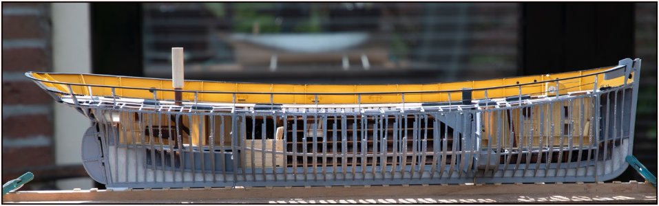

After a few hours of intensive building, this was the result:

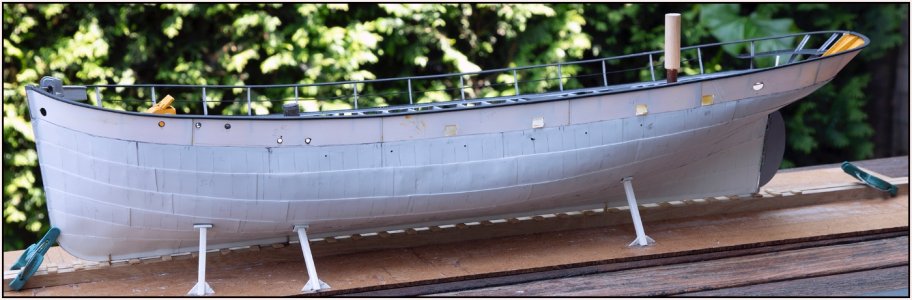

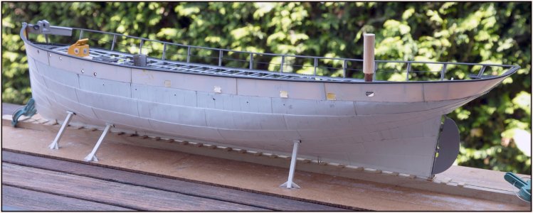

Immediately outside I took some pictures. But out of the sun because then I have a lot of glare on the deck and the white skin panels.
The black rod halfway is still dry-fit because various parts still need to be attached to and on the bulwark.
This is what the complete plating with hand rail looks like now:

Spray painting this side will be the next step.
With 2 more photos showing her lines nicely:
