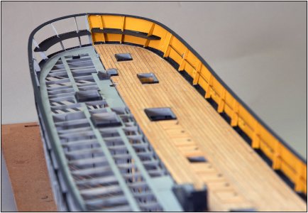

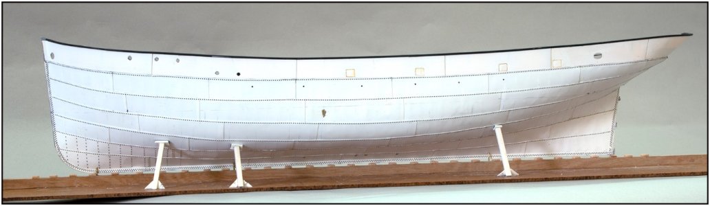

Before I could start putting the bulwark plates, I had to make some '3rd-8th hands'. I have to glue the plates to a strip of +/- 2 mm on the inside of the 5th row of plates. Which thus just protrudes above the outer profile of the waterway.
A: from a set of clothespins one leg shortened and I can put it on the edge;
B: the long leg supports further down on the outside and takes the angle of the plating.
C: the pegs fit neatly over the plate and the short port clamps on the narrow edge;
D: once the glue adheres immediately check the alignment with the hand rail. I had shown the double curvature of the plate earlier.
After a few hours of intensive building, this was the result:
Immediately outside I took some pictures. But out of the sun because then I have a lot of glare on the deck and the white skin panels.
The black rod halfway is still dry-fit because various parts still need to be attached to and on the bulwark.

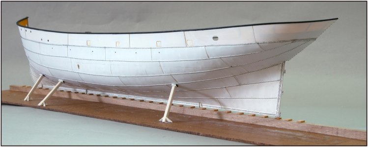

This is what the complete plating with hand rail looks like now:
Spray painting this side will be the next step.
With 2 more photos showing her lines nicely:
In the bow the reinforcement block still needs to be made and in the back the so-called 'koekepan'.

Thanks, Grant. :) But in basic the same as with your model: building a hull with frames. Only the material is different.

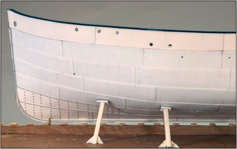

Started with the GRC: the Great Rivet Chapter.

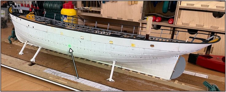

When spraying the bulwark supports I discovered that the penciled numbers continued to shine through the paint. They only disappeared after 3 layers.
Above the waterline the Balder gets a light blue/grey colour. Even more shines through that.
That is why I have to remove all the pencil lines above the waterline that I had drawn to indicate the position of the frames.

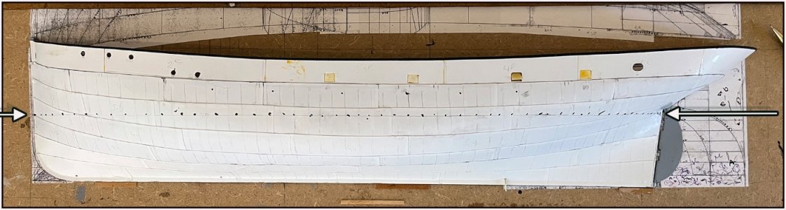

On my 'Astro laser pen' I stuck a piece of tape with a tiny punched hole and used it to line up the waterline:
The light point is just visible at the arrow.
Below the points I drew the line:
Above that I have to remove everything. The drawn waterline is then my reference point for the blue/grey paint. Depending on what is still visible afterwards, draw a new one, mask it off and then spray the black under the waterline on. I found a tape from 3M that has an adhesive layer that sticks a little less than the Post-It memo notes. Because if it sticks too much, I pull the rivets off again. A test gave a satisfactory result.

- the connection on the bow and keel beam has a double staggered row;
- the horizontal plate connections have a row that are close together;
- vertically they are further apart at the place of attachment with the frames and the vertical plate connections.
Once they are all set, first apply a layer of primer.
Now everything is very dominantly visible, but later with paint a lot more subtle.
Now have to wait until the new rivet stock is in.
