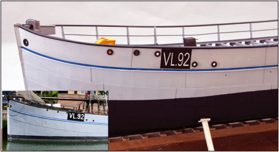

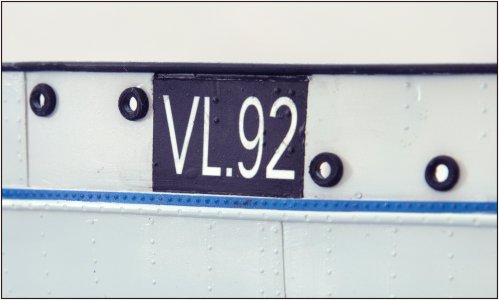

Made water-slide decals for the registration number:
The number '9' is perhaps a bit to modern ........ ;)
Some neat imitation paintwork with rivets visible through the paint.

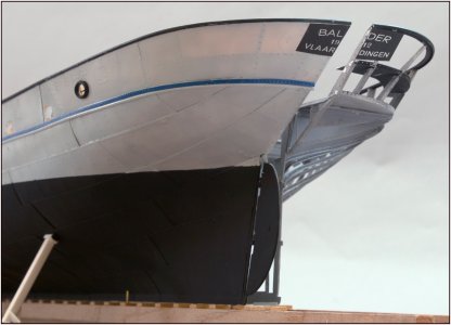

And her name on the stern:
Which should also be separable.
I see that I have to set a little black line on top of the left part of the decal to let it visual connect with the handrail.
Greetings, Peter

Beautiful work, Piotr, these rivets look so realistic. Best regards, Mirek
Thanks Mirek. I am also very happy with how they appear through the paint. :)

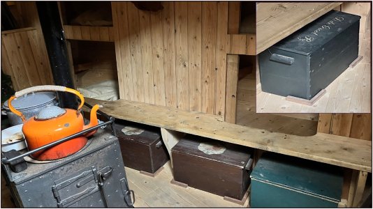

In the forecastle, each crew member has their own "Stoppekist." (Stuff-box). They keep their personal belongings in it. No forage, as that's provided by the company.
The boxes are stored under the bench seat.
Most of them have a name. The boxes must be neatly stored away.

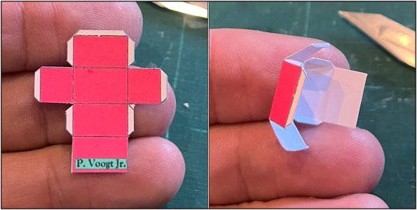

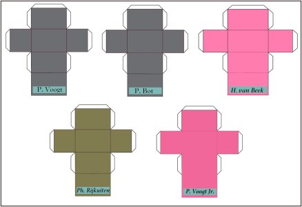

For 'instruction and amusement', I'm showing a few steps of making them.

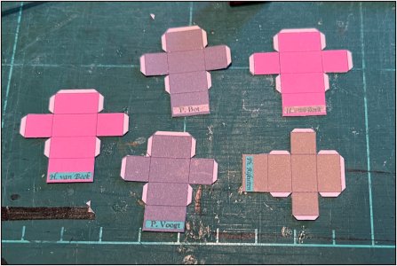

I made a design in PS and added some colors to brighten it up:
With these names, I honor the following people (from top left to bottom right):
- my father, who encouraged me from a young age to investigate things and acquire technical skills. I was allowed to open/unscrew everything, etc., but it had to be put back together again.
- my grandfather, the herring cooper. (See my post #1) A very warm-hearted man who always made me feel welcome. I inherited an old ship's clock/barometer and a ship's compass from him.
- the former chairman of the Balder Foundation, who helped me immensely, especially at the beginning of this project, and is still very interested.
- the volunteer coordinator, who is always ready to answer questions and is very helpful when I visit to inspect details.
- also a small box for myself.
Everything cut out with a new sharp knife:
For size reference:

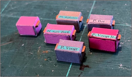

I also scored the fold edges and pre-folded the box.
After careful gluing:
Also a handle on each side for lifting.

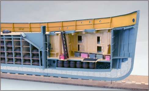

Placed in the forecastle:
They live there with 12 m/w. So, 6 wooden boxes on each side.

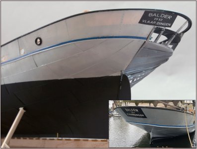

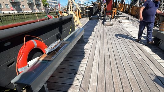

When I first saw your plating of the hull, I deemed the clearly visible seams of the skin plates a bit excessive. Now, when seeing the comparison between the original Balder and your interpretation, I must admit your model quite accurately looks like it's 1:1 namesake, .
You mentioned a point where I also had doubts. I started with the 0.13 mm sheet from Evergreen. But it was so thin that a little too much glue even caused holes. And it was very flexible around the frames. Moving on to the 0.25 mm sheet, I also saw the clear seams. But on an earlier test piece, I noticed that the seams also filled up a bit with paint during spraying, making them less prominent.
It now mainly depends on how the light falls. Angled light is, of course, the way to magnify any difference in level.
But the 1:1 comparisons are giving me a better feeling all the time.
I still need to get behind the camera properly to make some real comparisons where the camera angle is roughly the same. But that's really not easy. With a regular camera and f.i. a 50mm lens on a 26.80 m ship length, that would be 1mm on a 54 cm model........ uuuuuh ......... I'm going to get started with my 16mm.

When I saw the names during one of my first visits, I already had an idea.There are some things I could criticize about it when enlarged. But this small, under the benches, and soon with the stove in front, I think it's not too bad.

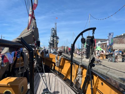

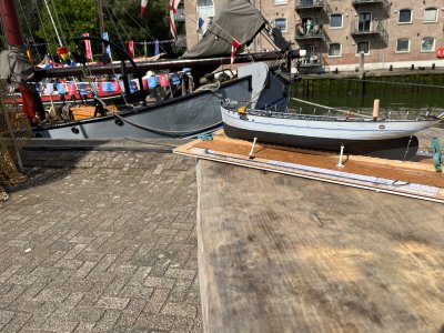

Today with my Balder on the Balder during the harbor-herring party: sHARING the CITY in Vlaardingen.
Nose to nose:
On deck:
With a view to the old Steam Grain Elevator:
And in the afternoon the MS Rotterdam sailed past the harbor:
Everyone directly in the shade and out of the wind …….. that one is huge!
A nice day, nice weather, nice people, nice drinks, nice food ……. What more could a person want on such a Saturday?
