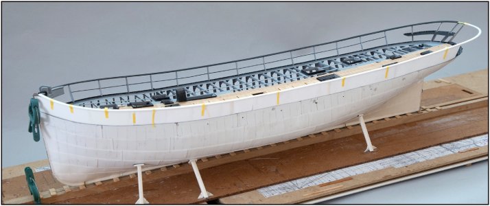

Then her final, as far as I am concerned, beautiful lines appear:
Where she looks different from all sides:
After almost 21 months of 'hard work' I can't get enough of these elegant lines.:)

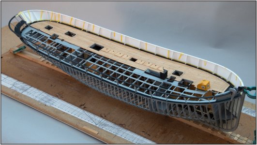

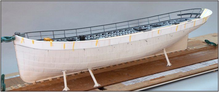

Beautiful…and she splits in two.

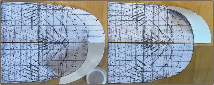

With a paper template it is easy to cut the corresponding plate from Evergeen. But then the .010"/0.25 mm plate also turns out to be stubborn to give and keep its desired shape. The paper version can be easily bent into shape, but the rear plate in particular took a lot of time.
Given the flexibility of the Evergreen, the plates and the handrail must be placed on the hull without tension. A little too much deviating tension and the rest will deform.
For the rear part, I kept bending and turning until the plate retained its shape:
I used the old line drawing for this.
On the left, the bottom side on the line of the outside of the deck. On the right, the plate upside down and the top side placed on the line of the bulwark. Then it had to fit eventually, because that line drawing was the starting point of my construction.
Here loose on the port side part.

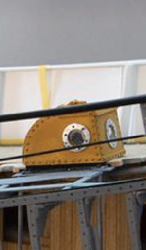

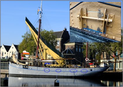

First, the 4 water valves that I had already seen on a photo of the Balder marked:

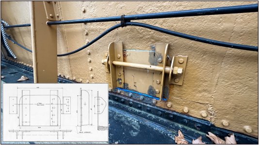

The scanned drawing from Amsterdam also included a technical drawing with dimensions of the valves:
A valve of 380x265 mm must then become 7 x 5.5 mm:
A macro shot then shows that I have to work very precisely.

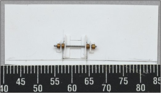

This will be the construction, first tested on a test piece:
with pieces of angle iron on the valve of 6 mm long and pieces of 3 mm long as hinge points. I still have pieces of spring wire of 0.5 ø mm and nuts M 0.8. I have to cut the corners of the profiles, but that's for the later versions.
The test piece on the plating with a slightly more normal viewing distance:
Of course the valve can open:
