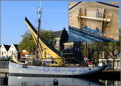

I cannot yet glue this row and start working on the bulwark. First, 6 scuppers have to be made in this row:
There are 6 holes in the waterways for this purpose with 90 degree pipes that drain to the side.
The photo also shows 2 of the 3 valves that are in the bulwark. These will be done later when cutting the bulwark plates to size.

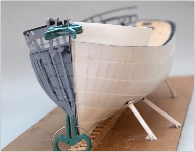

After gluing the 6th row, it was now the turn of the 1st plate of the bulwark:
I have to take into account various curves:
-the sheer and the outer curve of the deck;
-the upper handrail that protrudes outside the deck due to the sloping course of the plating, but is different everywhere.
That is almost extreme on the aft ship. That is why I started again at the front.
Then I also have to make sure that it runs parallel to the handrail that I have already placed on the starboard part.
It took me 5 paper templates before I had all the lines running neatly.
This gives a good idea of the various curves:
The upper point at the back of the 1st plate bends a bit too much outwards. That is due to the twisting of the plate. When I have the 2nd plate I can also set this one properly. It’s dry-fitted with only a small stroke of tape on the inside where it stands on the waterway.

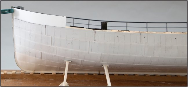

From another angle:
From almost standing up at the bow to the slope in the curve.

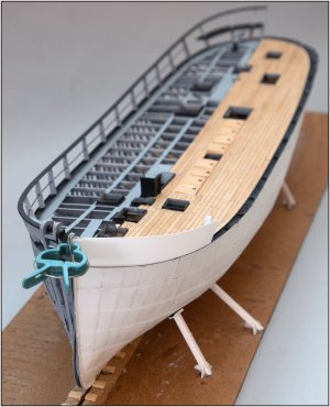

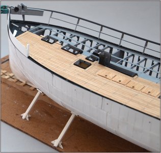

With the clear sheer and curve:
Hopefully the next plates will go a bit faster.

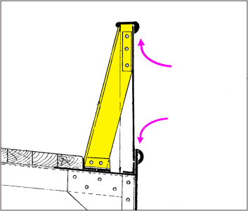

Looking great Peter! Quick question, would it not be beneficial to first add the same structure as the starboard side prior to adding the plates on the bulwarks?
Thanks, Dean. Also for thinking with me.:)Thumbsup
I also use the structure to estimate the size of the plates. But not the exact size because fitting a plate between the parts is almost impossible. All the plates have curves. In the middle only lengthwise but in the front and aft in more directions. An explanation using this earlier drawing:
To set the plate in the already stand structure, I have to fold the curved plates from the outside (blue arrows) against the inside of the handrail and top plate. From the inside it is not possible because of the support (yellow) with the small corner support on top. The supports are pushing from the side against the plates. And then there must be on the inside of the handrail a gap of 0,25 mm for the plate with the small corner support.
I also considered sliding them in but my plan is to first apply the 4 flaps to the plates before installing them:

I see, then I would add the lower corner support (angle iron) first (that the plate is above), then the plate, then the yellow braces and their mounting plates, and finally the handrail last. So it looks like you are working in the correct order. ;)
