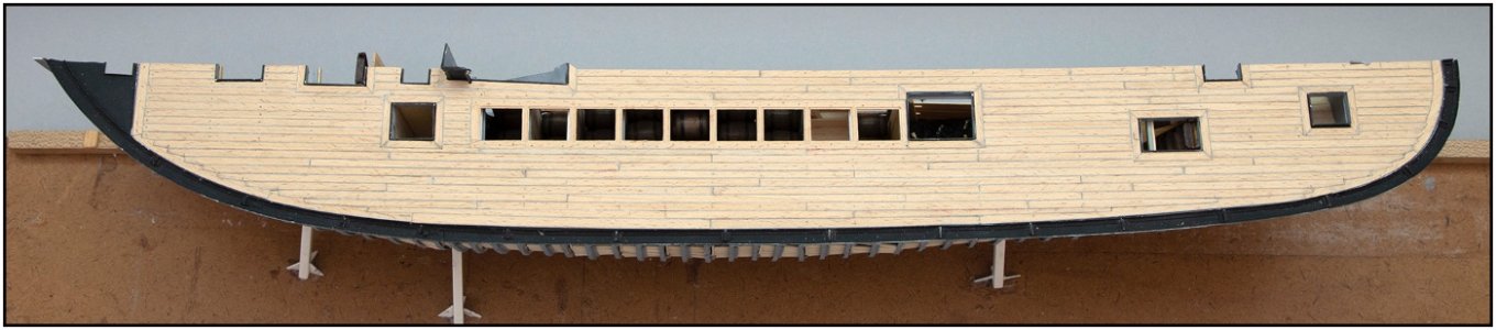

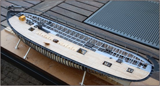

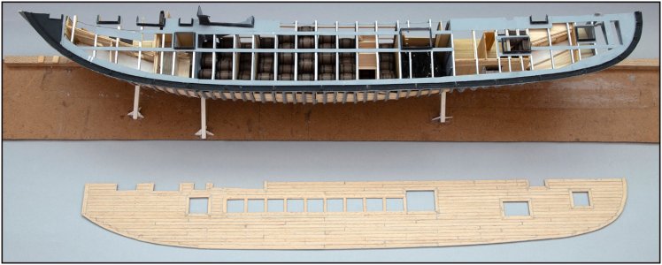

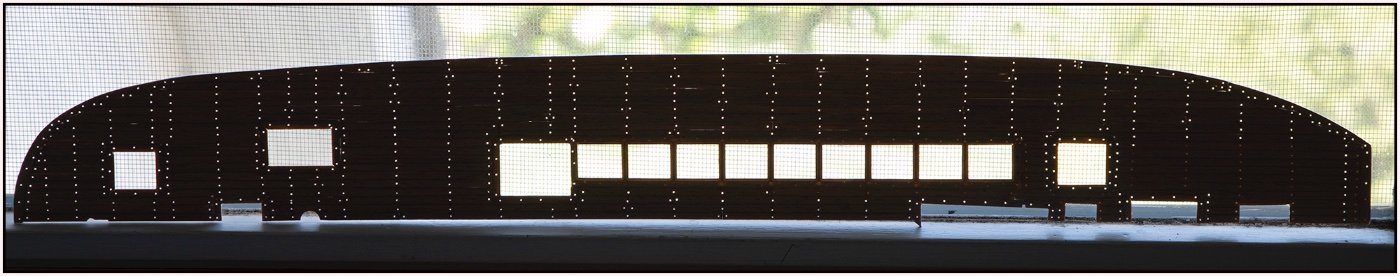

Also with the last planks and nibble planks. But eventually there is a completed deck sheet:
Especially taking into account the thickness of the gray joint strips between each connection.
It can still be placed and removed:
Because that is important for further finishing. It can still be placed under the drill column for all holes. And on the workbence place all plugs, sand, scrape etc. etc. The finishing can begin ........
Have you only glued the planks together? What glue are you using?
Hi Christian. Yes, only the 1,2 mm thick planks are glued together with the grey paper in between. The sheet has ‘some flexibility’ so I can bend it in the sheer and deck round. I used Bison D2 Houtlijm / Wood Glue / Colle a Bois.

After some minor setbacks such as spilling some water which caused some paper seams to swell and a door blowing shut that was stronger than my deck, I was finally able to drill all the holes:
Back to the old days with the punch cards......;)

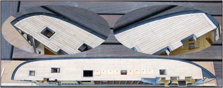

And then after the sanding and polishing: the miracle with the layers of linseed oil :):
With some enlargements of the nibbling and mitre work on the fore and aft deck.

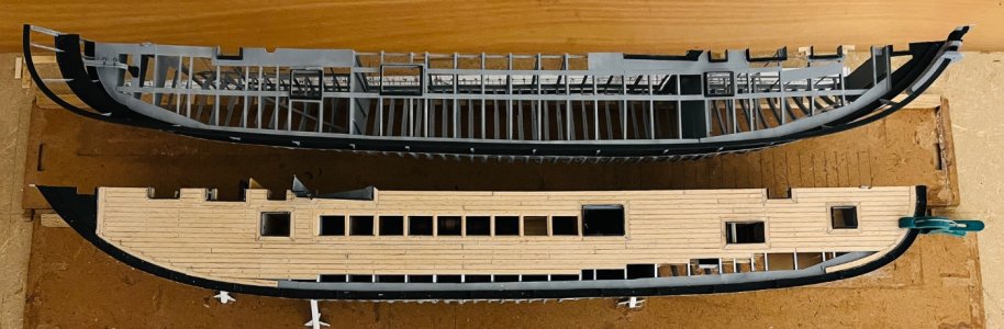

With the attached construction part:

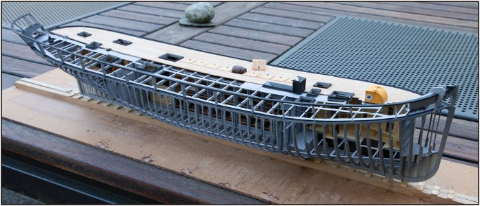

The disadvantage of a nice flat deck, the light reflects on it......;)
With a normal viewing distance, the plugs are not too dominant either:
Without bulwark on the port side a bit out of balance, but that will be addressed in the next phase: fitting the remaining skin plates.

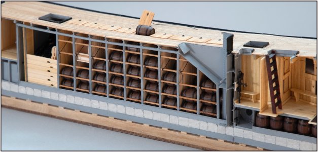

Some more details:
All hatches are secured with the lashing line, with the exception of that one.
Special to see the inside like this and then get an idea of how inventively people used space optimally. Were you able to find out exactly how this lashing was done? Especially at full hold.
Good question Stephan.:D
No, Hard to find someone who actively experienced ;) this. So far no description found.
