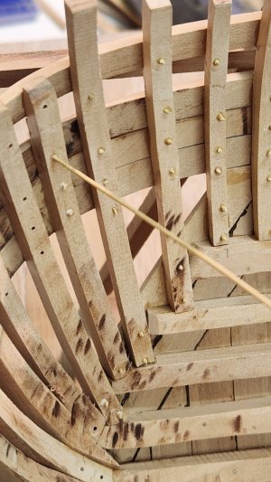

A small update to record the progress of the 'off-deck decking'. The sheet can still be removed.
And put back where all deck openings ensure that it's no longer shifts:
At the front, the 1st nibble plank is also glued. With the transition to the 2nd part. There are now 5 complete strokes up to the back.
After the 3 frames around the deck openings, there are now 4 towards the aft deck:
In the curve at the back, the first 7 planks are sawn off in the curve. Then they are also nibbled.
I am now going to lay complete strokes on the back, after which the connections with the middle follow. And I can fill the middle piece up to the side.

Beautiful work Peter! Will the deck remain removable or is that just while you build it?
Thanks, Dean. It’s just during the build. I can now press the planks against each other and straight against a steel ruler, upside down to be sure it’s flat, drill the holes for the plugs under the drill press, sand it flat on my workbench. At the end I glue it as a sheet and hopefully with a nice flow of the sheer and deck rounding. Because I now feel that the sheet has flexibility in it. After sanding it will be +\- 1 mm thick.

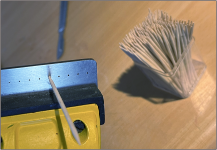

VERY nice work! Lots of things to like, but one that I noticed in the last photos is the subtlety of the deck nails/plugs. What material did you use for these faux nails? They look really good.
Thanks for the compliments, Allan. I made the 'plugs' with the regular toothpicks from the supermarket. I also did a test with increasingly thinner strips of beech from the boards, but to get them step by step through the desired opening of the DrawPlate .....
In the opening '31' they just fit with a little friction in the 0.6 mm holes. And they keep their point during the making which makes inserting in the holes easier.
I did the same on the hull and deck planking of my Bluenose and was very and was very satisfied with the end result after 2 layers of linseed oil.
I have yet to try toothpicks but I know it is popular. I do use my drawplate with the progressive holes down to 0.016 with bamboo as I can make fifty or one hundred with one small bamboo skewer that I split into a dozen strips and cut into individual treenails. If you have not already seen it, the following may be interesting as your method is shown as well as others. https://shipsofscale.com/sosforums/threads/tricks-of-the-trade.15492/page-2 post #25
Yes, I saw your post, Allen. And posted my method right after (#26). It works great for me and I don't have to strip and cut.
Ps: I would not recommend the 1st method shown with the unprocessed toothpicks. If you turn or push the slanted point into the drilled holes, those holes will be widened and the end result will be larger than desired. Unless that has been calculated and the holes have been drilled smaller in advance. Then you have to hope that the hardness of all the planks is the same.
In my case with that method: the 0,6 mm could be widened to 0,7 mm. It’s just 0,1 mm …… but a increase of 15%.
