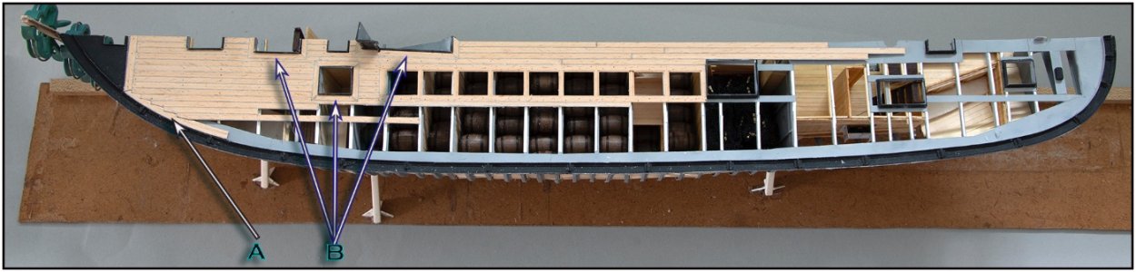

Thanks, Dean. Yes, the port side gets it’s full deck, all the hull plates and will be full equipped with all the fishery attributes. Also with the rigging. My intention is also the rigging to the starboard side, on the top of the masts attached with the mini magnets so I can take aside when I take both parts apart ……... I have all the time to design and work that out.Deck looks great Peter. Will you completely plank this half?
That sounds great! I’m certain you will accomplish it.Thanks, Dean. Yes, the port side gets it’s full deck, all the hull plates and will be full equipped with all the fishery attributes. Also with the rigging. My intention is also the rigging to the starboard side, on the top of the masts attached with the mini magnets so I can take aside when I take both parts apart ……... I have all the time to design and work that out.

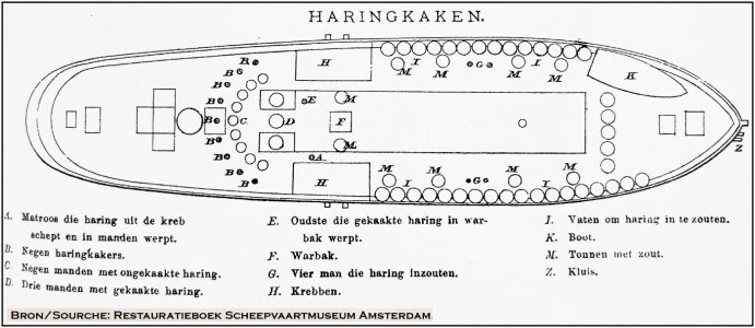

Interesting question. Also, did they clean and prepare the herring on deck (I guess so)? That means taking barrels out of the holds, filling them with herring and salt and re-storing the filled barrels in the holds. I can imagine it must have been a real mess on deck. Add wind,rain and low temps to the mix... Ideal circumstances to work in.How did they do that in real life? Once lashed, how do you get out of the hold? That is worth asking some old fishermen ......
Haha, thanks for noticing, but busy with some labour intensive details on de deck planking .....There have been no updates for a long time, I wonder what is happening with the model, what changes?![]()
That's for sure, Johan. It reminds me that I had this information ready to post:Interesting question. Also, did they clean and prepare the herring on deck (I guess so)? That means taking barrels out of the holds, filling them with herring and salt and re-storing the filled barrels in the holds. I can imagine it must have been a real mess on deck. Add wind,rain and low temps to the mix... Ideal circumstances to work in.

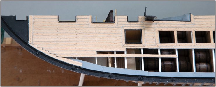

Thanks, Roger. I think it’s almost impossible to make the nibbles when the board is glued on deck.Absolutely beautiful work Peter. Like you I made the margin plank (nibble board) removable until I’d finished the adjacent planks. It made the cutting much easier.
Thanks, Paul. My new juwelers files are paying off.Beautiful, precise work, Peter!
Thanks, Daniel. When the pre-work is well done, the finishing will be easier…….. I hope …..Fantastic work Peter!
Good morning Peter. What they all say or ditto,ditto, ditto and dittoThanks, Mirek. Do my best …….
