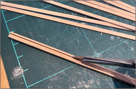

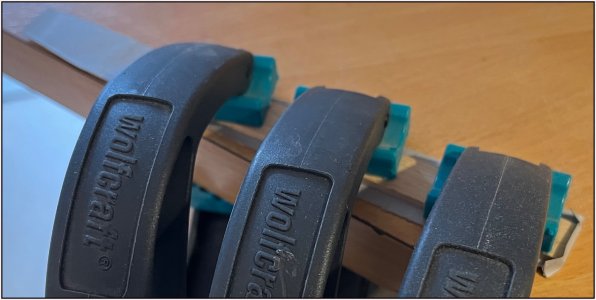

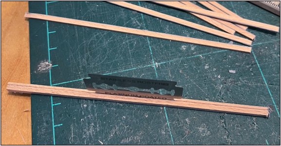

Started planking the deck. The intention was to glue the narrow cut grey strips on the sides of the planks. A hopeless task...... :(
As a test, 10 planks next to each other on a strip of grey paper clamped with wood glue between the banks and the paper:
After drying, plank by plank, first loosened them a little with a razor blade:
Then cut through the underlying paper with an extra sharpened scalpel blade:
A method that I like.

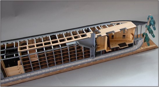

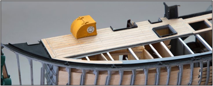

Started planking on the foredeck:
First made the front plank and the first curved nibble plank against the waterway.
After 2 rows of short planks between the deck openings, I could then lay the first long plank to create a parallel direction to the hatch frame.

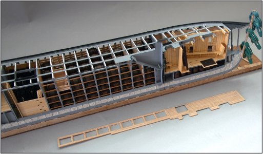

As a proven method during the build of my Bluenose: making the planking temporarily removable:
Then it is easier:
-glue each new plank on a flat surface;
-mill edges on the underside to bridge the raised edges of the profiles of the deck openings;
-finish all edges;
-drill the holes under the drill column;
-plug and sand on the worktable.
And on this model of mainly Evergeen I can't press too much on the deck beams.

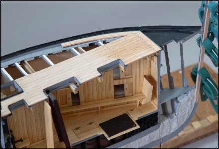

The planks and plugs lightly sanded:
The planks are 2.65 mm wide and the plugs 0.6 mm.
The front part was made a little wet to see how the plugs and caulking are expressed.
With a better view of the deck openings:
The light cove was also placed to see how the connection is.
PS: A brief explanation of the installation of the planks on the Balder itself. The planks are bolted to the iron deck beams. These bolts are sunk into the planks and the plugs cover the heads of the bolts. So it looks like treenailing ....., it is .... but it isn't ........;)
The appearance of your decking with the gray caulk is very eye appealing! I just added your off-deck decking technique to my knowledge base, I love it.
Thanks, Daniel. That’s a nice name for this type of planking: ‘off-deck decking’.:)
You have to do some extra steps but for me it has several advantages.
Wonderful, Peter! Everything properly in scale and very tidy. Love the wood planking and it's visual and textural contrast with the steel...
Thanks, Paul. You know I am a great lover of linseed oil. That will make the wood a bit darker and ‘warmer’. And for sure, the wood/steel combination is nice.
