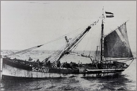

Beautiful work as usual Peter, it just keeps getting better! I did note however, the smoke or exhaust stack seems to be facing the wrong way (180 degrees out). Not sure if this was intentional?
I was waiting for this question,;) they asked it also on the Dutch forum ......... so thanks for asking, Dean.:)
The photo shows the stack facing forward. As if the ship is sailing before the wind. And there's a pressure 'draft' in the stack to dissipate the smoke and heat from the Donkey boiler.
I'm going to initially present my model as if she were fishing with the ‘vleet’ (fishing nets) out in front of the ship. The foremast is lowered and only the mizzen sail is set. This way, she's facing the wind and the ship keeps the ‘vleet’ tight. The wind is coming from the front, over the head, and they've turned the exhaust aft. This keeps the draft in the exhaust.
Many pages and posts ago (p. 15, #293) I showed this photo:
The flag is clearly pointing straight aft.
That's why the two funnels on my foredeck are also pointed aft. All three can be turned by hand. Depending on whether there was heating and which way the prevailing wind was blowing over the ship.
The main mast was lowered because it caught far too much wind, and the ship would then be unstable astern.
You can also see that the tip of the main mast extends beyond the mizzen mast. Therefore, the ‘kossing’ (mast housing) is also 2 degrees off-center, allowing the main mast to tilt diagonally past the mizzen mast.
Ok makes sense!
Wow, that's a lot of mast to tip back like that. You'd have to have a lot of faith in the forestay!
That’s for sure, Russ. But with 2 big metal 4-sheave blocks, a big stay and the endplate of the kossing it rests for the test of the fishing. And there are 2 more ‘tackles’ in front of the mast. I’ll show that when I am starting with the rigging.
