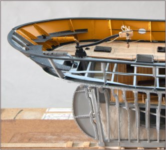

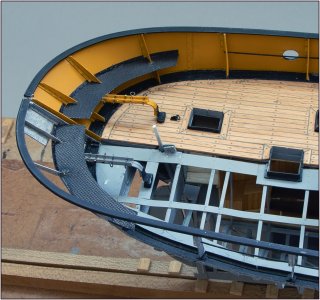

I did some work on the aft side.
I'd already shown how the sloop is mounted on supports there:
During the time that the sloop is being painted, the supports were more visible.
Everything's neatly painted again.
I'd already made the support on the starboard side. Now I've done the same on the port side:
I won't make the four blocks that hold the sloop in place until I've built the sloop. Then I can make them to the shape of the hull.
And now I can also determine the sloop's size so that it fits within the bulwark and above the "koekepan".
For now, I've only made the lashing eye on the port deck. And I forgot to glue the lashing to the "frying pan" as well... :rolleyes: My intention is to secure the sloop to the port support in such a way that I can separate both halves without removing the sloop. Because then I'd have to loosen the lashing as well. It’s on the list of other challenges I still have to work out .......;)

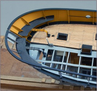

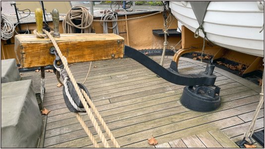

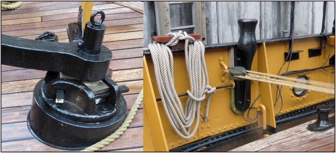

With the tiller still fresh in my mind, I set to work on it.
An overview:
With a bearing to secure the rudder stock, on top of that the metal tiller, with a wooden reinforcement at the end into which two large belay pins are inserted. And on de sides a single sheave blok.

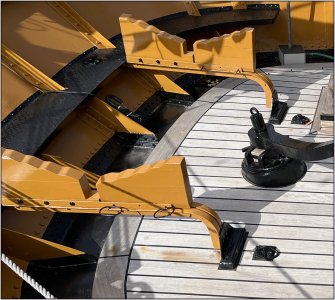

Some details:
The bearing with pieces of hard wood on three sides, each secured with a wedge. On the inside of the bulwark is a metal bracket to which a single sheave block is hooked.

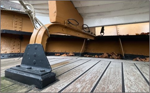

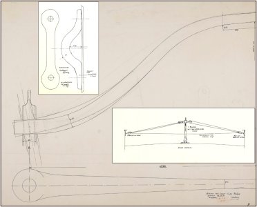

Various components are also detailed on drawings I obtained from the Amsterdam archives:
I have pasted two other details in the drawing of the tiller. Top left is the metal bracket with the caption "Brackets for steering tackle, 2 pieces."
There is also a schematic representation of "the steering system," with "circular tackle, manila 25 ø" and on the right side "block with becket and hook."
This has been adjusted on the Balder:

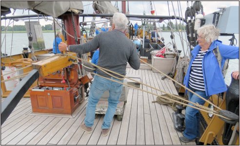

There are now two loose ends coming from the side blocks. Here, the skipper holds both of them in his right hand as we sail sharply out of Maassluis harbor. This puts a lot of force on the rudder. A moment later, he releases the port end and pulls strongly on the rudder, supported by the tightening starboard tackle.

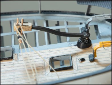

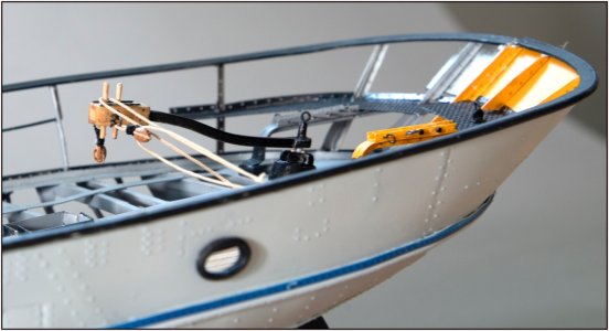

This is how it turned out on my Balder:
Only the port tackle is reeved.
On the wooden end, the two wooden belay pins and on top, on either side the metal strips to prevent wear on the lines and block.
View of the bearing:
The three wedged wooden nuts are just visible.......;)
I still need to figure out something to tighten the lines a bit. Some clear varnish on them? On the other hand: everything is in rest.:)
