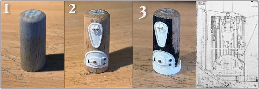

Based on the drawing, I've estimated the dimensions: height 28 mm and diameter 14 mm. Let's see if this will be a successful attempt:
1: Starting point: a piece of 12 mm beech.
2: Under the fire room door and above the boiler shutter, secured with two bolted clamps.
3: I started cladding the boiler for insulation and safety. I used 1.05 x 0.65 mm slats. This was actually waste from sawing the deck planks. But who saves anything ........;) With the example drawing next to it.
I had already blackened the slats themselves with black Schmincke Aero Color Professional. To sand off the fibers once dry before gluing the pieces to the boiler, which then would make it difficult to sand. A pigment ink that I also used a lot on my Bluenose. Because this is thin, I had an idea... wouldn't this be suitable for stoves? I first tried it on the back, which isn't visible. With a result that I'm satisfied with:

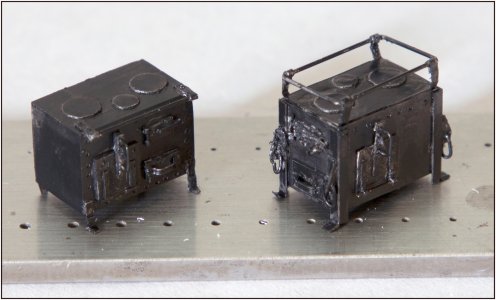

I lightened the photo a bit because all the black obscures many details. But fortunately also an unevenness of the parts.;)
After two coats, it achieved a smooth, matte finish. Ovens that are cherished by the crew and cleaned and maintained from time to time with "stove black." Yes, I remember that from the past. My mother used it to maintain the coal stove in our house. And I remember cleaning the windows with wads of newspaper. That still works very well, by the way.:) But that's beside the point .....

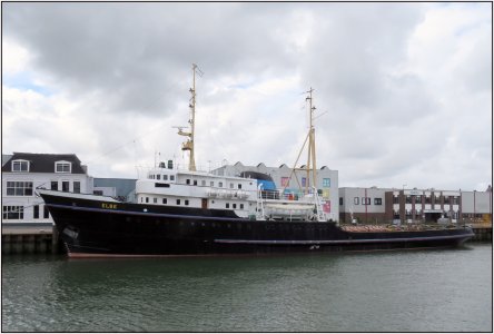

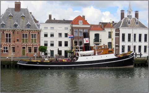

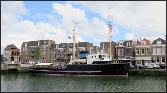

Maassluis has long been the home port of the Smit towing company. Several well-maintained seagoing tugs are still moored in the inner and outer harbors:
The Furie, the only seagoing steam tug still sailing:
The Hudson:
The Elbe:
All beautifully lined seagoing tugs. A travel tip: Maassluis has the "Tugboat Museum," with many beautiful ship models.

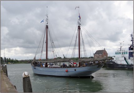

Then the Balder arrived in the harbor. The beginning of the voyage on the "Salt Water":
First, a quick turnaround in the harbor before mooring.

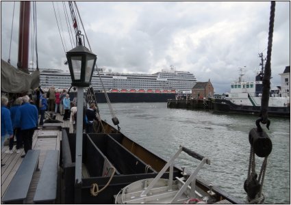

Before departure, a brief harbor closure:
Just like three weeks ago during "sHaring the City." The MS Rotterdam is currently on three-weekly cruises from Rotterdam.

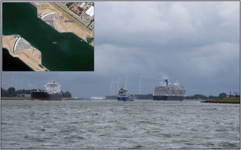

Sailing is not an option at this busy gateway to the Rotterdam ports, the 'Nieuwe Waterweg':
In the background, you can just see the white structure of the Maeslantkering barrier, which can close off the Nieuwe Waterweg at high tide. This ensures that Rotterdam and the surrounding area stay dry.

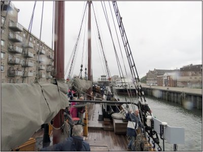

And I was also allowed to use the tiller for a while. Keeping the Balder on course:
A hand tackle on either side of the tiller helps with steering when heavier forces are applied.

With its high bow, the helmsman doesn't have a clear view of what's directly ahead. The Balder has two volunteers authorized to sail her. Here, one gives instructions to the other: a touch starboard, a touch port, straight ahead...
It all fits just fine.

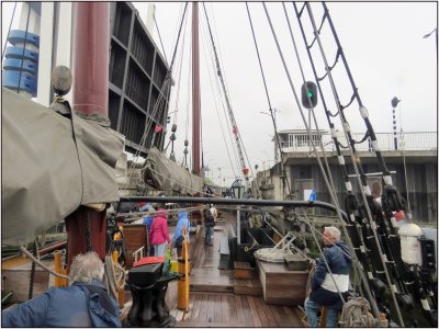

By the way, I am wondering: why are there two handles, next to each other, on the helm?
It are just 2 belaying pins. Perhaps this photo will make it clearer:
This was the moment we were just leaving the harbor in front of that marker post, and just started to steer to port.
The running end of the port tackle is looped over the tiller and he's slung it around his back and holding it in his right hand. The running end of the starboard tackle is also gripping the same. A moment later, he releases the port rope and pulls with the pin on the tiller and on the starboard rope to get the tackle to help turning the rudder. If the forces last longer, he could temporarily secure the rope with a turn around the pin.
On the right, my Admiral watches with great interest the hard work required for these kinds of maneuvers, while I can comfortably capture it in a photo.
And there are 2 belaying pins to secure both ropes when the tiller could be hold in position for longer time.

I started working on both stoves. They are solid sheet steel stoves:
The left one is in the galley and the right one is in the forecastle.
The galley, however, is in the starboard section:
That's why I was already planking the alcove and adding a section of flooring. That will be the only part of this construction section that's been fitted out.
And the position of the stove in the forecastle:
For the detail-lovers: the stove has four lashing eyes for extra securing in rough weather. And a few of the "stoppekiste" have been replaced with ones in a more acceptable color ....... ;)
It will be a while before I spray-paint both stoves black. First, I still have to make the two stovepipes. In the galley, that won't be much of a problem. However, the one in the forecastle also opens onto the starboard side ....... so that will have to be divisible as well .......... Redface
To avoid cleaning the air-brush to often, I'm now going to start working on the Donkey Boiler:
Which I'm building based on this drawing and an old photo. That will be the next challenge ...... :)
