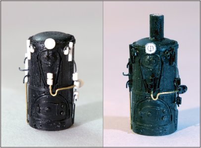

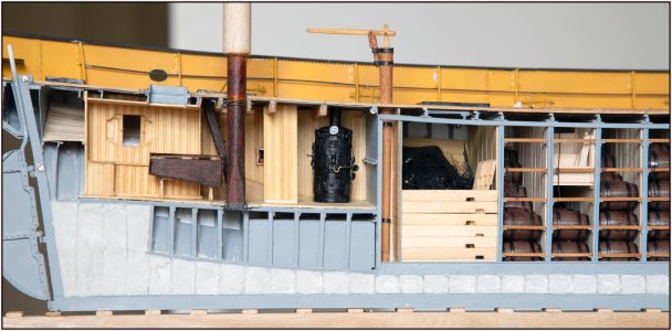

The installers continued working and connected the Donkey boiler:
On the left of the boiler is the water supply with a crank pump.
On the right is the steam pipe that runs along the wall and then through the deck to the steam spindle, which is yet to be installed. It's a bit dark there, so the right-hand photo is slightly brightened.

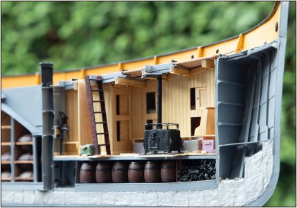

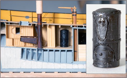

The stove in the forecastle:
Because the stove is in the center and the chimney extends outward on the starboard side of the skylight, the chimney had to be divided. It currently protrudes slightly from the middle, but other parts do that.
I can now close the "interior" chapter:

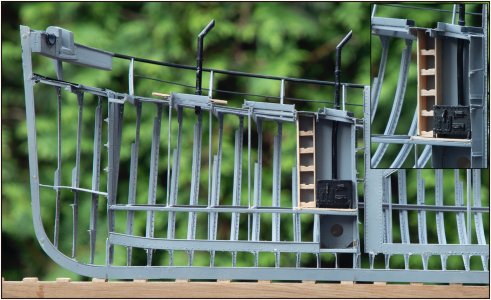

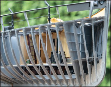

I was just able to get a view of the stove and chimney through the frames:
On the real Balder the two chimneys on the deck can be removed. That's why there's a handle on each side.

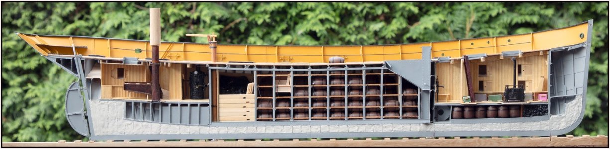

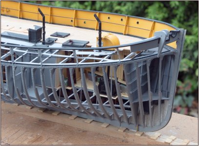

The front section:

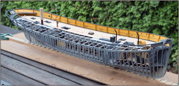

And the current state:
I have to be a bit more careful now as I continue with the deck layout. Fragile protrusions ........

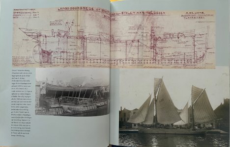

Also one of the drawing I also use:
