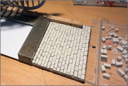

A 2nd piece as a test:
That is going to look much better. Just align it from time to time so that it stays somewhat straight/square.
1 box of stones used up:
With stones of slightly varying sizes, it gets quite an old-fashioned look.

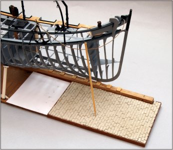

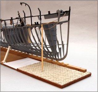

That is good for almost 91 cm². 40 rows of +/- 12 stones is 480 pieces (with about 10 left over).
Here I have already grouted and fixed the sand with matte varnish.
You can already see a wooden stake at the bow. That is what the Balder will be supported all around with:
