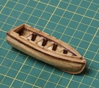

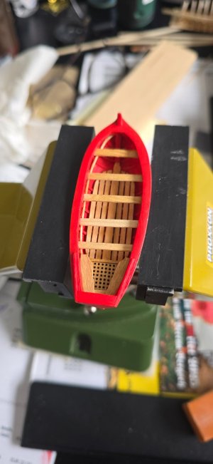

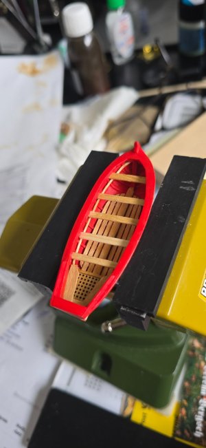

Hey friends,

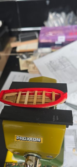

another little update from me. I had to make a few changes that I didn't like. Working at this scale is really getting me down. But, it should look nicer than the horrible dinghy of the Black Swan. But what did I do?

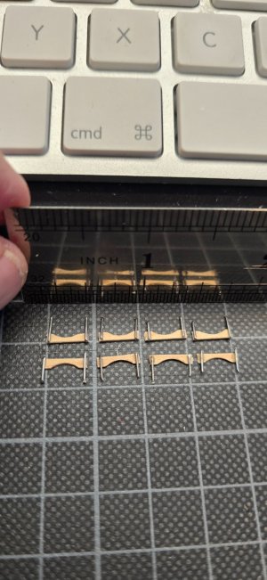

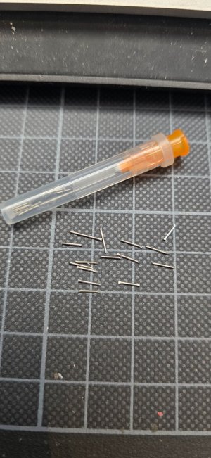

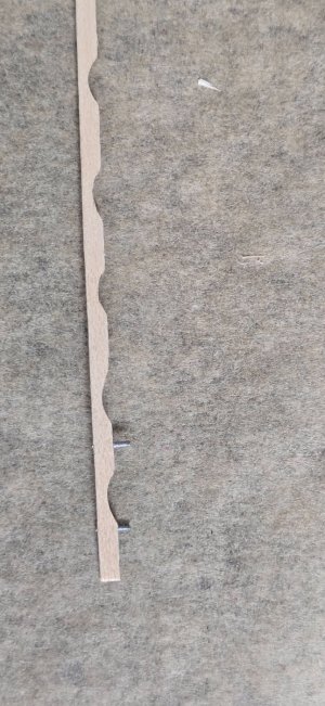

I replaced the gratings with maple gratings. These had to be cut to shape, sanded and then rounded off with a 0.3 mm maple strip. Then I turned my attention to the dowels. After all, my rudder straps have to be held and used. To do this, I sanded a lime strip to 2 x 0.5 mm. Then I clamped it in the vice and inserted a curved shaft with the cylindrical sander. Then I took 0.5 mm needles and shortened them to 2 mm. These are supposed to be the real dowels. The wood serves to stabilize the dowels. I glued both together with a lot of effort and holding my breath. It took sooooo long, as many of the cannulas simply slipped away and were lost forever in the nirvana of the carpet table.
As always, here are my pictures.
Best regards
Günther

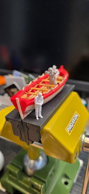

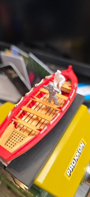

Oh yes, this is what the little dinghy looks like now. It's not finished yet..... but I think it's already better than that awful dinghy...don't you?

Good morning Gunther. I totally agree the little ships boat is looking much better. Lovely work. Cheers Grant

Good morning Grant,
Thank you very much for your motivating comment. I am very happy about it.:DThumbsup

So this is my first scratch build and I'm only now beginning to understand the process and why it can take so long. I don't have a plan as a basis for the build, just my technical understanding. I also have to say that there is an absolute risk of addiction to getting better and better.
The dinghy is far from finished and there are still a few things missing. I want to build it as detailed as my skills allow me to. Even if it looks so small and simple, it really isn't.

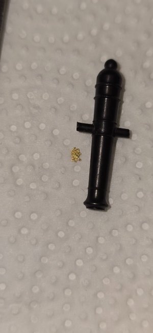

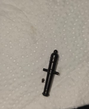

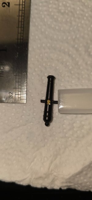

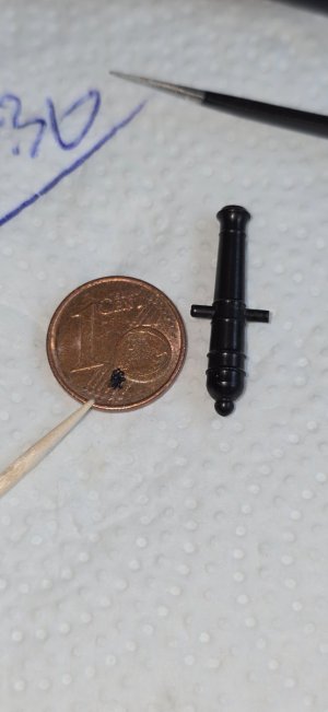

Good morning heroes of model building,
I needed another task on the boat, otherwise I wouldn't be so focused. I was a bit sloppy with some of the attachments on the boat and had to remedy the situation.

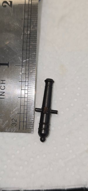

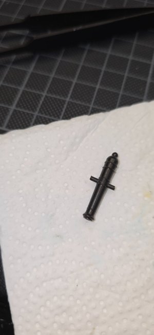

That's why I thought I'd take care of a gun barrel for once. In other words, I bronzed and adapted it. Then I cut the bolt to size.

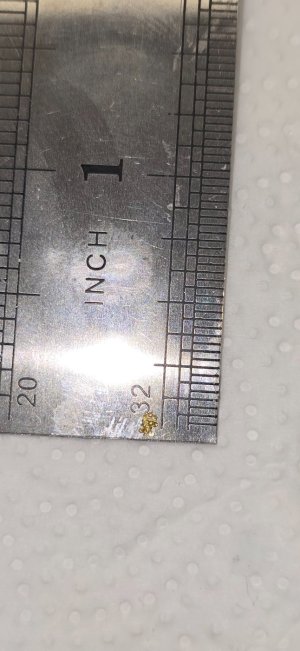

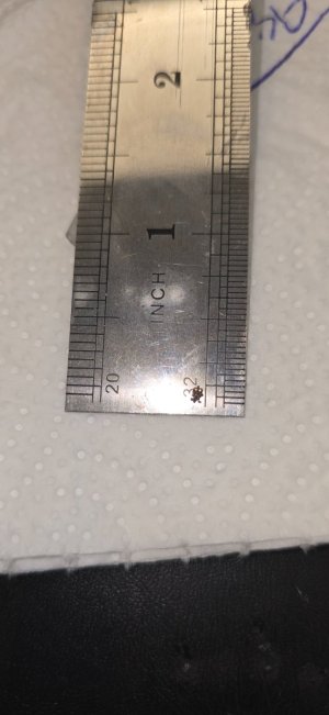

I decided to put one of my cannon crests on the cannon.
I hope you can recognize it, it's really tiny. It still has to be bent and burnished. But it's so tiny that if I lift it too hard with the tweezers, it bounces away and gets lost in the nirvana of the ground. The madness. Here are a few more photos for you.....
Greetings
Günther
That’s amazing! Do you solder the crest to the barrel, or use CA?
Hey Namabiiru,
I can't solder it because it's just too small and I'm not that good at soldering. I use a metal adhesive. Then you won't be able to get it off. The only disadvantage is that it has to be fitted exactly. You can no longer correct it because it immediately welds to the surface.
Günther Ship-1

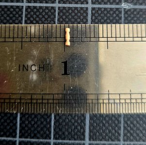

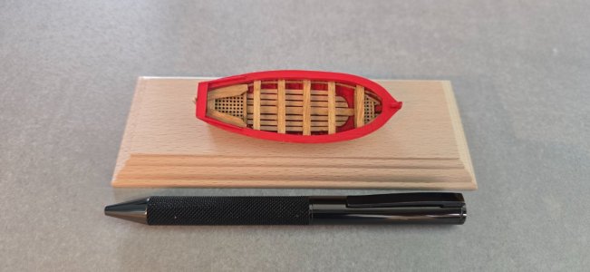

Hi guys,
I'm currently trying my hand at the fastener for the mast attachment. Once again it's all tiny work.
I have taken a photo of a pillar for the seat boards in the dinghy. Here you can see how small it is.
I also wanted to show you a photo of what the dinghy looks like. But it's not finished yet...

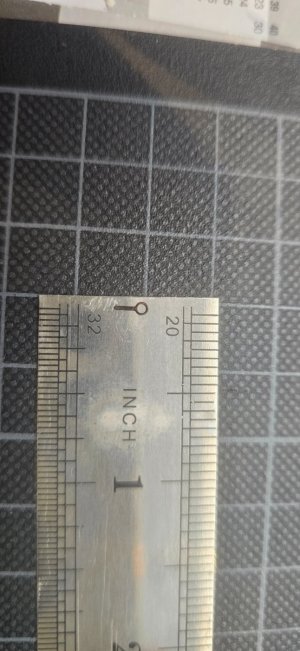

I was on holiday with my family for 10 days on the beautiful island of Mallorca near Spain. Now I'm back here again. I couldn't do much to my little dinghy. Here are a few photos of how tiny it is....
Best regards
Günther
There is still some work to do. I hope to finish it this week and then I can show you this little dinghy in its full splendor. Let me surprise you...
Best regards
Günther

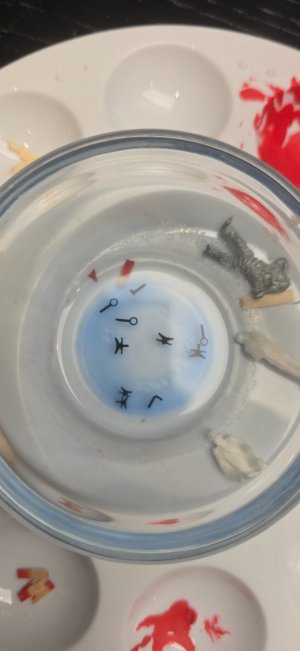

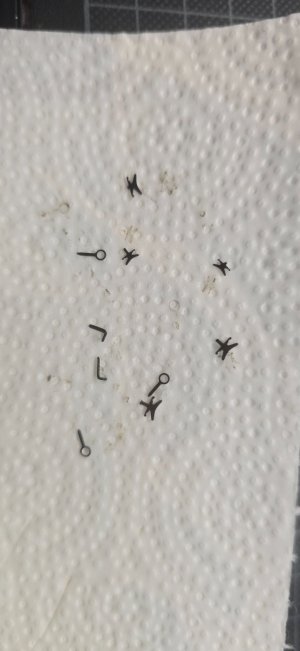

Here are a few burnished mini parts like eyelets and cleats for my dinghy.
Good job. One piece of advice for the future. Take all the wood you will use and cover it with different types of oil (if you will apply it) and let it lie where the model will stand in the future during the entire construction period. This is necessary in order to see how much and how the color will change. Because the result immediately and after a couple of months varies greatly and, for example, light wood species can turn very yellow from some types of oils, and the samples will show you this so that there are no surprises on the model later.
Hey Sergey,
Thank you very much for the tip and the kind comment. The dinghy isn't finished yet. But I have managed to add some details.
