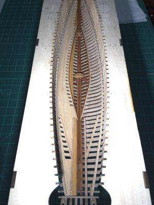

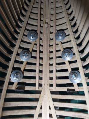

Bow lower platform/floor: I cut and sanded the support beams at the bow. I adjusted them to be 3 mm above the last middle beam. The transition step is then at frame 13. Based on the following measurements, I should be able to clear either 4 pairs of bunkbeds or 3 pairs + single.
Bunkbed dimensions: Navy std = 72" long x 30" wide x 17" height. This translates to 25 mm x 10.5 mm x 6 mm
Bow height across the floor: 21 mm at the middle to 11 mm at the bow. The height should barely clear the be
Overall room: the wall will be located at frame 15, nearly 135 mm away from the bow. That should give some flexibility in fitting them.
Lastly (unresolved): could the beams/anchor points coming down from the deck (YQ design) be incorporated within the design? Maybe some of them... NOTE LATER: won't really fit with the bunkbeds. That's OK. The small spacers pieces can be used later within the main deck for reference and anchors points at the bottom of the beams. 4-5 mm should be enough to stabilize the deck components.
Stingers: Stingers installed. They are build from a 3mm x 2mm strips, then shaped at an angle. It's a slow process... One last set of support beams to go: the captain's cabin floor. Will shape then but may wait until the ceiling is planked. It seen a lot easier that way them planking around them. Will see...

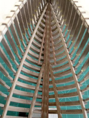

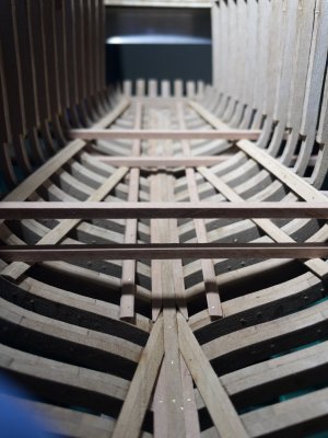

Bow floor support beams: This is what they look like, glued in place. As you can see, they are a lot lower than outlined by
YQ since this will be a floor rather than a support structure. Build using 3mm x 1mm strips and again shaped at an angle.

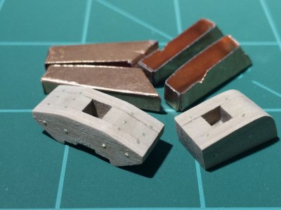

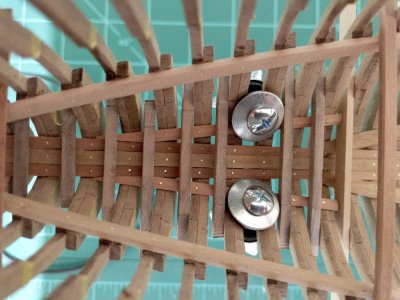

Mast support blocks and water wells: Taking a short break... so doing only a few little things here and there. 2x zoom picture is very unforgiving - will need to quickly sand with a higher grit. Main mast support block needed some tweaking to account for the sister keelson... I knew it was coming but a little tedious to do manually (and straight). Water wells are finally glued and ready to go. Adding bolts is now less stressful with 0.6mm carbide bits - they stay sharp and with a mini-drill press they don't break - I'm still using the same one from when I started the interior.

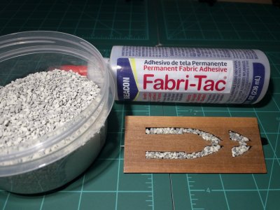

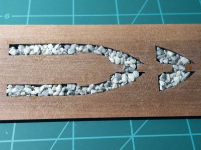

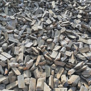

Pig iron as ballast: Pig iron can vary quite a lot in size. The smallest are 140x140x70mm, medium 200x200x100mm while the largest can be up to 280x100x65mm. At 1/172 this is roughly 2-4mm irregular in size. E6000 as glue is ok, but the chemical smell is quite bad. I tried Frabri-Tac because the solvent is acetone, a less aggressive smell and can be diluted to the consistency you want while still drying fast. Here's a quick test:

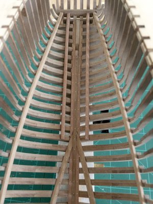

Captain's cabin floor: Installed the support beams for the captain cabin floor. Getting it to be at the proper spacing and parallel to the waterline is an exercise in patience. Installing the support beams now will allow me to build the inner platform (floor) like the rest of the ship.

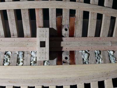

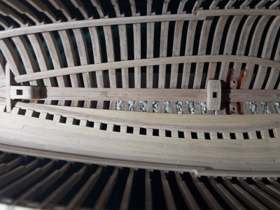

Masts, Water Wells and Ballast: Final elements at the bottom of the ship. It is nice to have the masts pre-shaped. However, they are cut to exact length... so no room for mistake when making the square end. It is always nice to see the ship developing with the addition of new elements.
