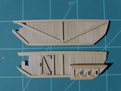

Hi Loracs. At first I haven’t gave you post a ‘like’ …….Unusual problem - Walls Warping: I came across an issue that is puzzling me. I can't really find a solution and/or a prevention. Maybe someone here has a tip. The issue is the following:

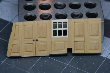

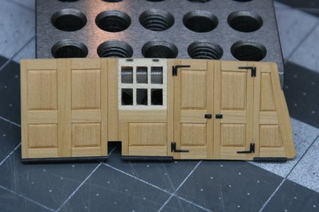

I have been edge-gluing strips to create walls (see above). I then place the wall between two pieces of wood and let it dry either overnight or up to 3 days. When I free the wall, everything is fine for several hours, then I see warping that gets worse with time (see below in picture). Would treating with linseed oil right after the overnight dry help prevent that? Any way other trick? Have any of you ever seen this issue?
I'm guessing that the one solution would be to build the wall frame and glue strips only to the frame - avoiding edge gluing all together.
Hold it in some steam for a while, then hold it against a surface with a slight opposite curve, and let it cool again. You'll have to experiment with the amount of time. It also depends on the glue you used. PVA softens slightly and will regain its bond as it cools.
