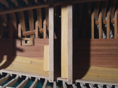

Galley and eating area: I could not move on to another area of the ship before doing at least a table/bench. The only missing components are the mats and the ladder, which will be added later. Time to move to the cargo area.
Linseed Oil - Side note: We often WANT to highlight the definition or seam between planks, either for esthetic purposes or to simulate caulking. If you look at the last picture above, you will see two methods:
a) caulking on the ceiling planks was done using a method very often described here: by adding a little carbon to the side of the plank using pencil #2. You will note the very slight "greyish" coloration and not quite uniform (intensity wise).
b) the second method was use for the table (and the wall panel in the back): I just discovered it completely by accident. I guess this is how you gain knowledge. With the table I did NOTHING. The planks are simply hold together by a cross-plank underneath. How does doing nothing still outlined the junction between planks so neatly? The secret is simply by using linseed oil. Linseed oil stain grains and side-cuts darker, thus creating a nice hairline effect of darker color, uniform and not greyish at all. I don't know if you are like me... I like it a lot!

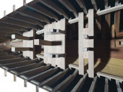

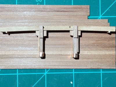

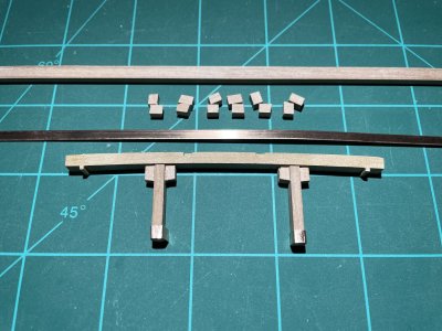

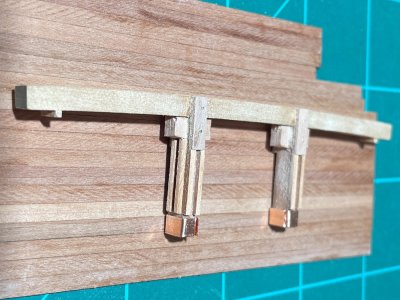

Prototype Cargo support beam: Time to move to the cargo area. After some consideration, I decided to keep this area quite open with only few sub-divisions. However, the support beams should all be in place, which will allow for customization by the crew. I will set the spacing to between 30 or 40 mm apart, which translate to 7-8 feet at scale. Support beams were likely crude and frequently change as they get damaged and/or rot set in - this was likely a messy area. So, I try not to work the parts to perfection, so they appear a little crude
Lastly, I will be using copper bands at the base. This is relatively thick copper (not the tape) formed using small plier. The idea is that it should help with maintenance, strengthen the base and limit rotting. However, I have to reveal a little secret (just between you and me - don't tell anyone): The copper band at the base will act as a sleeve, i.e. not glue to the beam. That way they can slide down to hide any tiny gap with the deck underneath. This way I won't have to drill thru the deck but just leave the beam sit on it.
On a side note: the upper deck beams are cut a tad short. They keep falling during test fit, which annoy me. To help I glued small "stopper" underneath. The picture below is a test fit; nothing really glue together.

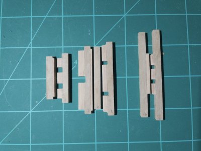

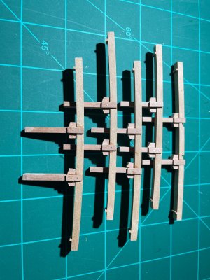

Ice hold corner Beams: The first set of support beams takes the longest to do, since the design is never set and final until a first is done. I'm pleased with it so far. Those will be the corner beams of those ice hold. This means more walls to do.

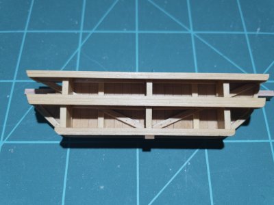

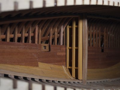

Ice Hold: It is amazing how a design you have in your head just does not hold well when implemented. I went thru several variation of the design until I finally was happy. Trial and error, the best teacher. Here few different views. Not quite final.... this is a dry fit without sanding/finish.
Once you have a nice workaround, the fitting of the compartments is lining up very nicely, Loracs.
hello Peter, this was indeed the difficulties... the reason for the tried and error design. Previous iterations were either too bulky, broke easily or just a real pain to execute. Relying primarily on the two beams turn out to be the best solution. Those two are supported on top on all sides and drilled thru (2-3 mm) with metal pins. They are not going anywhere. The time-consuming aspect was to get the boards at just the right length. Finally, I did want to leave a space at the bottom for the melt water to go thru.

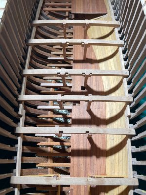

Cargo area: I opted in keeping this area fairly open, installing only deck support beams. They can double as anchor points to either create temporary compartment or only as way to tie cargo. If you are curious I choose the following frame for the support beams: 21, 25, 28, 31, 35, 38. Still at the dry fit stage until I figure out potentially installing lights.
