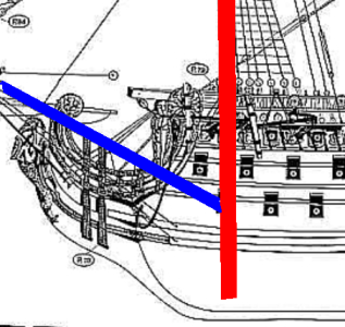

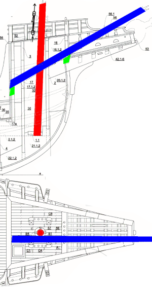

But I wonder now why everyone says bowsprits in France were deported to the right in the 1700, when I see the drawings of Colbert?
As far as I know, the only ships that had the bowsprit offset to one side are those that have insufficient length between the front support of the bowsprit and the foremast to mount the bowsprit step and give the bowsprit sufficient support. The above drawings clearly show the bowsprit ends just before the foremast, so no offset is necessary. If the bowsprit continued past the foremast, then it would clearly have to be offset. This does not just apply to French ships, but many other nationalities, like my Ragusian Carrack. The plans for the Carrack show the very short distance between the front of the forecastle and the foremast, necessitating running the bowsprit aft alongside the foremast to the rear of the forecastle:
Green shows the support for the bowsprit.
This photo shows the bowsprit entering the forecastle offset from center:
While the Carrack drawings showed the bowsprit parallel with the ship centerline, my research showed they usually were mounted at an angle so that the end of the bowsprit was at or near the ship centerline. You can kind of see that in this photo:
Anyhow, it's my opinion that you can pretty much look at the bowsprit, foremast and forecastle and see if an offset bowsprit would have been necessary.
I don't have a good pic of Soleil plans, but the ones I'm seeing show the distance between the front of the forecastle to the foremast fairly close:
so IMHO there's a decent chance it should be offset. But I think you could make a case either way, which, I realize, doesn't help you much.

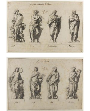

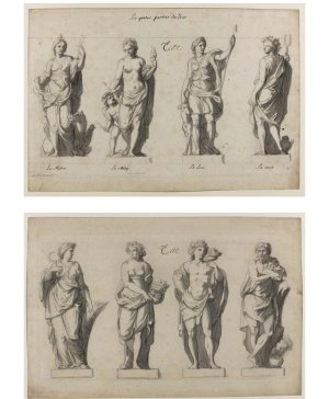

To repost a couple of Waldemar’s images:
One can better appreciate the higher quality of these reproductions, as compared with thumbnails of the same images, on-line. Obviously, they provide important structural information, and the annotations of the original Album de Colbert explain variances between artistic representation and what is understood about the actual architecture of the time.
As any sort of developed plan set for individual ships of the 1660’s/70’s did not exist, the Album remains a key resource for extrapolating correct detail into subjects previously un-explored. For his part, Waldemar is providing us with the tools to arrive at correct hull geomotry.
These plates, though, are useful for other kinds of information. The ornamental oeuvre of Jean Berain is very well understood, as there are so many preserved examples of full ornamental programs of ships from 1688, onward.
Prior to that time period, though, ornamental resources are less well understood. The things I do presently, definitely fall more firmly in the category of artistic license than technical rigor, as I am always looking to strike a compromise between what is and what should be.
However, the geometric studies Waldemar has done, along with the contemporary resources mentioned and those not mentioned, make it possible to reconstruct a plausible hull form. For example, Tony DeVroude is quite successfully reconstructing the Dauphin Royal of 1668:
If I can design a plausible hull form, I can use what is known about the early ornamental program of Soleil Royal, and the Royal Louis, along with the drawings of Puget:

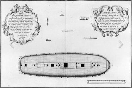

In contrast, the description by François Coulomb in his 1683 manuscript is far more comprehensive and informative:
Le Mast de Beaupré sera placé audessus du premier pont. Il sappuye sur le mast davant et est soustenu par une guirlande à fin quil ne porte point sur le bout de l’Estrave […]” (original spelling) — “The Bowsprit will be placed above the first deck. It rests against the foremast and is supported by a breasthook so that it does not bear down on the tip of the stem post”.
By deduction, this must refer to a layout in which the bowsprit is above the stem post, rather than alongside it.

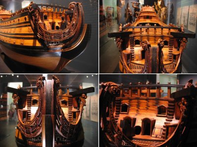

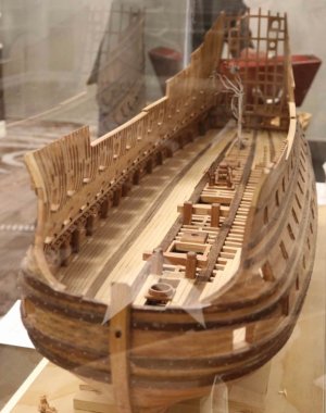

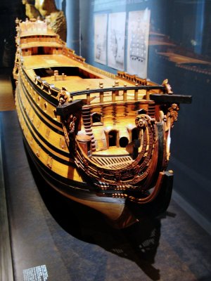

Hallo! I found this photo of the bow of the Soleil Royal on Wikimedia; it seems to me that the bowsprit is centred when you look at its position in relation to the railingsabove it.
However, there is no guarantee that the model is accurate, as it dates from 1839 (170 years after the SR was built)...
Hi; yes; it is the model from Tanneron made in apprx 1832; the bow especially would represent something closer to the 1692 Soleil Royal, having more common features with what was done at that period; it also probably was the closest information which Tanneron had to base his model structure on, the early ship's information has never been found, either because it burned in a huge fire in Brest at around 1675, or simply has never been actually archived, the master shipbuilders of the days not being keen or educated enough to make specific drawings and instead relying on their own experience and transmitting the knowledge to their son(s).....

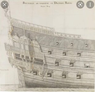

Oh, you must have seen them, since you even left your signature next to them:

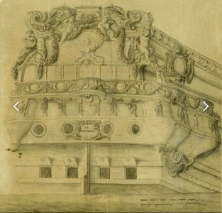

One can add other plates from the same album to those as well. The upper one, in particular, nicely illustrates a certain structural feature that was explicitly mentioned in the 1683 Toulon manuscript.
Is that the bow or the stern? I think someone is pulling your leg about the off set bowsprit. I have never see n anything like that.
The first pic is a side view from a ship plan in the Admiral de Paris book part 3 if I remember....The second pc is the stern of a ship apparently drwn by Colbert, and found in his monography, a quite old book... As for a bowsprit offset, you have a very good example a little higher in this log showing the bow of a carrack.....
Ahhh Ha! I spoke too soon. Honestly I have never even heard of such a thing untill today. I am completely fubblemumblled by what I see here. However they do say that the tip of the bowsprit does come back to the ships centerline at the outboard end. That is odd construction.

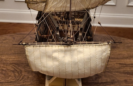

A Golden Hind build here on SoS clearly shows and discusses the offset spritsail, and it's mentioned that it should be angled to the center at the tip.

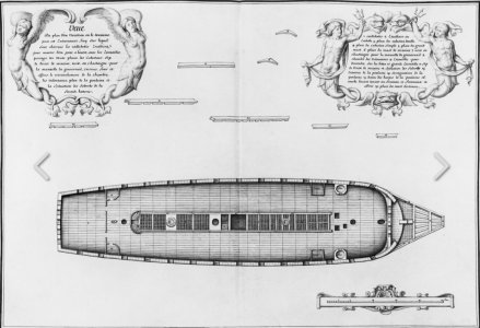

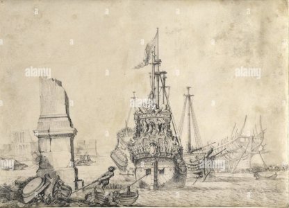

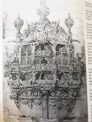

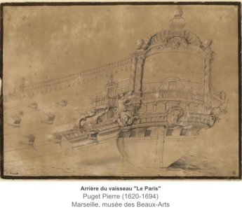

Actually, this isn’t a plate from admiral Pâris’s late 19th-century publication, but one of the plates from the so-called Album de Colbert from the late 17th century. Incidentally, the two-century gap means that any of the admiral’s reconstructions are not even formally suitable as a reliable source.

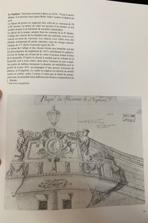

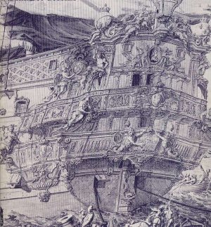

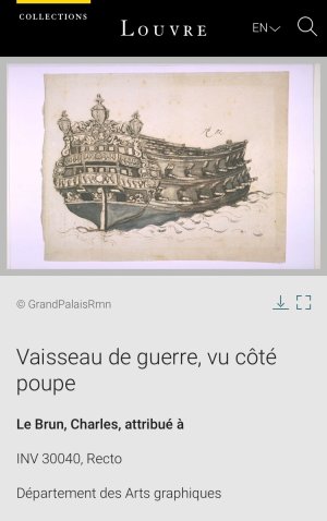

The so-called Colbert Album is a collection of illustrations depicting a large warship under construction, none of which were drawn by Colbert, the Minister of the Treasury and Navy, himself. This particular plate depicts a view from the bow rather than the stern, which is, in fact, confirmed by the clearly legible caption on this very plate: “Veue de la Proue d'un Vaisseau a l'ancre [...]” (“View of the Bow of a Ship at anchor [...]”).
