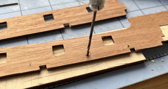

I wanted to add some scuppers to the main deck so I marked where I wanted them and drilled them. Not many (4 on each side) and not too big.
So the 3 sections towards the stern are complete with the 4 from bow to the midship still to be completed. My time in Mexico is waning so I need to use it efficiently to get to a point that I feel comfortable leaving the Molino alone in a closet for around 6 months.
