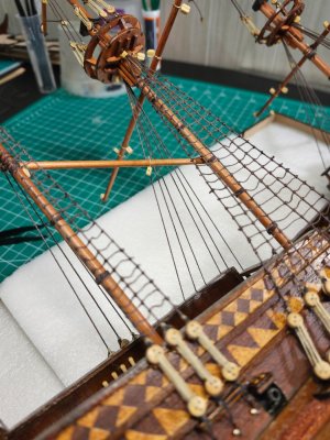

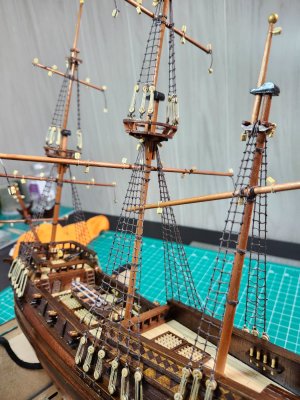

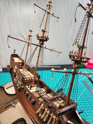

After three and a half days of tying shrouds and ratlines, I had to take a break. Especially since I can see that it will be many more days of tying ratlines.

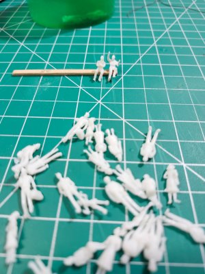

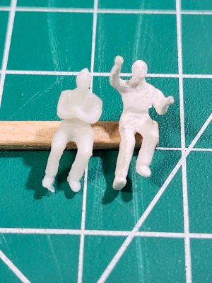

Turned a park bench sitting person into a pirate climbing the ratlines. Below photo normal size and second photo is 3x magnification.
He is still a little rough but I need to let the glue dry before I work on him some more. Yes, their bench is 3.5 mm wide. Found these architectural figures that are 1:100 scale to match the Buccaneer. Think it was about $9 for a hundred of them. Going to change about four more to add to the ship to give some perspective.
Here he is climbing the ratlines. First time I have ever done a modification like this one. I am happy with the result! Hopefully I will be able to paint some details on him and still be happy. If not, he may turn up as only a silhouette.

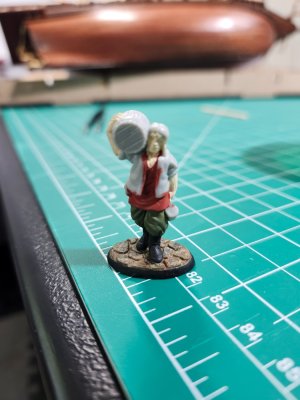

Also started to paint a 1:48 figure who will help to celebrate once the Buccaneer is done.
So I guess that is enough procrastination, back to the ratlines.
View attachment 516246View attachment 516248
Good morning. Your ratlines came out very well. It will be a different look to have the crew clambering all over- nice. Cheers Grant

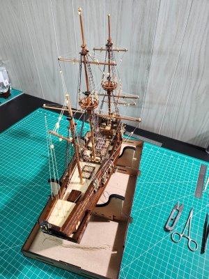

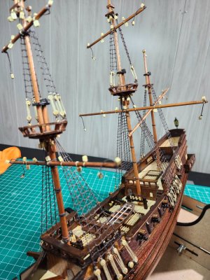

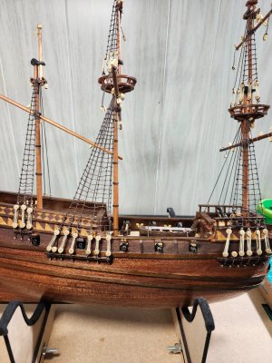

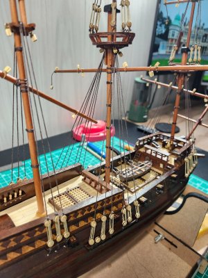

Haven't updated in a few days because I'm still tying ratlines. Almost finished with the Starboard side and hope to finish all the ratlines by the end of this weekend. I have gotten into a rhythm and now it seems to go a little bit quicker. Didn't think I would ever be tying hundreds of clove hitches with tweezers when I learned that knot as a Boy Scout. ROTFROTFROTF Also have spent time searching and studying the Santisima Trinidad so I can be ready to start the cross-section as soon as I finish the Buccaneer.

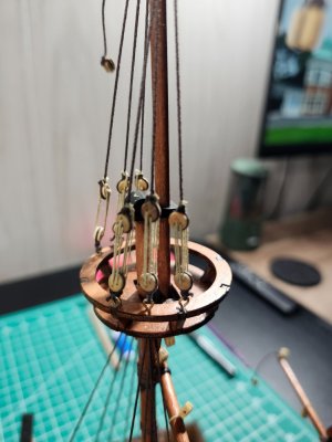

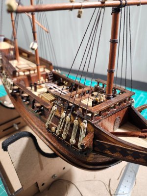

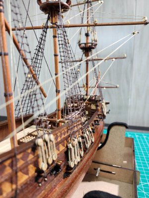

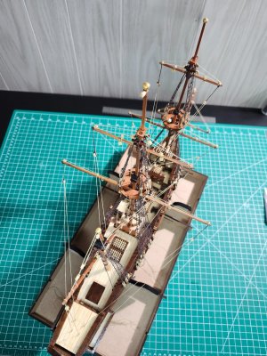

It looks like there are some extra deadeyes on the channels. What do those go to?
Rebus, that’s great work. I love your addition of the little figures.
It looks like there are some extra deadeyes on the channels. What do those got to?
Thanks for the kind words.
The extra deadeyes are for stays that run to the top of the masts. They will be installed once I finish the ratlines.
