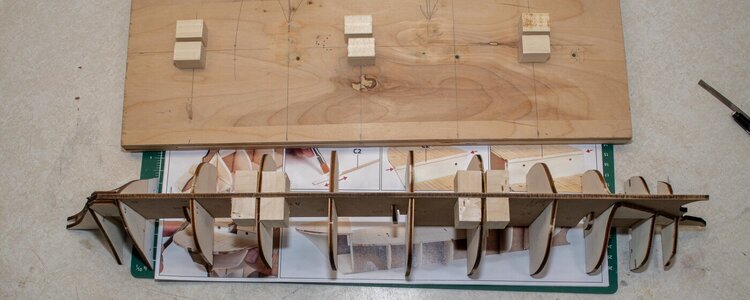

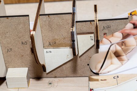

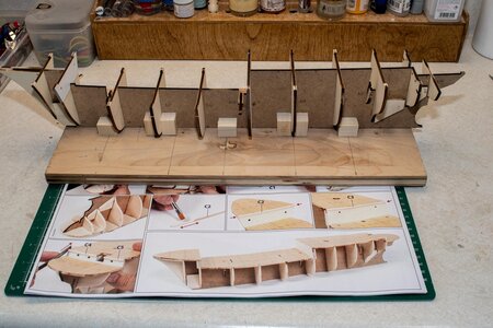

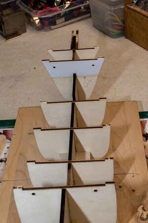

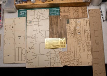

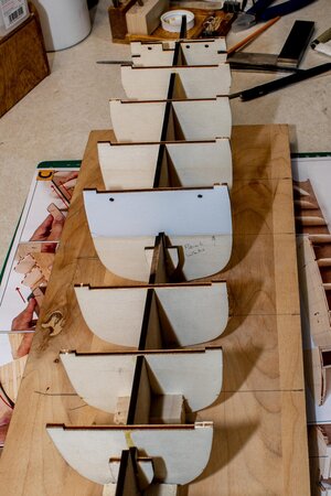

My son is a big fan of the Shackelton expedition and he wanted a model of Endurance so that will be my next build. This is my first OcCre kit and so far i'm impressed. All the frame pieces fit well and only a little adjustment was needed. I applied sanding sealer, then sanded, and airbrushed the A3, A7, A11 frames white were indicated on the plans. I also added blocks around the frames that will receive the screws for the pedestal mounts and drilled the holes while it is easy to get the frame in the drill press.

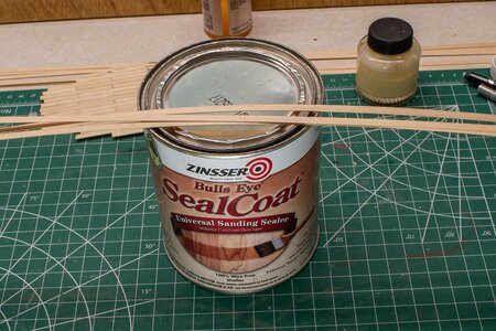

I did half a dozen sample deck planking mockups and finally got one I like. This is my process.
First I give each plank a coat of sanding sealer (Alcohol based Shellack). Very fast dry time.

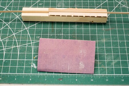

After that dries I sand the flats and the edges with 320 grit. I made a small jig for the edges as the planks are only .5mm.

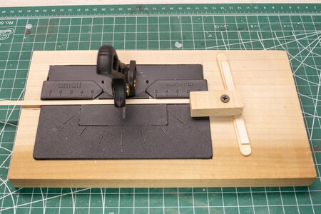

I set up another jig and cut each plank to size. 6mm in this case.

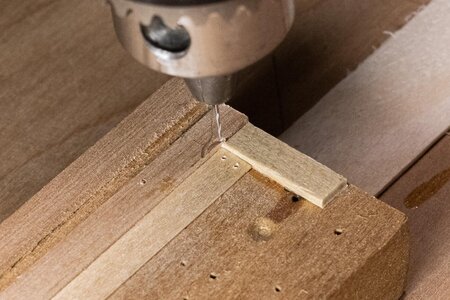

Jig #3 is setup with a very small bit in my drill press and I drill treenail hole number one, flip the plank and drill hole 2. Then turn the plank around and repeat for the other end. It takes a while but it's the only way I can get equally spaced holes.

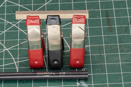

Clamp a bundle of planks together and darken the edges with a # 6B pencil. I used to use a felt tip marker but the ink bled into wood way to much which is why I now seal the wood before I do the edges. Also wipe the lead dust off before you release the bundle. Keeps the planks from getting smudged during handling. You don't need much lead.

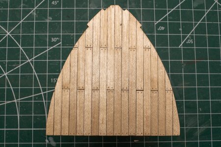

Glue the planks down with what ever pattern you choose.

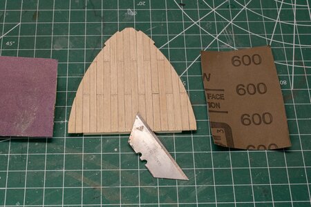

Trim the edges and sand. This is the first time I have tried scraping the planks down with a blade. It gets rid of the excess glue and stains from the pencil lead. A quick sand with 320 grit followed by a pass with 600 grit. Ready to paint.
