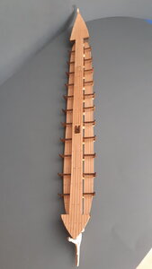

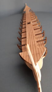

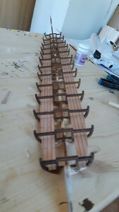

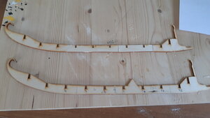

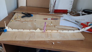

For the reconstruction project, of building Odysseus ship, I got two model ship kits from Dusek, that is the Greek bireme, in order to use/merge their elements and to by pass trivial work, which is supplied by the kits.
