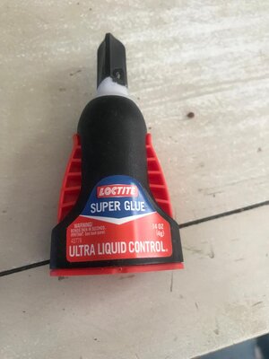

I use the below photo, which is a CA super glue(cyanoacylate). Thank you

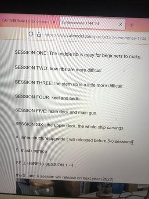

Lain, more "sections" after this Gun Deck, and Upper Deck/Figures. Tom at CAF is currently working on a Mast section as well. i included the CAF description below. It is a GREAT kit! Good Luck

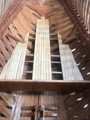

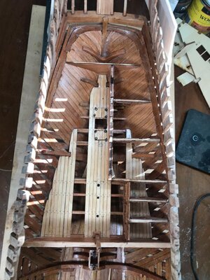

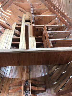

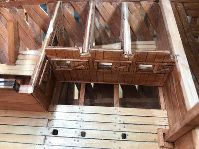

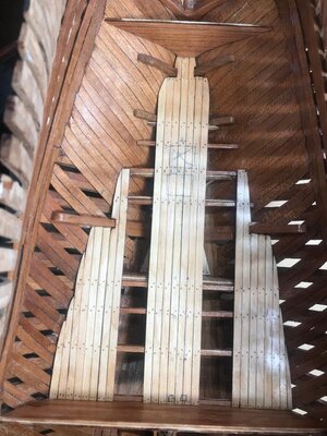

added the hold accommodation walls on Port side today. Note here for future builders, CAF only includes material to do the port side, I am assuming thats to leave the Starboard side open to see through to the lower hold. Just realized on my pictures, my second to last wall going to stern needs to angle down more.

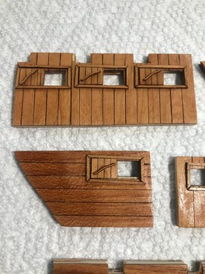

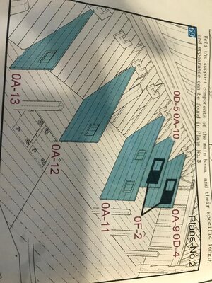

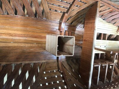

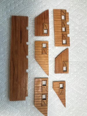

HUGE MISTAKE made on my part. Folks, in revisiting the instructions, plans, and CAF pictures on Toms site, I realized I have built the walls for the hold accommodations incorrectly(parts have been reordered). The instructions are a bit confusing and I didnt due diligence. I thought that the wall planking was 2 sided and glued to the forms. This is incorrect. There should be a full set of planked walls in the hold, the forms provided are only to make the plank walls to the correct size, and then the form is discarded. You can see where my thikness of the walls to TOO thick, because I included the form. Back to the drawing board.
Does it matter? Will these walls be fully covered by a beam?
Do I understand that the walls should be without this core/template inside ?
yes, that i my new understanding. When I looked how the Water Pump House was built it became more clear to me. You can see in the photo the Pump House, this had a form as well, but CAF only included, 2 forms, 1 side and 1 back. So the deduction as the house is 4 sided, that the cores are just to build the walls to that measurement
