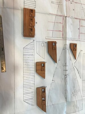

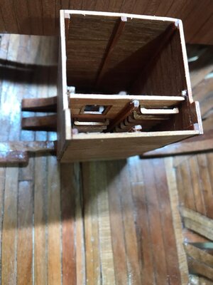

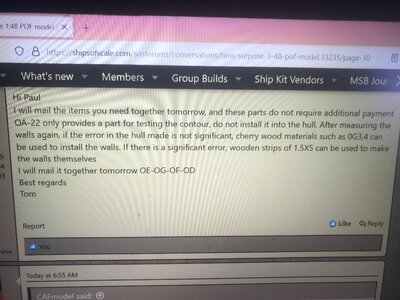

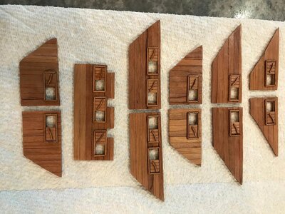

Attached is Tom from CAF's response on how to build the walls. I think just the overlay is too thin, so Im going to try a few with the 1.5x5 strips as the inside portion and the overlay facing out to give the overlay some stability

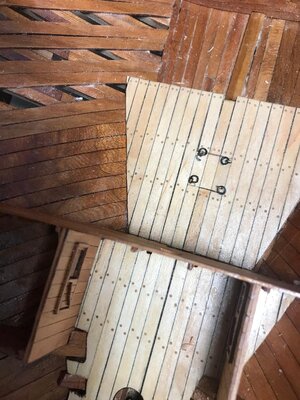

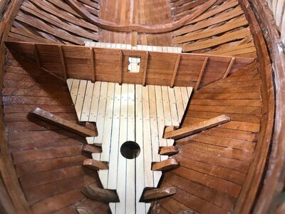

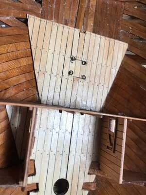

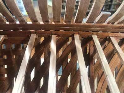

Looking very good - I know how much work are thes small floors, platforms, walls for the interior.....

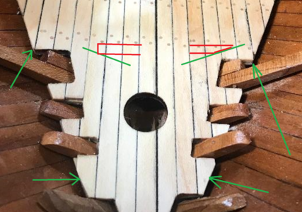

A small hint, which is maybe working - we can see that between the edge of the floor elements have a small gap towards the inner planking (green arrows)
When you sand the lower part of the floor to get appr. the form of the inner planking (green line) the visible gap will be reduced
I hope this small sketch is making my words understandable -
on the left side - how it is now
on the right side - floor is more flat to the inner planking

Grant your skill level is far superior to mine! I wouldnt worry about your skill level. The CAF kit is extremely well designed, the instructions can definitely be challenging to understand though.
Got it, thanks Uwe!

Here is Toms response on sessions 5 and 6
I am currently working on the content of the fifth section, and I am currently laying the deck. It is expected that the testing will be completed by December, and then I can start writing instructions and production. It is expected that the fifth section will be sold as soon as the end of December to early January
It is expected that this ship will be completed from April to May next year.

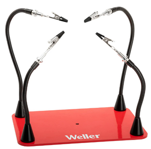

Uwe, I have these barrels....what did you use to hold the rings together while you soldered them?
I think I used the "four hands" - do not ask me the correct english term
I have something like this and used 2 of the clamps
Thankyou, I'll need to get one, mine only has 2 hands, not 4. Uwe, this my first attempt soldering, it dosent seem to be adhering to the brass well, any hints on good soldering technique? Thankyou, Paul
But with two of them it can also work - the two ends of the ring have to get in contact and should stay there - that is enough

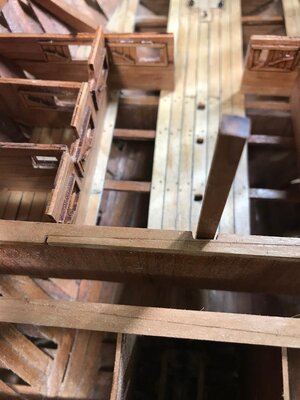

Beautifully executed Paul, really nice joinery on her, the kit design only takes that so far, your meticulous nature takes it from there! Merry Christmas! Always enjoy your posts!
