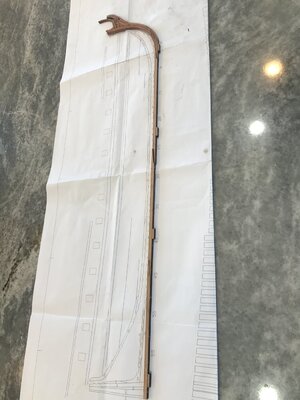

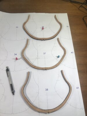

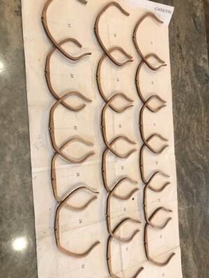

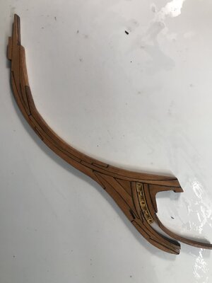

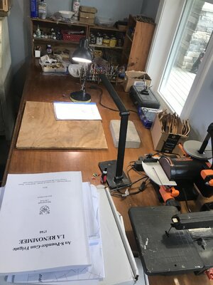

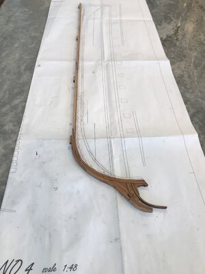

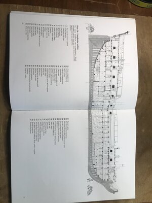

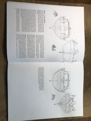

Some updates, Stem 90% complete, missing 1 piece in front of the decoration, then a bit more sanding, Dry Fit the Stem and the Keel pieces, completed Frames 15 thru 31 16 complete, 42 to go. Also ordered and recieved my copy of Boudriot's La Renommee from ANCRE in France. Lots of great Plates, with detailed interior construction. Will be interesting to match up to CAF interior, although this was probably the Text for the Kit. Threw in a shot of my workspace for the heck of it!

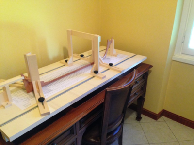

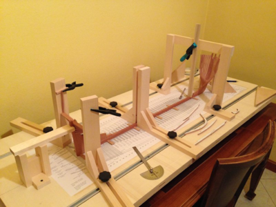

Paul, I have not used this setup but I think this gantry system as outlined in Ed Tosti’s book the Naiad is pretty slick. You utilize various 90 degree fixtures and align them at any angle on the framing plan and they align the frames so you can get them perfect?4196F5B7-1CC1-41E8-A83E-A9A75F3C9387.png
