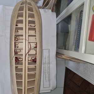

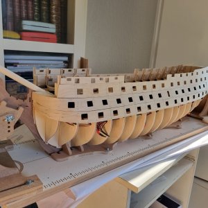

Hello all
I have unmounted all the parts (bulkheads, deck, dummy barrel strips) that I had previously dry-fitted and have first glued all bulkheads.
I then installed the lower dummy barrel strip and inserted the LEDs on the left side of each gun port. I used 3mm 12V warm white LEDs that I have installed in parallel. I took particular care when soldering the connections since they will not be accessible moving forward.
Some pictures below.
Below picture with the gunports pattern pinned and with lights on .
Next I am going to intall the lower gunport lights on the port side and install the middle gun deck.
Cheers

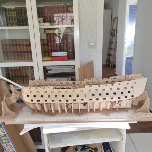

Hello friends
I have finished adding LED light for the two cannon decks and have also added LEDs to the middle gun decks so that light can be seen thru the various openings from the upper decks (gratings, stairs).
Pictures with lights on:
I have not yet added lights for the officer's quarter but wires are ready at the stern.
Let me now move back to the instructions and continue on the hull
Cheers

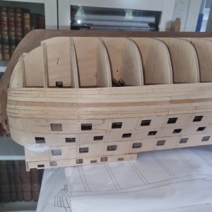

Hello all
I have added the 3 gunport patterns on both sides of the hull.
One element worth mentioning is the fact that these patterns are quite large and care has to be taken in order to precisely glue the top and bottom parts for each bulkhead. A pin at the top and one at the bottom is absolutely necessary.
I have also created a balsa filler block at the bow. The Jotika documentation does not mention that but I believe this is needed in order to insure smooth planking.
I believe I can now start first layer planking ...

Good afternoon Gilbert. At 1;72 this must be a big model. I know how large my 1:78 is. I like the way Caldercraft has built the gunport patterns. So many Victory kits got these wrong, even my Mantua, so this is cool. Cheers Grant
Hello Gilbert
It may be the photo but the lower, middle and upper decks' gun ports all look to be the same size rather than different at each deck level. Are they the same or different for each deck?
From The Elements and Practice of Naval Architecture or a first rate.
Gun deck 2'9" up and down X 3'5" (11.6mmX14.5mm)
Middle deck 2' 9" X 3' 3"
Upper deck 2;9"" X 3' 0"
Just curious about this.

Hi Allan
THanks for your input
The gun ports are not exactly the same size.
Lower deck: 16.6mm x 14.3mm
Middle deck: 16mm x 13.6mm
Upper deck: 15.9mm x 13.7mm
In addition, looking very closely with a caliper, it looks like the gun ports on each deck are not 100% of the same size (0.1mm difference)

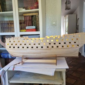

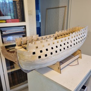

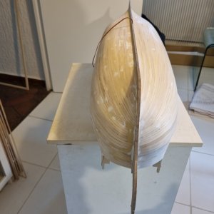

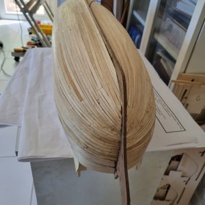

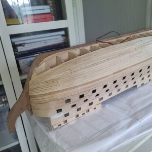

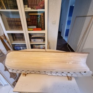

Hello all
I have not posted any update on my progress since a few weeks as I have been rather slow working on the HMS Victory hull. Other priorities have come and I spent much less time in the shipyard.
Anyway, I have now just completed and sanded the hull.
See pictures below
Again, progress will be slow in the coming weeks as I am flying to the US later this week to meet my grand daughter who was born last week. This is definitely higher priority than ship building :p
Cheers
