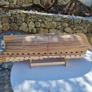

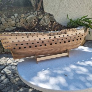

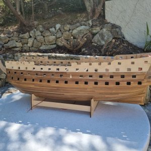

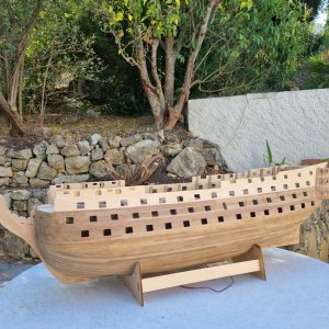

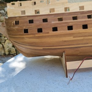

After a couple of weeks of work, I am making steady progress on the hull second planking..
I believe I am approximately half way thru.
Caldercraft documentation recommends to use medium CA to glue the walnut planks. I did not like that approach too much as it tends to leave dark spots on the planks. I used wood white glue instead (Weld bond glue).
Below some pictures of the hull as it stands today.
View attachment 532097View attachment 532098View attachment 532099View attachment 532100
Some thourough sanding is needed but I'll work on that a bit later.
In parallel I have adjusted the height and width of the cannon ports in order to match with the Caldercraft plan. Still some work to be done here but I'll be completing this at the same time as I complete the second planking.
