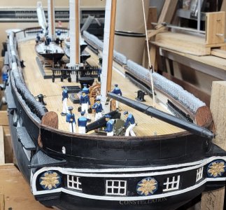

All the crew are painted, at least till I print more ;)
I think I found a good shade of brown for my Black crewman; all these fellas should look like they've been out in the sun for a while, even him.
There's some little things to touch-up, but they're pretty much done.
Ivan got a new shirt/jumper; does it make him look fat?
