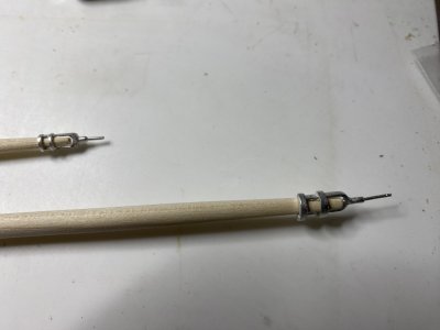

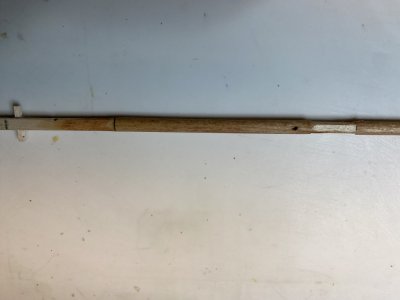

I built the topgallant mast using the dimensions on the plans. I used 3/16" square and dowel. The were attached together using a pin the same way the topmast was constructed. The topgallant mast dowel has to be significantly tapered. This required a lot of work using a 100 grit sanding stick followed by using a buffing pad to smooth it. I made sure the topgallant mast cap could fit into position after the sanding.

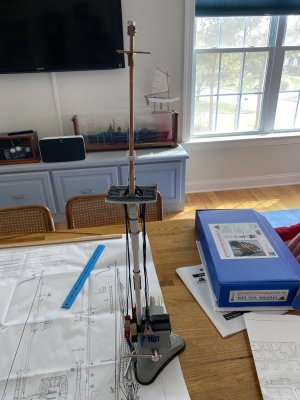

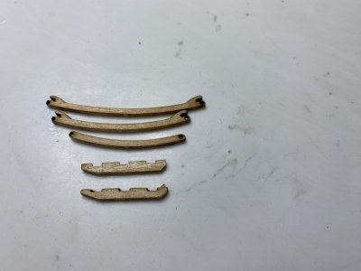

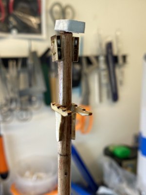

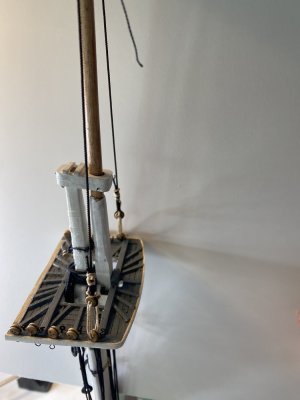

While waiting for the epoxy to dry I cleaned up the char from the topmast crosstrees and trestle trees. As advised by the instructions I applied CA to the edges of these as well as the cheeks and the boxes for the topmast sheaves to strengthen the thin wood.

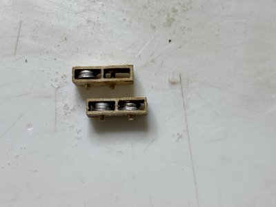

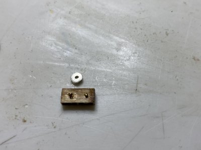

There are 2 cheek blocks with sheaves that go on the top of the top of the topmast. Others have mentioned that they do not seem to exist on the Constitution and no lines are rigged on them on the model but I figured I would put them in also. There were also only 3 sheaves of the correct size provided. This is consistent with what others have reported. After strengthening the boxes with CA. I put the sheaves into the boxes and drilled holes for axles. I used the supplied thin brass rod as axels. It all went together quite easily. I just left a brass rod in the place where the 4th sheave would go in case I had to thread line into it.

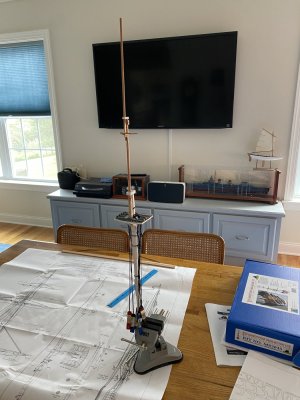

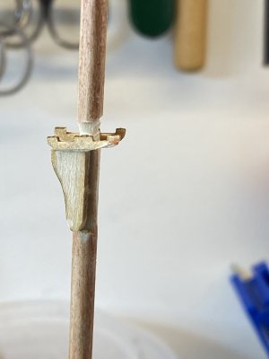

I drilled holes in the topmast and topgallant mast where the yards will be pinned to. This was suggested by Tom Culb as being much easier than doing it after the masts were assembled.
At this point I was gong to glue on the topmast cheeks and assemble the crosstrees. As I was about to do this I realized that I had to put the mast caps first before the cheeks could be placed. So at this point I stained the 2 masts with 3 coats of cherry stain and painted the mast caps. I also made sure the mast cap to the topgallant mast fit the tapered dowel.

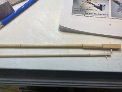

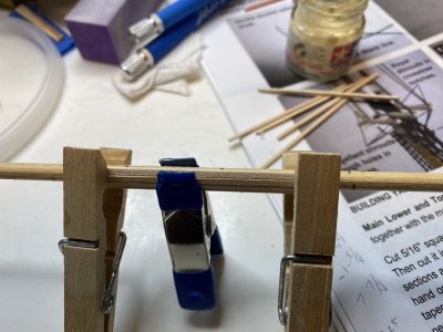

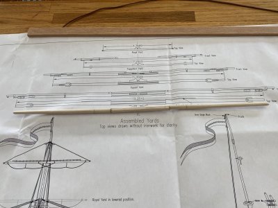

While waiting for the masts to dry, I thought I would take some time to start on the yards. Once again there are some differences between the instructions and the plans. The main and topsail; yards are to be built out of 3 pieces, a middle square piece which you are to make in into an octagon (although in a few places in the instructions it wrongly says hexagon) and two end dowels that are to be tapered. Also there are (on the plans) 1/32" battens that go onto the octagon piece that are not described at all in the instructions.
The diameter of these pieces including the battens should be 5/16" and the topsail yard should be 1/4". However the instructions say to use a 5/16" square piece and the topsail mid section should be 1/4". The instructions also says the ends of the yards should be tapered to 1/8" while the plans show a more reasonable 3/16".
So what to do? For the lower yard I am going to use 1/4" instead of 5/16" For the topsail I will use the 3/16" square. I could not find any indication of what diameter square stock to use in the instructions. (N.B. Later on I decided just to use one 3/8 " dowel instead of adding 2 dowels to a middle square piece. This, I believe worked out much easier and the yard looks great.)
The dowels and the main pieces will be attached by using a pin and epoxy cement as I did to assemble the top and topgallant masts.

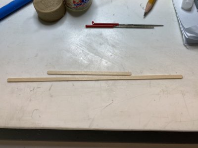

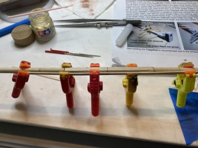

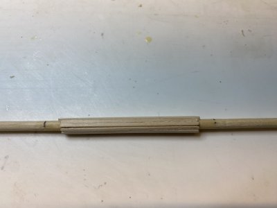

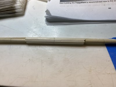

While waiting for things on the masts to dry I made some battens for the main yard using 1/8 X 1/32" strip. These strips are not included with the kit, but I had a bunch in my spares collection.
The one batten that goes against the mast is twice the length (7") of the other 7. They are then glued into place.
The last 2 battens had to be thinned along their lengths a bit to fit well. If I were to do it again, I would bevel the edges of the battens a bit, like you bevel planking. This would allow for a tighter fit. The battens were sanded down a bit to smooth them out.

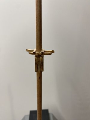

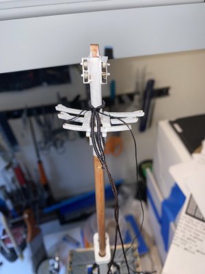

There are 2 portions of the topgallant mast that are marked, the top one 1 1/2" from the top is for a "shoulder" to be made for some shrouds. The other is said to be marked 5" below the top for where the mast is to be squared for the cheeks to be installed. Looking at the plans the 5" mark is actually right in the middle of where the cheeks are to be placed. Once again I followed the measurements of the plans. I carefully squared the area of the topgallant mast using an exacto chisel and some small files taking care to make sure they are parallel to the square area on the base of the mast.

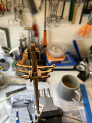

The crosstrees was built in a similar manor to the topmast crosstrees are.

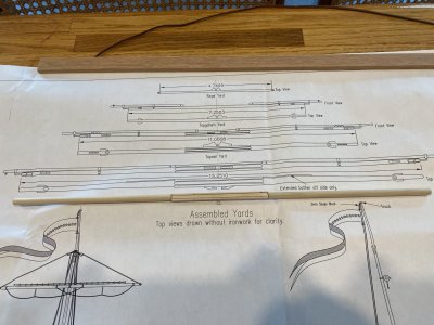

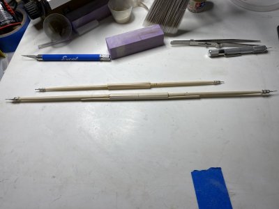

After making the main sail yard, I made the topsail yard. The instructions would have you make it the same way as the main yard, by using a square center piece and then two dowels. I used an easier method by just using a 3/8" dowel of the appropriate length (stated to be 11.0008" I just used 11" ;)) I used 1/16" strip to make battens for the middle of the yard. I beveled them a bit and they fit much closer together.
I sanded them a bit and they came out looking fairly even.
I then used a xacto chisel blade and sand paper to taper the ends. Here it is with the main yard above it.

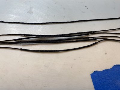

Next I prepared some shroud lines for the topmast. The instructions would have you use the same 0.040" line used for the main mast. However I thought that that looked too heavy for the topmast. I used some slightly thinner line that I had bought from ropes of scale (https://ropesofscale.com). A beautiful dark brown 0.039" (it looks a lot thinner than the 0.040" line provided). The instructions say to prepare 6, 18" shrouds. As far as I can see only 5 are needed so I made 5. (addendum: Since I have done this I find the 18" length recommended is too short. I would make each shroud line 20" to make sure you have enough line to work with,)
The middle 3" of the rope is to be served. I used my trusty serve-o-matic machine and did all 5 in about 30 minutes, The picture shows the 5 served lines with the black 0.040" rope provided on top for a comparison of how they look.

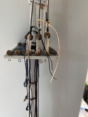

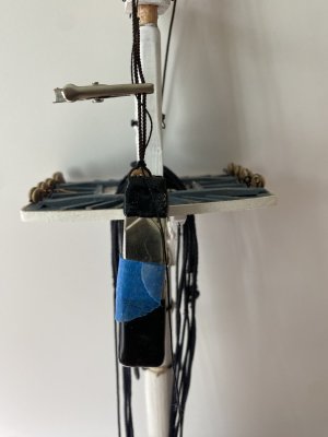

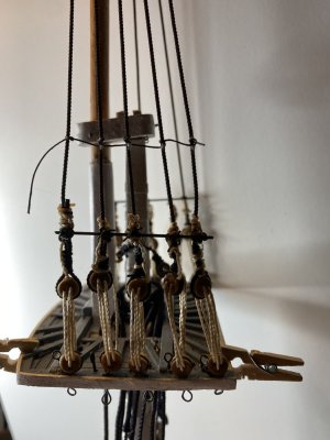

I am starting to do the shrouds for the topmast. The first set of shrouds go to the forward deadeyes on the fighting platform on the port and starboard sides. The other 4 look around to the same side wither port or starboard. To help keep the deadeye spaces even I made a few spacers out of copper wire to keep the distance constant as I seize the deadeyes. I made the spaces about 3 times the diameter of the deadeyes. (about 15mm).
They want the first forward shroud to be looped around the mast and the loop to be seized.

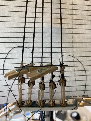

When I did this I discovered that the 18" length of the shroud that they told you to make was too short. I cut the shroud off and made one that was 22 " long. This worked out much better.
I used to spacers to set up the deadeye length. I secured the length by using a small alligator clip to hold the line before I seized them.
IMG_0973.jpeg\

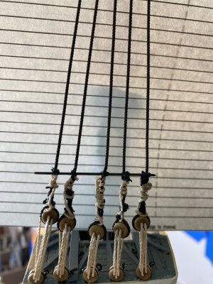

The deadeye was then seised to the shroud line using a series of half hitches.
I reeved (laced up) the deadeyes using tan running rigging lines.

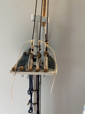

I worked on the first starboard set of shrouds. There was enough length but barely. If I were to do it again I would make the shrouds 20" long instead of 18" to have more spare line. You can see how I used the wire spacers and held the shroud line with alligator clips as I seized the shroud around the deadeyes.
I then reeved the lanyards into position. Things went a bit quicker but at this pace I figure I'll have the rigging done sometime in 2030! ;)
I seized the shroud lines and finished the lanyards. I put a small amount of thinned glue on the knots to help prevent them from unraveling.

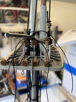

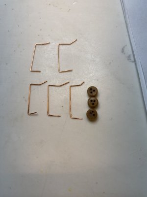

I next made some sheer poles and futtock staves from 1/32" brass rod that was darkened. I used som miniature clothespins to hold the sheer poles in place as I seized them to the shrouds. The mini clothespins are smaller and weigh significantly less than alligator clips and they did the job nicely.
The sheer poles were seized to all the shrouds and the knots painted with some glue before the excess string was cut off.

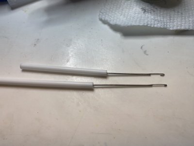

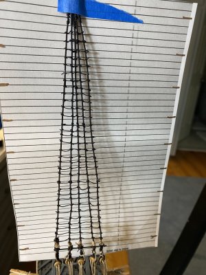

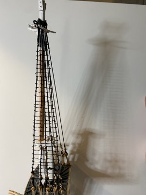

Now onto the ratlines. From my reading of others build logs, this seems by far to be the most popular thing to do. :D I made a few hooks to grab the line using large needles that I cut one side of the eye using a Dremel cutting disk and glued the needle into a small piece of plastic rod.

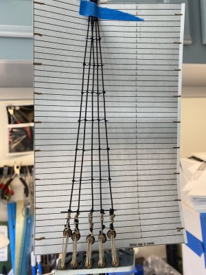

I have experimented with using clove hitches or simple overhand knots and at this scale, I think the overhand knots work better. I was not satisfied with my first attempt was using overhand knots at the beginning and end and clove hitches in the middle. The hardest part is the spacing between line, not having them too tight or too loose.

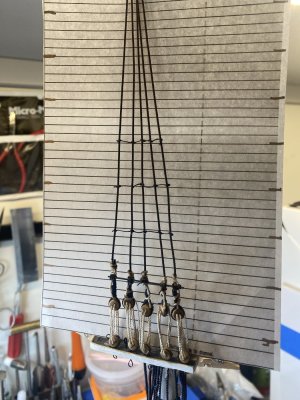

I am using the spacing guide provided on the plans. I find this very helpful. I keep the guide in place using some mini clothes pins. I have redone some of the lines and, like everything else, the more I do the better I believe it gets. I find the hooks a great help in fetching the line behind the shrouds,

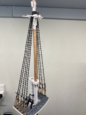

After a while I managed to get all the ratlines done on the port side. It does get easier and quicker with practice. I replaced several rows of line that I was unsatisfied with too much slack between the shrouds. I think the starboard side will go a lot quicker.

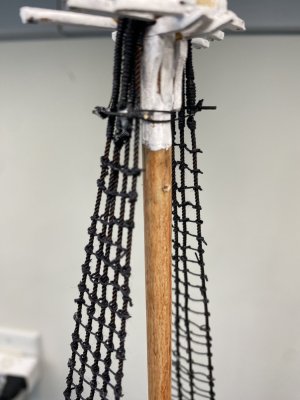

The tails of the lines were cut as closely as I dared do. A couple were cut too close and I had to replace the lines.
Things looked even better with the spacing guide taken away.
I was away for a bit, visiting my grandchildren. I worked on the Starboard ratlines. I have to say it goes much quicker with a bit of experience. I started by doing ratlines every 5th space.
The ratlines on the starboard side, the second side I did came out much better. I did not have to replace any and I likes the look.

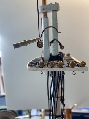

The Catharpins were attached by seizing one end of the futtock stave lines to them. I then used an alligator clip to secure the catharpin to the shrouds while I seized the other end not only around the pin but also the shroud.

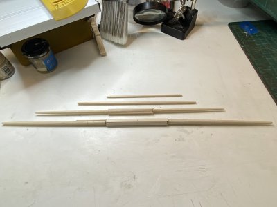

The 4 yards were shaped and tapered. They will next be stained. The royal yard reminds me of a giant toothpick.
