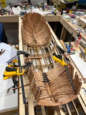

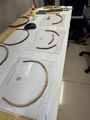

Work continues on 9, 10 and 11. Due to the shifts of the frames, I have to do a little work and then wait for the glue to cure before I can flip it over for another part or lift it off the plans to work on the other half or a new frame. :) The drawback to using PVA glue. :) I suppose I could start standing the bevels on the frame pairs I have glued together, but I'm not in a hurry. It's not a race, it's a trip to enjoy !

A little update, moving along nice and steady while the weather around here is still pretty lousy...horrible spring.
Want to get a little ahead, 16 frames to go, soon, spending a fair bit fly fishing Delaware river system....next month heading to Montana for our annual fly fishing, and hopefully a couple track sessions at Watkins Glen.
Another important tip for folks. As you hone in on shaping/sanding hawse pieces be aware of important item not really pointed out in instructions.
As it applies to biggest piece that attaches to bow, make sure you constantly match it up to bow and adjust width accordingly so it follows the pre-set path of the rabbit which should be already cut. I will likely be too big and has to be brought in to align with rabet allowing planking down the road without big issues.
Mine, down lower I was a bit too far away....no big deal but up top, I want those planks tight to my frames and still fit into the rabbit, It takes a fair bit of finessing.
Tim
P.S. notice the "spreader bars" I mentioned earlier, laying on keel. Very helpful in moving paired frames to even them when gluing in supports to top futtocks, allowing for sturdier hull.
