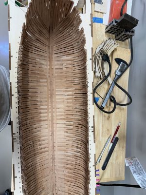

does not go all the way to the stem or stern, but comes to a point and ends on the Keelson. How did you guys determine where it starts?
Yes, the model has it butting up on the side of the keelson.Hi Jeff,
Note that the ends of the strakes butt against the keelson, not on top of it. This will likely all be out of sight in the end so maybe not such a big deal. It is not the easiest area to plank, that's for sure.

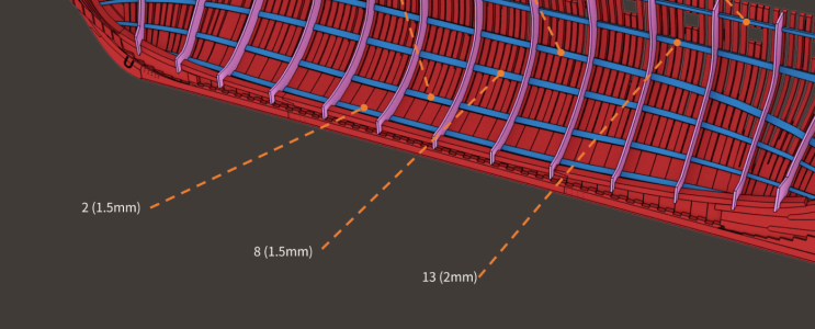

However, what was identified as "part 2" in the directions is actually 4 pieces each for a total of 8 pieces when you consider port and starboard.
Here is a pic with the "ceiling" pieces installed.
