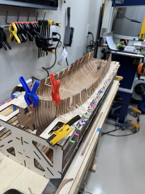

I'm now working on removing the char off of the Kelson pieces and trial fitting while the glue dries on gluing the 2 layers of the transom wing (thanks @AllanKP69). :)
Once the glue is dry, I'll sand the bevels and shape the transom wing and fit then glue it into place. I still have to do the shape sanding on the port hawse assembly as well.
