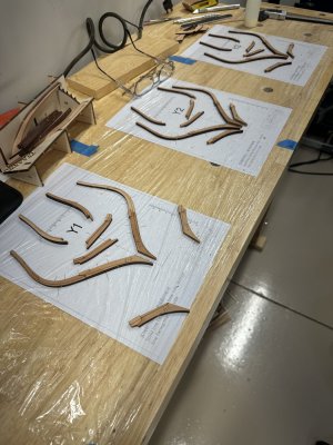

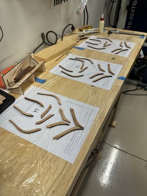

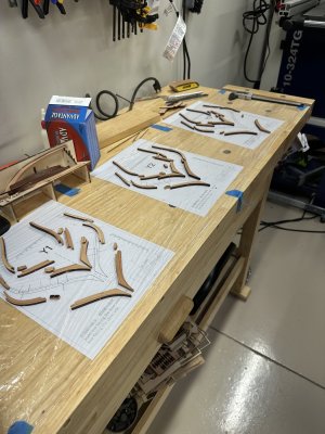

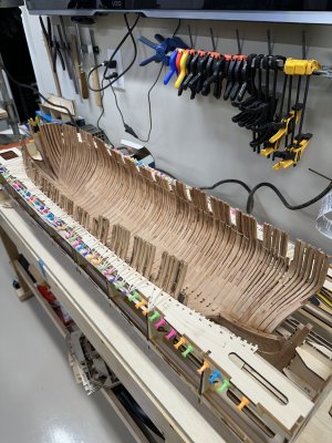

Ok, so here we go with the aft cant frames. This is for the first three.
First I collect the pieces.
Then we sand the char off the gluing areas and organize the parts:
Then we glue some of the sub-assemblies together:
Then we finish gluing up the first half of the cant frames:
I'll let those cure until tomorrow and then I'll do the other halves of these. :)

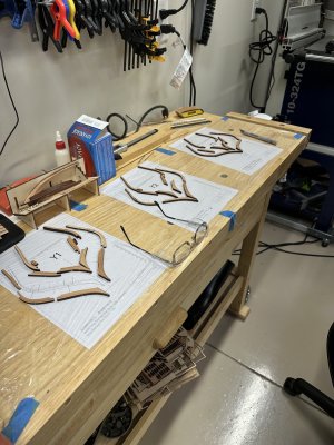

if you photocopy them you can do both Nice work
Just a hint When you do your hawse pieces
Ive very lightly tack 6 and together while i line do X8 and 1 to 5 so i can place it
Just seems to help

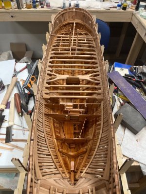

Since All you folks will make a decision on this at some point, yours to evaluate.
Since I am well past the point of no return on finish choice I am very comfortable with the beeswax/ turpentine approach, especially since it blends seamlessly as you apply in installments. Here is the latest application on surfaces below beams/carlings.
The aft sections look a bit odd because finish was just applied, still wet with reflections. When dried it all evens out.

All the aft cant frames are build. I just need to do all the sanding to shape them. I've been under the weather a little the past few days and it has impacted my desire to work on anything. But I'm starting to come out of it now and I expect I'll start sanding here very soon and get them installed ! In addition, I also have the hawse timbers to sand at the same time. It concerns me a little with all the trouble that @richardjjs has had with them. But I guess I need to get to it so I can see how it works out.

Its the inner part thats the problem they are marked But i would suggest that you just clean a and Y8a bit off the inner and keep removing the part from the Jig to ensure a clean fit between the Hawse pieces
It would all be resolved by a photo of what it should look like INSIDE after its ready to go on
