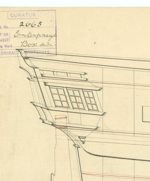

One of the mystery's of this build. Appears kit shows one wing transom. my understanding, the flat piece that fits into timbers at junction between planking tops and transom structure.
It appears the actual ship had two, the first described, if correct, and a second between lower transom planking and window frames, if one can also call it a wing, both exhibiting molding on their outer edging.
This approach is what I think I'm going with, have roughed out both from scratch as well as angled side pieces under windows ending back on hull planking.
This, primarily because the kit pieces appear not proper thickness IMHO.

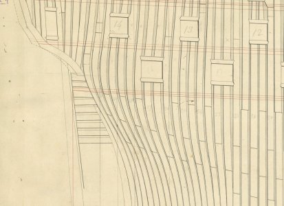

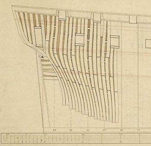

The contemporary framing plan for Enterprise 1774 show she had five transoms, including the wing transom and deck transom. The vertical filler pieces below the lowest transom are not always shown on contemporary plans according to author David Antcherl, which is the case here.

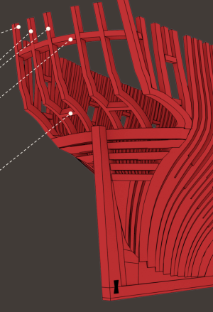

If you want to compare, here are what the kit instructions show for build.
Thanks Jeff, exactly the same! This kit is so accurate that the statement that the actual ship had only two threw me. Probably TRS and I are referring to different timbers.

What is proper term for the molded trim piece that sits proud of transom about level with door bottom? This is reference calling for two.Been a long time since transom instillation….wing or otherwise.
Sounds like it might be the counter rail. Sketch or mark up the below? Tx

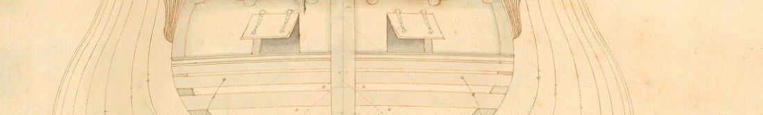

There does seem to be a lot of variation on the lay of the transoms. Looking at contemporary models and plans, transoms were sometimes flat, sometimes rounded, sometimes pointed down slightly while others pointed slightly up. For HMS Enterprise 1774 the round up of the counter and wing transom was 7.5"
