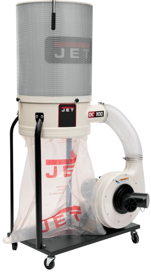

Thanks Keef. i finished up the gluing last night, including the 2 halves late last night. As far as a lot of dust, I have a oscillating spindle sander that has a monster dust collector attached to it, so that will help keep the room, the air, and my lungs clean. Don't worry, I'll still wear a filter mask. :)

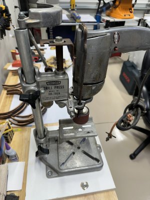

Thought you guys might get a chuckle out of my vintage drill press. It was my grandfathers back in the 60's. Yes, it's an old Craftsman drill too. still solid. :) Variable speed and you can lock the trigger at any one of 3 different speeds. I think this will work perfectly for what I need. :)
No your showing your age, or age of tools with that old beast of drill and press, you can't beat Craftsman for quality of the tools back then.
Looks like that will work. Only potential issue, some frames with considerable bevel need to be held at a pretty good angle to get correct. This is where the oscillating unit comes in handy. FWIW I use 150 grit which works great with low potential to go too far and gouge something, only takes 5 minutes to get inside/outside bevels done on paired frames, also take them down to where line is barely visible....finis up with final sanding.

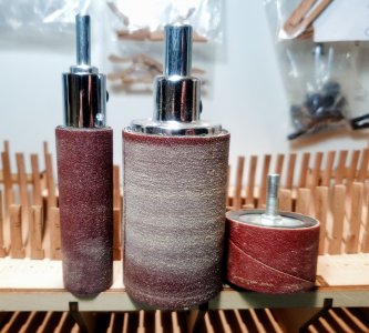

Sanding drums are heaven sent and allows you to overcome the problem of varying the bevel which is dynamic from the floor to the top timber and is not always the same inboard as outboard for some frames far aft and far forward. I love printing the frames on label paper which is then stuck to the wood. I leave the drawing on the frame pieces until the entire frame is assembled. This then shows the bevel variation along the entire length and makes it a bit easier to control. When there are only plain paper drawings of the frames can be scanned then printed on label paper or copied on plain paper and glued onto the wood with white glue or matte medium, etc.

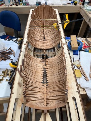

Jeff, all,
Coming down the home stretch, lots of final sanding ahead.
I should mention a mystery I discovered, probably unique to me.
As I progressed front to back I noticed a modest spacing issue as frames began to have a very slight mismatch with the top block on the keel and determined unless addressed there would ultimately result in a small gap between frames where they ultimately met.
When I started, everything measured out properly, frames seated dead on correct locations.......could not figure out what was up and with frames all glued in, no turning back.
After head scratching and colorful language my course correction was to source a thick piece of pear, measure everything and scratch build 8 new pieces that make up the first futtocks on both frames including chocks.
All told, this issue would have been, maybe 1/16" total gap.....but still.
The rest of the frames were built per instructions with upper futtocks spaced out well and everything finished up nicely, additional frames returned to perfect spacing and when viewed, unless you knew what I did, you'd never see it so we'll call it a "near miss".
Curve balls, part of the process.RedfaceRedface

Jeff, all,
Wow ! That is really coming along ! You have been hard at work ! It sounds like you got your spacing issue worked out which I'm glad to hear ! I didn't totally understand your description of what was occurring, but I did catch that you have a solution and I'm very glad for that. :)
