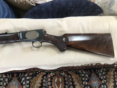

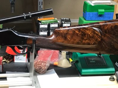

Let’s remember, in this case it’s more about protection/ preservation, Pear, for all of it’s benefits is not really a striking material.
As examples, I include a couple pieces I enhanced/ refreshed myself using now, unavailable, Arrow wood finish, but requiring multiple rubbing/polishing sessions, largely impractical for this type of project, also have used Purdy system oil finish on fine walnut….lots of elbow grease.
Thus the proven result( from some pro admiralty builds) from what I’ve seen using the wipe on poly.
Not the best photos but I think you’d agree, some examples of very fine walnut.
Admins: if posting rifle pics here violates anything , please remove. Only post them as examples of nice wood/wood finishes.
