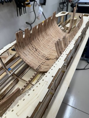

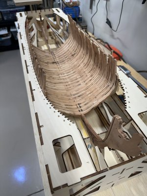

So, Paul (@dockattner ) asked for pictures, and I don't blame him. Here are a few pics of the construction jig with frames 1 through 29 resting on the keel. They are not glued yet and I have not put in any of the spacers between the frames.
I hope you enjoyed the pics. :) I still have 8 more straight frames to build, then I start on the cant frames. I've also been messing around with the hawse pieces some, trying to get a handle on how best to build them .

That is looking very good, Jeff. It’s time consuming but you have a steady pace.
