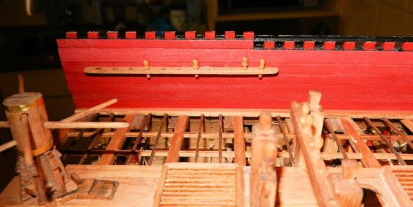

It looks rather dusty, and the eyebolts that you can see, are removed again, no way that i can attach a block for the canons to the eyebolts when they are already on the ship.

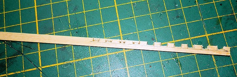

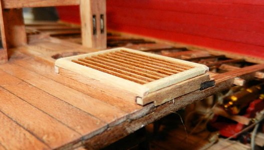

Then i went a few steps ahead of the building instructions, because i wanted to make working hinges for the porthatches, and this is what i could produce.
My nails where very out of proportion, so i glued the nails in the hatch, cut them off, and filed them smooth with the hinges.
Partly ready, it came to a sudden and complete stop overhere.

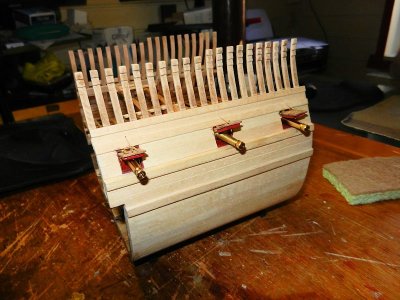

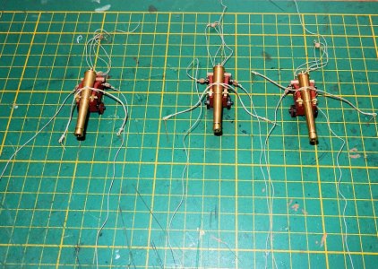

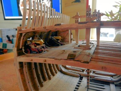

I finished the gunportlids, and after that, my attention went to the canons, on a special request of my admiral there wil be no more blackening of the brass, so the guns have to age on the model.

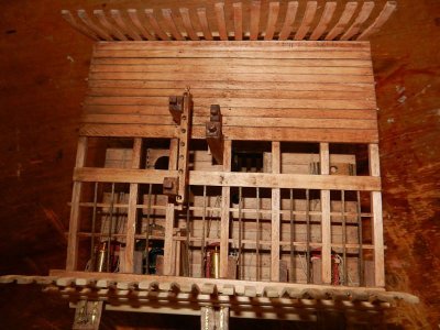

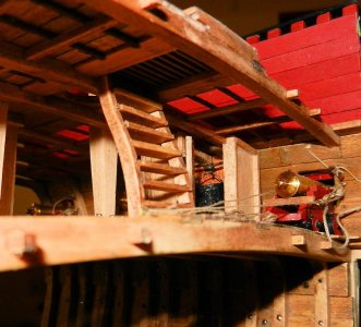

The building instruction is saying place the canons on the deck, and attach the ropes to them, but i could not achief that, so i took them of again, i took away the already placed eyebolts, and i did it all out of the crossection and on my bench, here is a picture of them.

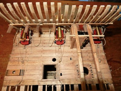

After this i placed them on the deck,
On the last picture you can also see the finished portlids
Now it was the time to place the dekbeams, the knights, after which the carlings, and the ledges came on the crossection.
( Off course i forgot to take a picture of this ), and when this was done, i planked the deck of the unplanked side of the model.

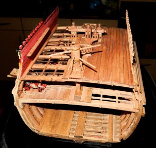

To end this update, a picture, just because it is fun to do.

Ah yes Herman, those see through pictures are always great to see.Hi Peter. Good to hear your admiral is doing better again.
You have made great progress with your build. I especially like the last see through picture. Zooming in on the deck with the canons really brings it to life.

This is wonderful news Peter. Nice work rigging those cannons, it is a fiddly job. Cheers GrantMy admiral is up and about again, and she is doing some smal jobs in the house as well
Yes Grant, wonderful news, and the cannons were a pain in the *ss.This is wonderful news Peter. Nice work rigging those cannons, it is a fiddly job. Cheers Grant
